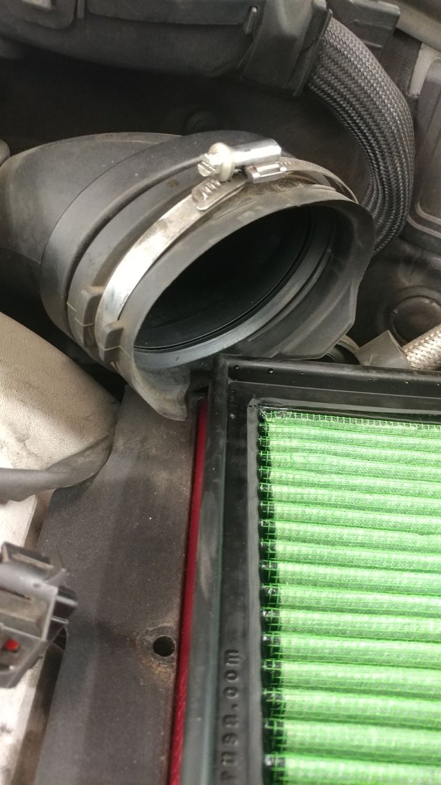

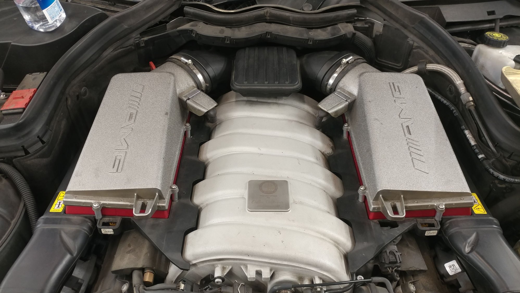

I tried to make contact with UPD, but have not gotten a response and don't want to badger anyone. I did my UPD Intake install last night and had some issues. The height of the airboxes with the spacers installed makes it impossible to install them back into the y-pipe. I tried to make it work, but looked like something was going to break so I did the next logical thing... I unclipped the y-pipe from the back of the intake manifold and continued the install. Once I had it all back together I tried to push the y-pipe back onto the intake manifold but the gap is too large to bridge even with 200lbs of force pushing down on it, and I felt again like I was about to break. I got it down as far as I could which tilts the front of the airboxes up and that was the best I could get. I started the car up and went for a drive, but within a minute or two I had lights on the dash and I was in limp mode. I pulled over, shut the car off, and restarted it. It was drive-able but had a sloppy idle. I got back home and it was late so I figured I would deal with it after work today, but when I went to start the car this morning it just stalls. I popped the hood and pushed down hard on the y-pipe again, and that stopped the stalling issue, but still goes into limp mode after a short drive. Has anyone else had this issue?

Overview
Height difference.
Trying to get the lid on without releasing the y-pipe
Installed
Dash after trying to drive with UPD Intake Kit

You have a leak. Look
at your Rpms at idle. Just take off those dumb spacers. Problem solved.

I took them off, and all is well again, the car is running great. Before I bought them I googled it and the first thing that came up was a thread with positive dyno results and 35whp. Now that I have to return them all I hear is how terrible they are. And for the record nobody has called me back or replied to me in any way from UPD, but everyone else was quick to help. The vendor ECS Tuning was prompt to help and told me these are trash and they will no longer offer these, Eurocharged told me these are trash and they no longer offer them, and the internet as a whole has giving me the riot act. This has been a disappointing experience for what was believed to be a quality product. UPD is not the company I thought they were.
