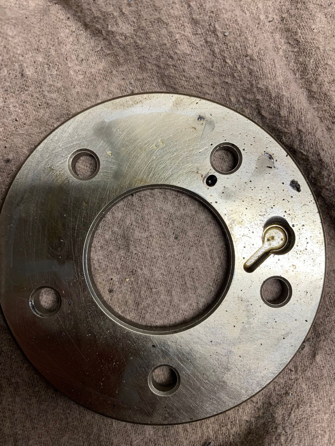

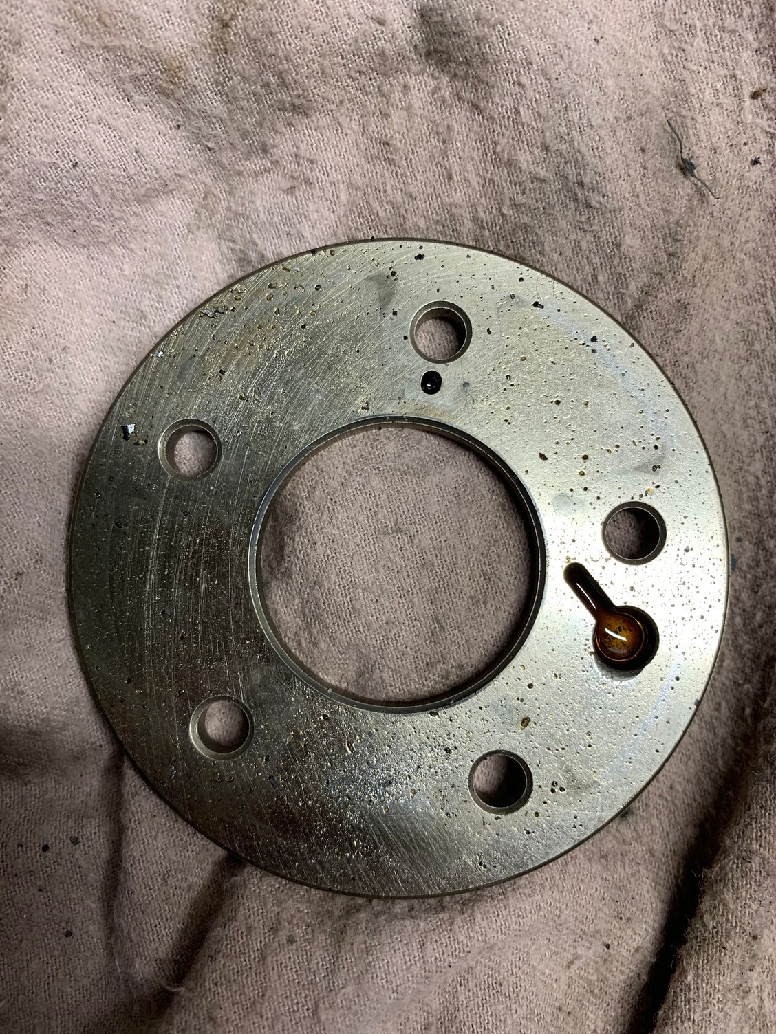

Yesterday I rebuilt all of my CA's with a plate and pin kit from 63Motorsports in Canada and am very happy.
Price was cheaper than the kit above plus they have delved deeply into the hardness values of plates verses pins to find the best medium to use in the plates.
Only time and mileage will tell but $880 for a kit (4 plates & 4 pins) is far less than $1000+ each for complete CA's from Stealerships.
OEM CA's seem to wear out at all different rates which makes you wonder about quality control considering its only the base plate that wears.
