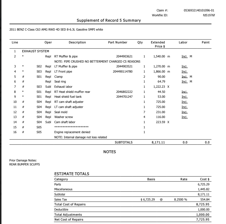

Both sides are brand new -
A rock fell out of a construction truck i was behind, and I couldn't slow down in time. Bent the exhaust up which is why you see the exhaust parts on there as well.

You have only replaced 2 out of the 4 Cam adjusters.
They most likely only replaced the inlet ones since it is the inlet camshafts and lifters that have the most wear problem.
Watch this video from the 31minute mark about Cam Adjusters.
Tasos probably knows more about the M156 than most stealership master techs.

Like Cwagon said, they only replace 2 of the 4 adjusters, so could still be an adjuster for sure, not a lot of part numbers on that work order, hopefully the washer screw line includes the diamond washers and new bolts to hold the cam adjusters on as they are single use. Also seems they didn't replace any seals for the cam covers or cam adjuster covers according to that.
Seems they are pretty light on smarts if they are saying it needs an engine cause they are too dumb to figure out a problem especially since they only replace half the cam adjusters which is one probable source of the noise.
