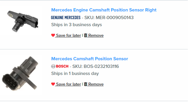

Both of these sensors have part number 0009050143 (right intake camshaft position) but they look different...any ideas which one would be correct?

Ah sorry, mixing you up with the other guy that is having exhaust cam error, exhausts are the same, intakes are different, so you are correct for intake you will need to buy one - they are not terribly priced at least. As to your question of which one to buy I would do the OEM one, bosch one looks wrong from the picture but may just be a generic picture I suspect.
Don't know about the numbers but the top pic is an exhaust sensor and both exhaust sensors are the same.
The inlet sensor (bottom pic) is different L&R.
