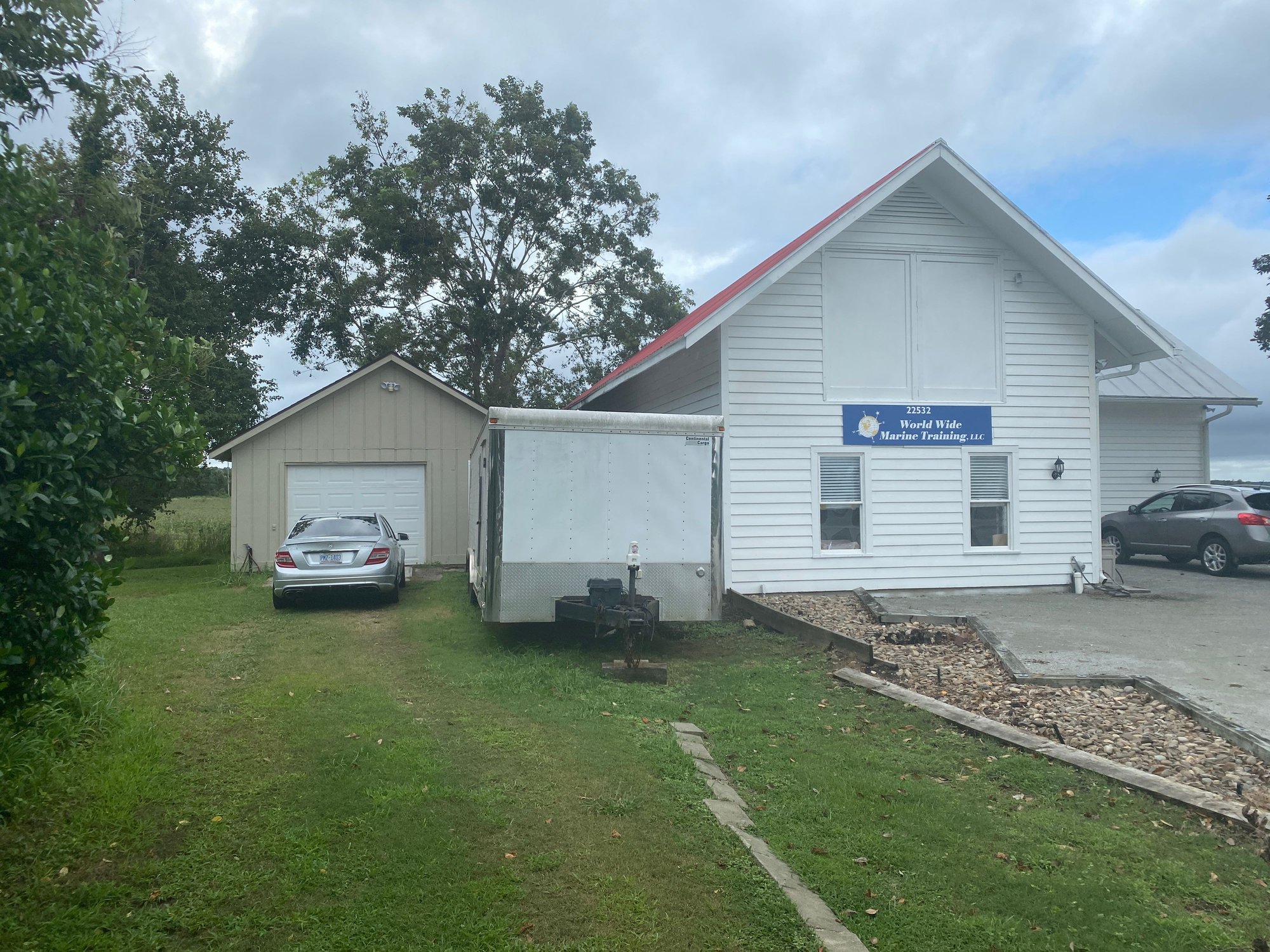

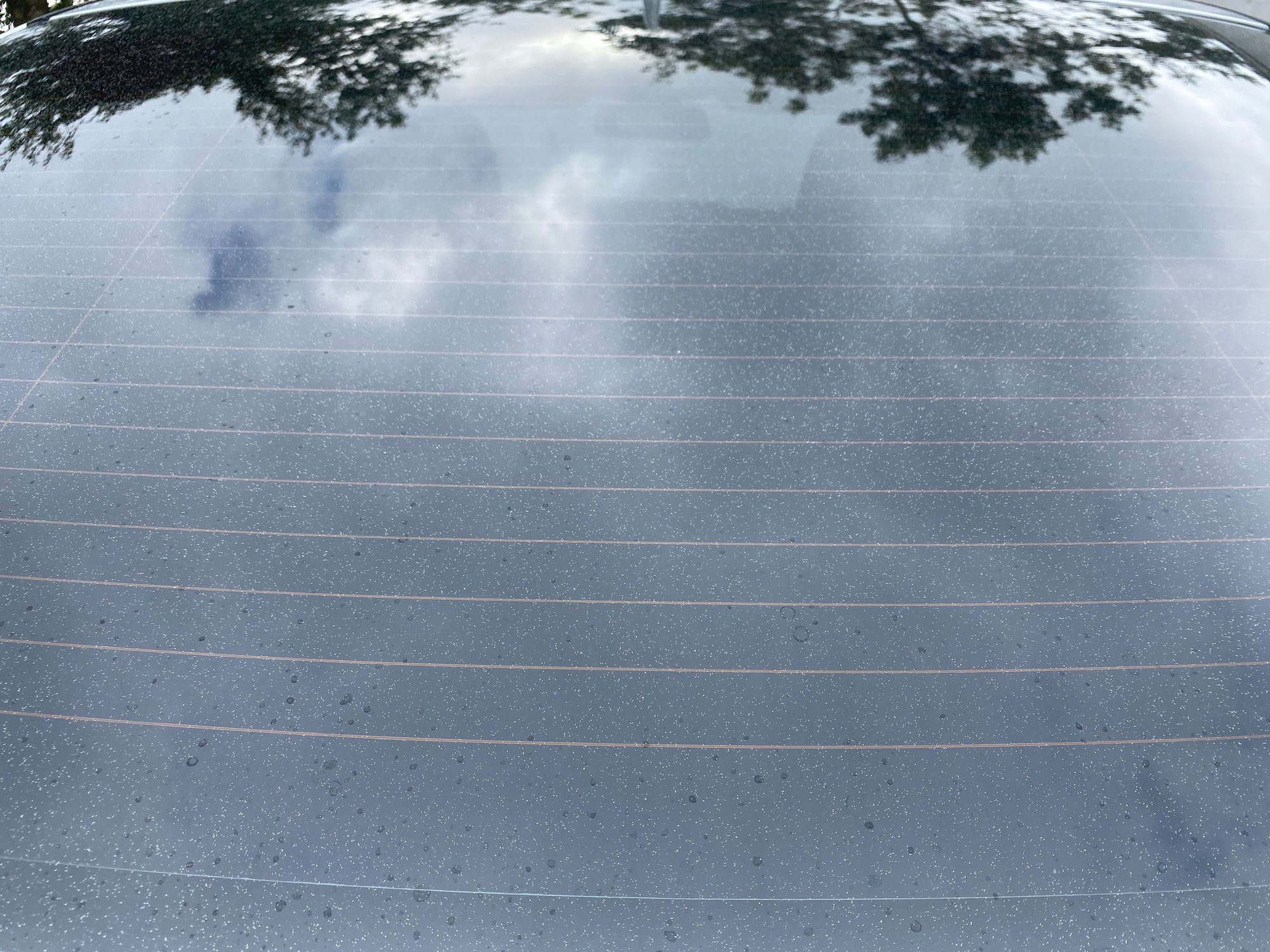

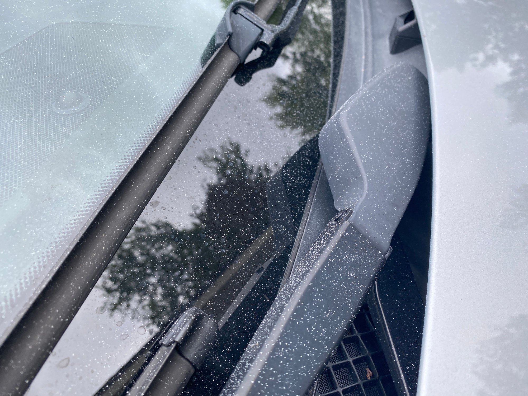

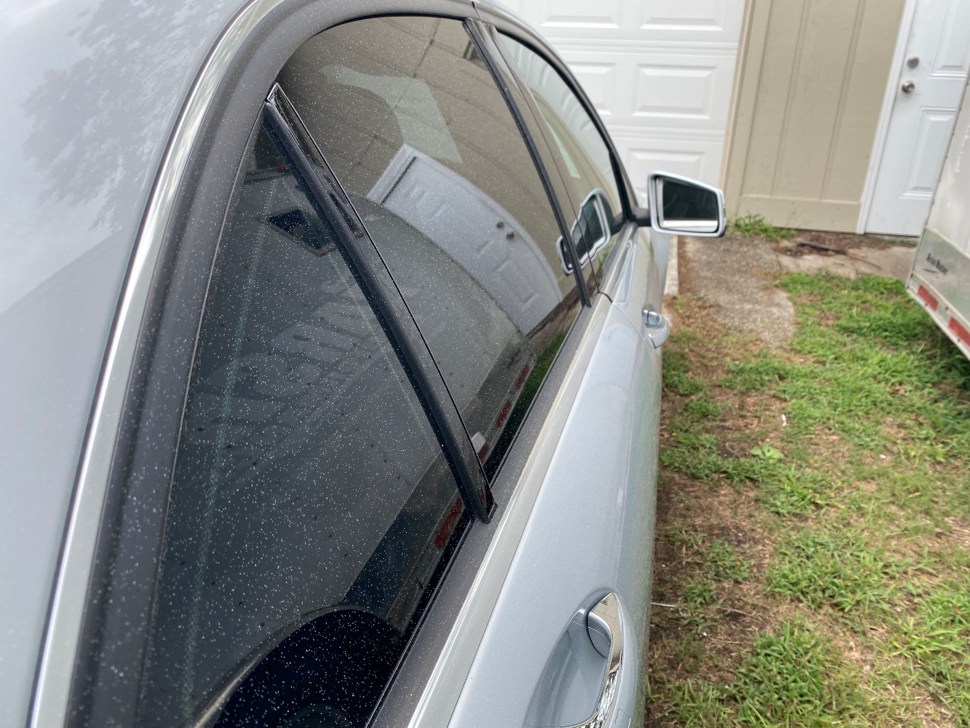

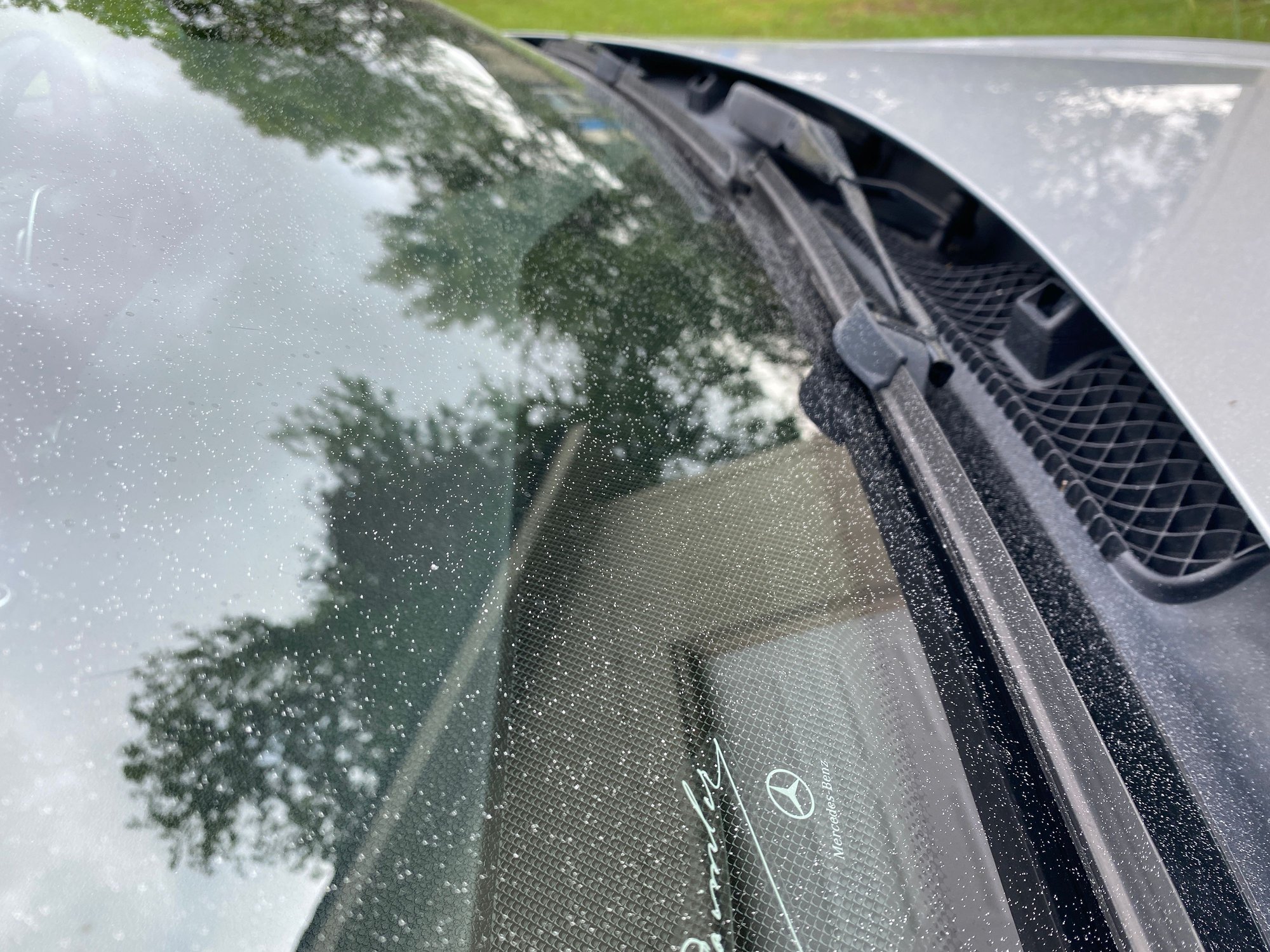

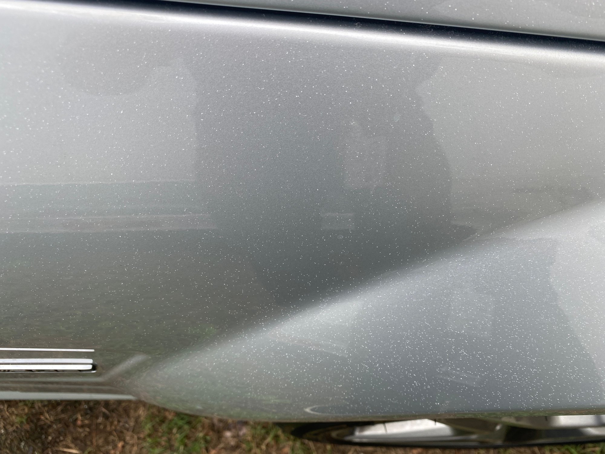

So this happened.....
If it was raining ****, I’d get hit with a dick.
Neighbor decided to have a contractor spray paint the front of the white building.
They covered up my trailer but missed my car.
The contractor was mortified when I sent him pictures and he dropped everything and came over to clean it up.
luckily is was latex paint.
At least I got a fresh coat of ceramic on it now.
Fcking overspray.

So machinist, I commend you on staying calm. I would of went scortched earth on who ever did it....BUT....here is some motivational positive news:
1. over spray tends to dry in mid air and then it lands on the surface without much tact or stick
2. if you take the time, with warm water and good off (orange oil) you can wipe it all off pretty much, it will just take some elbow grease and time
3. The rubber trim: just use a silicone grease and rub it gently and most of the overspray will come off (assuming that’s it’s water based paint)
4. Gives you an excuse to wax the car too
Don’t let it get to you, with very warm water and some microfiber rags and circular motions (or even a random orbital polisher) it wI’ll come off...
Sorry You had to go through this, given that you stayed calm and collected you will have some great positive karma coming your way...

Well, the worst of the curse is out of it.
We used a product called Goof Off, but it wasnt the citrus stuff. It smelled more like petroleum distillate.
There are a few dots here and there on some of the plastics, and I am sure to find stragglers every time I re ceramic it.

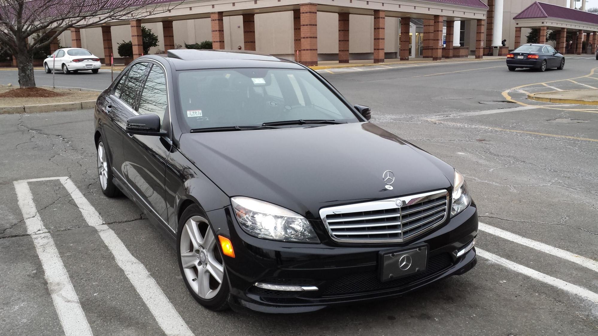

Super easy you can dismantle it from underneath.

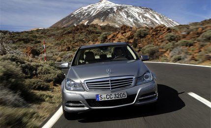

here is the luxury grill on non-AMG models only
there was a member on here i think “edwin- something“ edwin13? He had the AMG bonnet emblem for sale. Is it these guys:

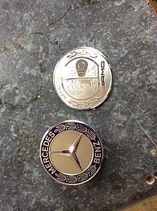

Those are the emblems I have there, the matte silver one. ^ A member made a batch of them 3 or 4 years ago, great quality.
I bought a couple extra but never used them because my original held up fine. I could try to dig them up if anyone’s interested.

Do they attach to the hood like the OE emblem?
And Yes please. Do Want.

Jobs pretty much done. Just have to put some back to black on the plastic trim around the mirrors and it’ll be good as new. The Goof Off left some residue on the plastic that only it seems to take off.
