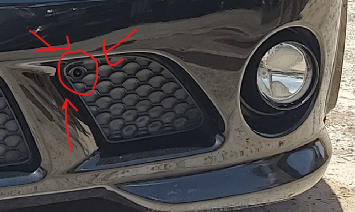

Sorry gents I can't find a pic, what's the standard location for this? I have it hanging near the horn/secondary air pump
Old Sep 11, 2023 | 04:40 PM
DarkMirror's Avatar
Joined: Apr 2023
Posts: 54
Likes: 27
2009 C63
I literally just learned about this while my bumper was off this past weekend and forgot to plug is back in. It lightly snaps in at a certain angle behind the grill.

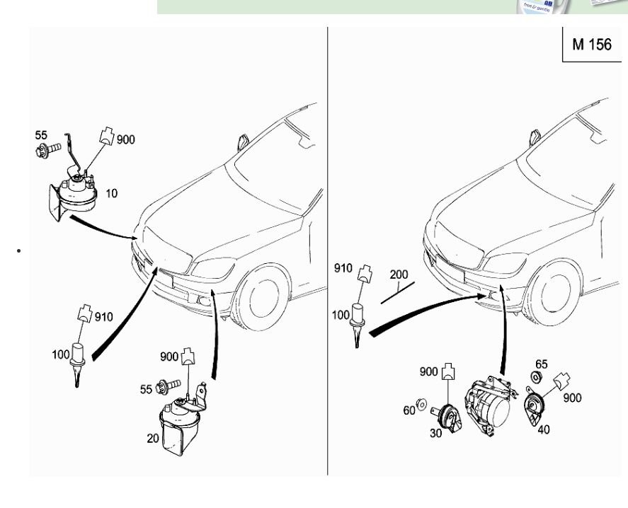

Mine is also behind left lower grill on black series, I don't remember where it was on my facelift c63 but guessing it is somewhere there.
I looked it up and it was pretty unhelpful, (100 on the diagram) right diagram is for M156)

Oh wow, no wonder I can't figure it out with the bumper off the car lol 😂 thanks guys
