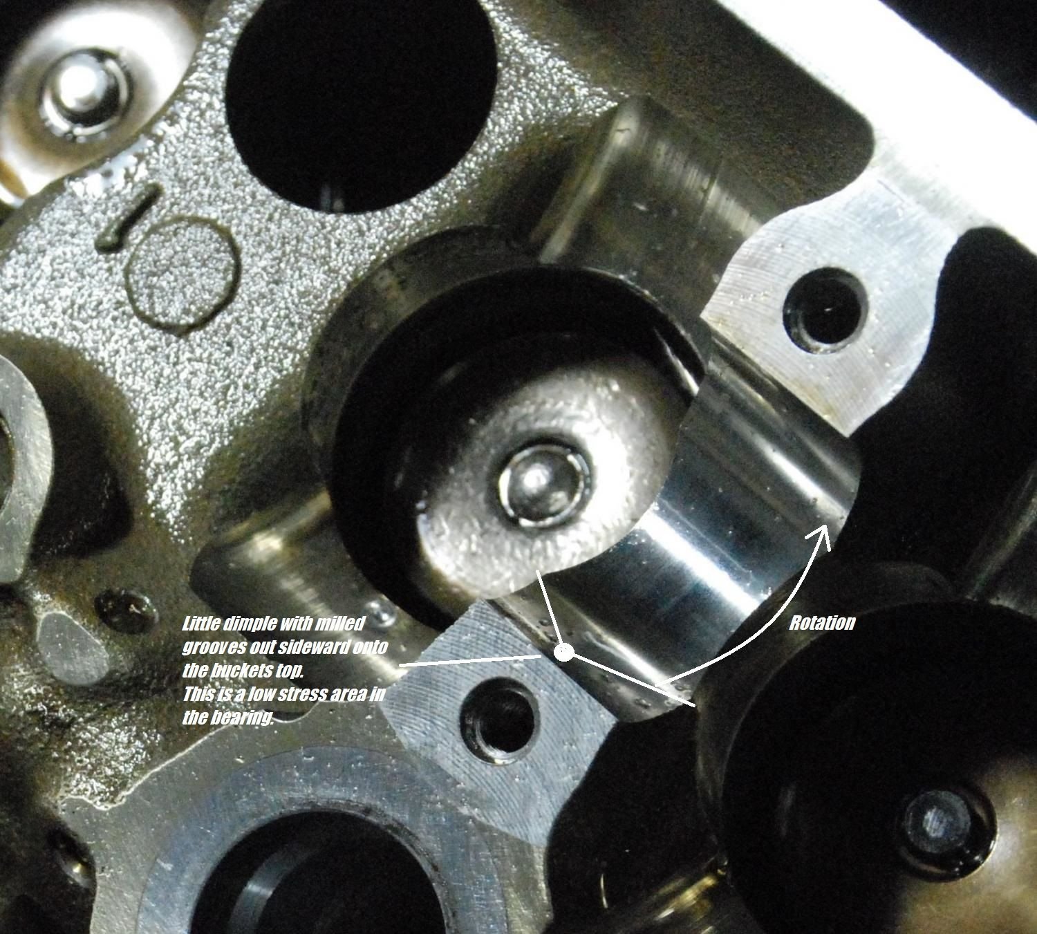

Originally Posted by The Machinist
I
I have been toying with the idea of oil squirters and do have some ideas. I’ll cover that at the end of this post.
Why not get use of oil already there?
Volvo design in old redblock got a 'splashguard' that collects oil that is pulled up from the clearance between lifter and head, and also collects oil from the bearings.
This makes the oil stay longer to get more chance to lubricate the buckets and also acts like a oilbath when engine is coldstarted.
They have NEVER had any problems with worn buckets.
The splashguard is cast into the head in the volvoengine, if watercutting some alu sheetmetal and bending it clever, it might get the same function when engine is running, not creating the seal to make the coldstart oilbath thou.
the rail at the red arrow.
VW did something similar with the old 8v which used the same lifters as the old Volvos. It’s probably why those old engines lasted a million miles.
VW did it to keep oil spray from going into the PCV I always thought. Most of them end up getting removed because they get deformed and degrade from the scary high oil temps present in those old cars.
I think the problem with the AMG heads is a lack of oil to begin with, but I definitely think it’s worth looking into seeing if an oil dam could be installed in the AMG head. I’ll have my valve covers off in a couple weeks to install a set of my camshaft phasers so, I’ll be taking some pics to that effect.
8v head
“Cam baffle”
The VW cam below is rusty because it’s been out of an engine for a decade or more. But same technology as the AMG heads.

Yes, volkswagen and audis have the same design.
And IF deciding to make some oilsquirt, look at Ford Pinto engine, they´ve got a thin metal tube fed with oil and drilled holes.
Thats certainly the idea I was going with. I already know where I’m planning on tapping the oil supply from. It’s just a matter of getting it to fit under the VCs. They sit very tight to the head and don’t leave much room.
VW/Audi/Volvo use the same exact lifter in the early engines. Right down to the last dimension.
The only differences are cylinder spacing and valve spacing.

I´ve also been looking at making a 'controlled leak' from the bearings to the inlet cams, somehow mill a groove so oil can seep out onto the bucket, just where the camshaft 'hits' the bucket.
A sketch:
