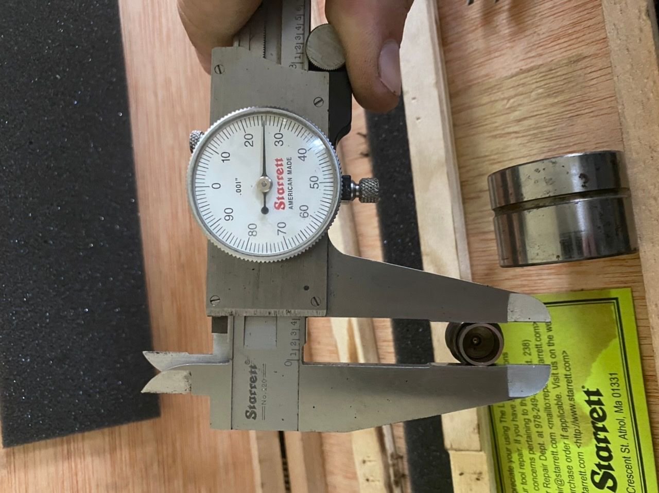

As the title says, read it and get pissed. These parts are almost identical.
The only difference is the “special” coating on the wear surface. The VW lifter actually looks a bit more stout than the Mercedes one on the inside. The plunger that sits on top of the valve is slightly larger in diameter, but I can’t get my micrometer on it. Then again, there has been 30 years of “value engineering” done to the one that goes into the Mercedes.
Edit: This micrometer was last calibrated umm..... never.
The point is that it measures both parts the same, not what it’s actually measuring.
250,000 mile lifter from a 1991 VW GTI. Note the micrometer reading. Also note that aside from the surface rust, there is virtually no wear.
The lifter that a certain company charges $31 for. Note the micrometer reading.
Side by side.
Side by side

I got bored and took the VW lifter apart.
Parts blowup. (The check ball and cap w/ tiny spring are supposed to be on the right side of the inner piston.) I’m lisdexic. Don’t judge.
Inner piston diameter. Sorry, the 0-1” mic is out in the garage. This’ll have to do.
Outside plunger diameter.
