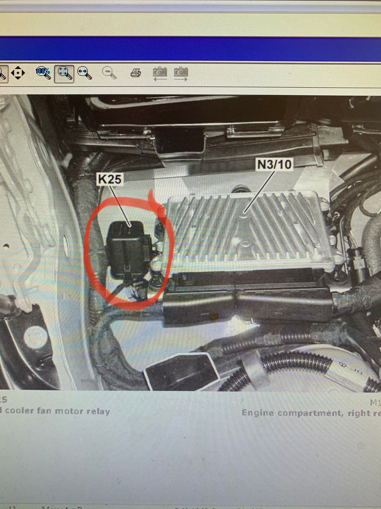

replaced the fan relay under the hood and everything has been good so far

Which relay was it?
Old Nov 19, 2020 | 08:46 AM
merino97's Avatar
Joined: Apr 2020
Posts: 5
2012 c63
Originally Posted by Jasonoff
Which relay was it?
Passenger side right by the fire wall under the plastic cover.

Nice, that must be what the fuse in the trunk feeds for the signal..
Where did you get that diagram?

Alldata
You wouldn't happen to have a part # ?
