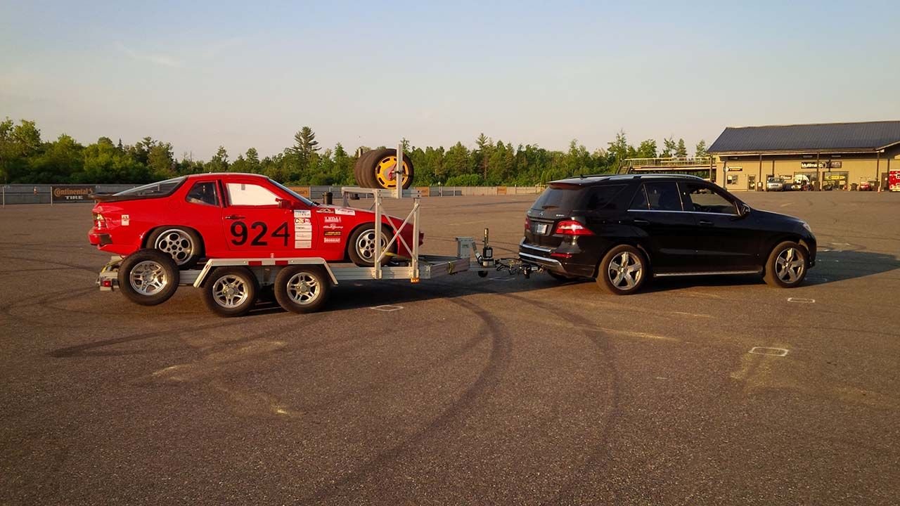

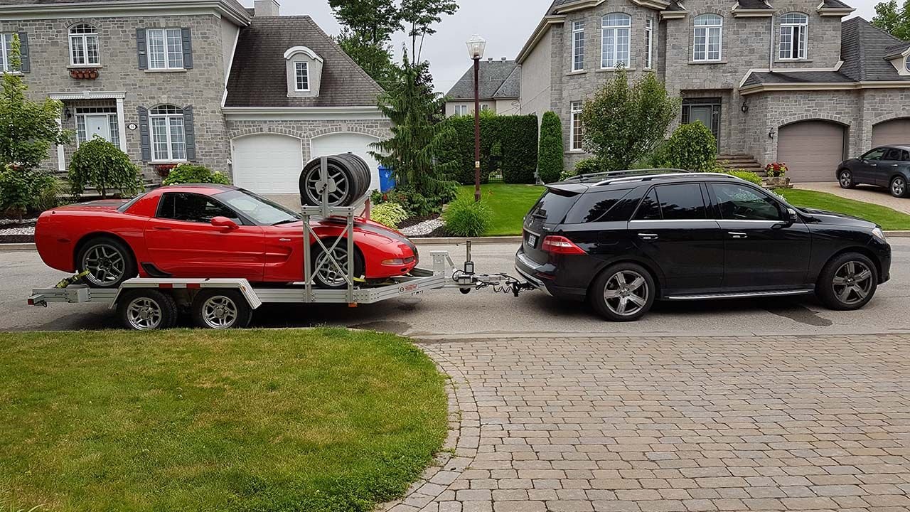

I usually tow one of three race cars (not a C63) and also use ratcheting tie-down straps through each wheel. Far more secure than the basket that just goes over the front wheels if you're going someplace that has a lot of twisties and hills along the way. I remember a deer jumping out in front of the ML when I was towing the 924 to Calabogie one night and had to hammer on the brakes. Despite the fact that 11000 lbs do not stop on a dime, I am certain that if the car had not been properly secured with ratcheting tie-down straps through the wheels, it would have ended up inside or possibly on top of the SUV. I think it really depends on WHERE you're towing it... I would have no reservations using a rental U-HAUL with the tire baskets going to Mosport or even Watkins Glen (mostly highway and flat), but I would never attempt it going to Calabogie because of the twisty roads, hills and wildlife.

Thx. It's definitely those unexpected events we are planning for. I think I am going with over tire straps like in the picture posted above but on ALL 4 corners to make use of the e-tracks built in to the trailer. Each strap is 3 times stronger than the corner weight of the car, and the kit comes with front wheel chocks that also mount in the etrack to help keep the car in place during a panic stop. i might run a safety strap through the subframe too like Jasonoff mentiined. Most of my tows will be flat wide Florida roads less than 3hrs away but there will.be some out of state mountain trips. I will.keep some extra straps on hand in case it needs more securing for those trips.
I used to have a hillclimber corvette c5 similar to that.
