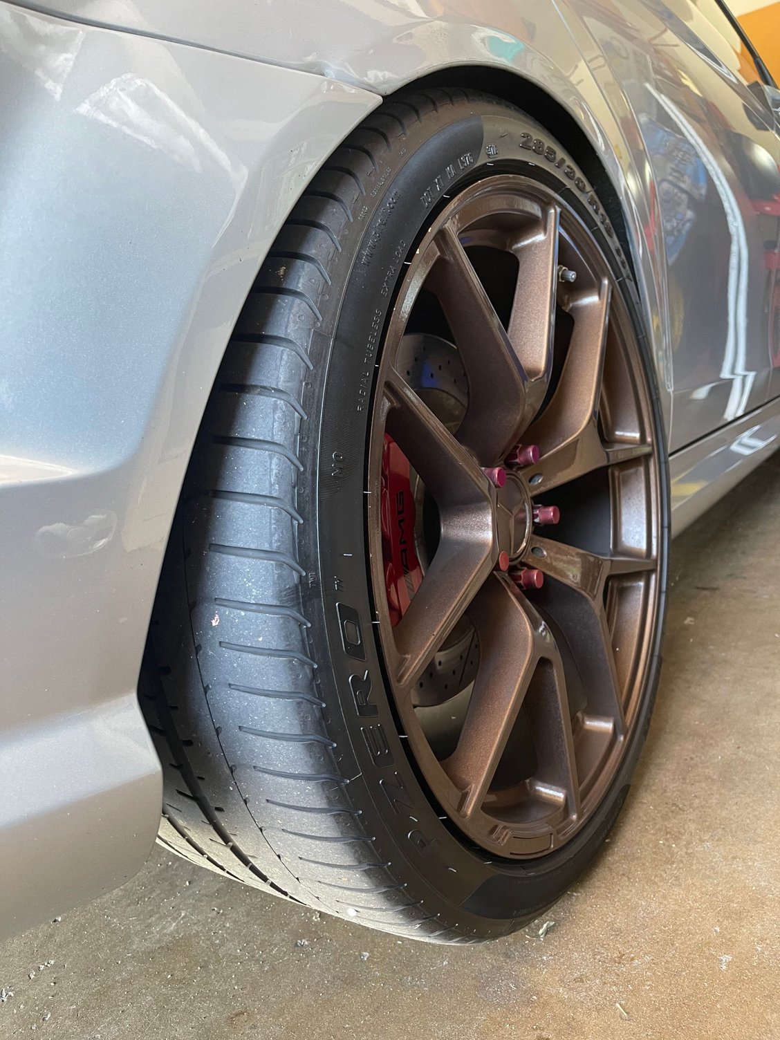

Hey guys I just bought these avant garde m615 wheels in matte black for my c63 amg affalterbach edition. 19x8.5 and 19x9.5. 245 front 275 rear mps4s. Does anyone have any experience with these wheels and if they are good or not.
thanks nick.

Good luck... that might be rub city, those are only available up to +45 offset for the rear 19x9.5... 275 will likely rub, you'll need 255s for sure fitment without "work"

275 on a 9.5 inch wheel...that sidewall will bulge 255-265 is generally the spec for 19x9.5

According to Michelin for the PS4s and Continental for the Extreme contact sport 9.5" is the ideal size wheel for their 275/30/19 tire (rim width range of 9"-10" with their measurements being made on the 9.5"). 9.5" is also the ideal wheel width for the 265/30/19, with 9" being ideal for the 255/30/19
This is 275/30/19 on a 9.5, it isn't stretched or "bulged" in my opinion.

If what blurred said that they only come in ET45 for rear then your current 275/30 will in deed rub.
Your current multi spokes have ET54 which means those Avant garde wheels will stick 9mm further outboard than now.
If you had them try fitting 10mm spacers to your current wheels and check.

The highest offset is not et45. I got a custom offset specifically for my car. That is what the wheel guy told me when he ordered them and they will fit not problem with 275s. And I belive the max spacers I could run in the rear with the stock rims is 5mm without rubbing.
Find out what offset...
the forum sponsor/vendor motorsportsla only offers +15 to +45 for custom offsets so I'm assuming that's the minimum pad thickness from the manufacturer.

507 reps 19x9.5 +45 with Pirelli Pzero 285/30/19 lowered on KW V3

that's because you have flattened your fenders. You can of course work your fender and flatten/pull them, but some of us don't want to do that.

I have avante guard rims m590. With a 9.5 rear et 47. I would not go more than that in my opinion. It’s very aggressive looking and with a 275 depending on the tire could rub. The thing is not all 275 are created equal some are square some are rounded edges and some vary in actual section width. Now my fronts are 37et and I think I should have gone 32 to match the rears. In terms of rim quality I love mine very good. Those rims look nice also. Et45 can it be done maybe depends on the car and tire.

A hammer to where the fender and bumper tabs meet, most of the time the tire could rub there if you’re lowered.

You would use a fender roller and roll them until flat or slightly pull as well. There are risks of course as you weaken the edge to dents as well as they are extremely susceptible to paint cracking and flaking off, then rusting.
