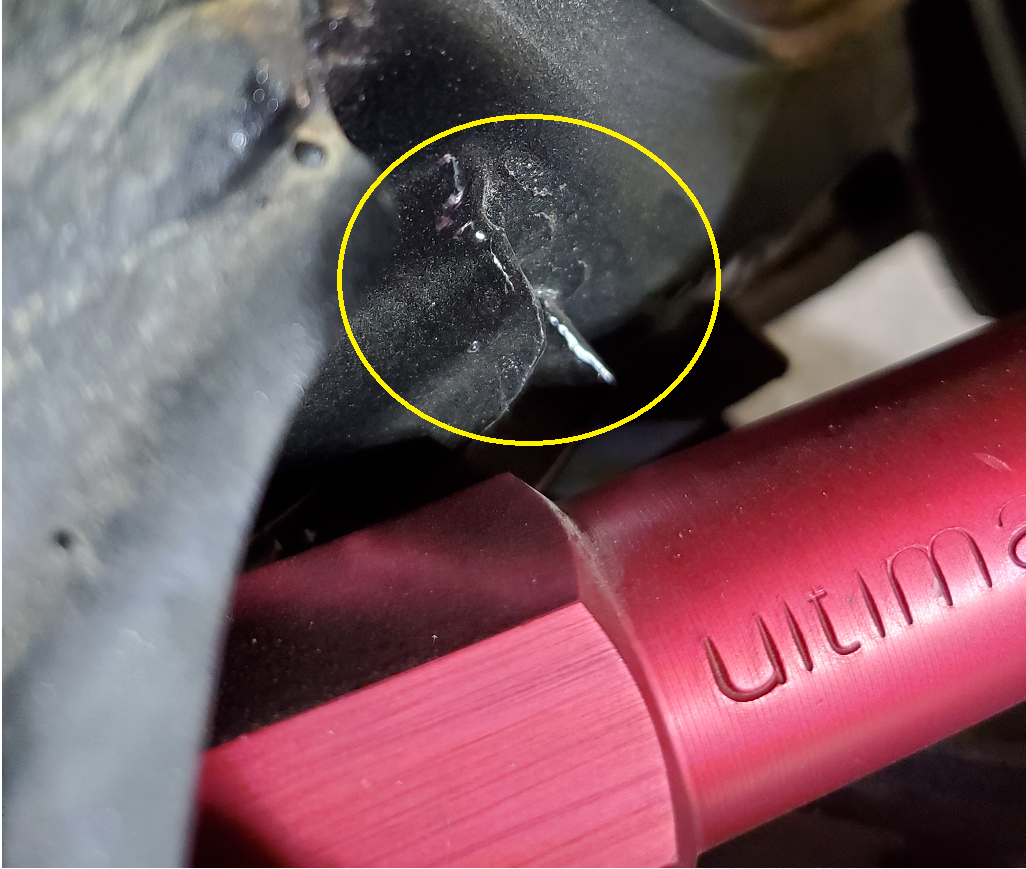

Actually they are quite a bit different. First thing is that the UPD arms use spherical bearings versus what looks like poly on the F1 arms. This makes a difference in articulation of those joints.

Ok that’s fine, whatever. I was just trying to help correct your prior post by pointing out that they are indeed different. Sure they’re both threaded rod so I guess they’re similar, as any aftermarket arm would be. Many of us have no need for road manners and would rather have a firmer arm with greater range of motion. I’d be replacing the F1 poly with sphericals anyway before they even got here.
I don’t particularly like the double locking nut design of either as they tend to slip and twist under load. I’m about to take mine out to correct that as well as replace the shïtty cheap sphericals UPD ships with theirs. I might also add that the UPD arms contact the frame on full compression (and only on full compression) and damage the arms - my straight arms each have a 1/4” deep divot taken out of them. I’m going to have to grind down a frame edge while they’re out, and the arms may be trashed depending on what I see when I get them out. When I reached out to ask if they would replace just the arms, they were real dïcks about it, so UPD customer support is about as bad as it gets if that helps make your decision easier.

I hear the kmac ones have issues with noise and now as above the UPD contact the frame!

For UPD there's a passenger side tab you need to grind down a bit so the toe arm doesn't make contact. They have instructions apparently that outline this in the install steps.
After I used loctite on all the nuts they seem to be pretty decent and they've been through quite a bit of abuse. Around 6-7 track days so far.
