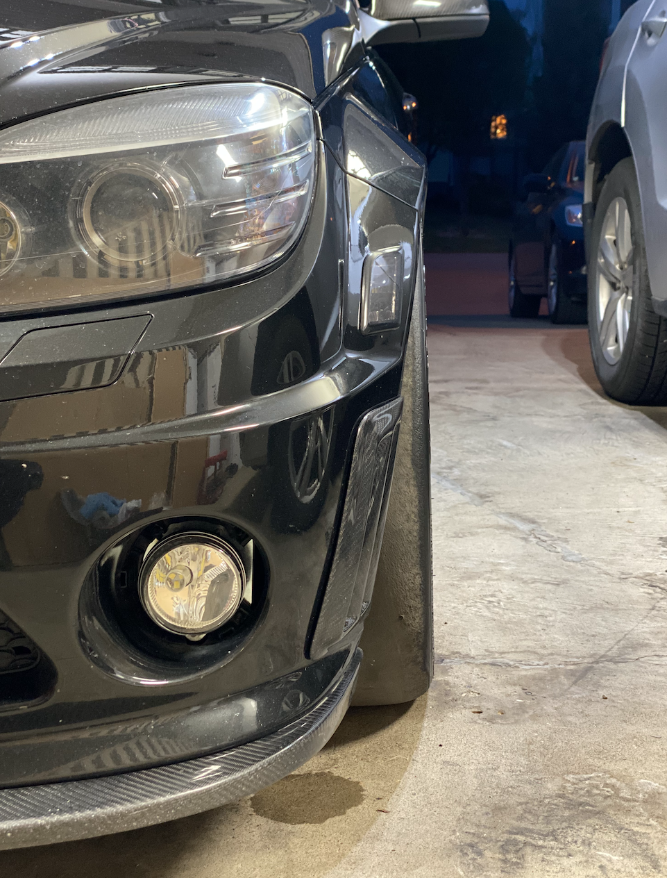

Here's how mine sits right now
Since the W204 forum has the most track rats probably of any AMG forum-gnscbco.jpg
BIlstein PSS10 w/ KMAC camber plates. Dampening set at 8F, 5R
Whiteline adjustable end links
UPD rear camber/toe arms
Alignment settings:
Front:
Camber: -3.9
Caster: 10.8
Total toe: 0.32
Rear:
Camber: -2.2
Total toe: 0.3
Front and rear strut bars
Carbotech XP10 Front, XP8 rear
Stoptech SS lines
Motul RBF 600
Recaro GF-UP bucket seat
18x8.5 Volk TE37
Square 235/40/18 Maxxis RC1
Weighed on Proform scales at 3980 with 150lb driver and 3/4 tank of gas.
Havent had a full shakedown with this setup yet since COVID re-shut down our local racetracks.
Some changes I'll be doing eventually:
Square 255/35/18 (likely Nankang AR-1)
Weistec transmission pan
Oil catch can
Sven oil cooler

how do you like the Maxxis RC1? 235 is a bit small but looks to have a solid offset for the W204. the annoyance i find is that R compound tire size selection for larger sedan's outside of your 911, Viper, Camaro, Mustang, etc are really not properly matched or available.

The Maxxis RC1 hold up great. It takes quite a bit to get them up to temp, but they are solid after. 235 is pretty tiny, but these definitely run one size up.
I've tried other tires like A052 and RE71R, but those sidewalls are too soft for our heavy cars.
Finding properly matched wheels are another obstacle as well

the maxcis rc1 run one size up and you are going to fit a 255 up front? Please let us know how that goes
Yeah, a 255/35 Nankang runs pretty true to size from my brief mock up
Theres quite a bit of room in the front wheel well now because of the coilovers and camber setting. On the track setup, I have to run a 13mm spacer to flush out a 8.5 +35. Tons of room in the front and back in case I need to adjust for increase tire poke.
Since the W204 forum has the most track rats probably of any AMG forum-ka1shqs.png
https://i.imgur.com/Ka1ShqS.png
Yeah, I bet I'll be doing some trimming up front. I have some 19 X 9.5 +27 on order to bump to 265 in the front. With the near -4° camber, it does make quite a bit more fender room though.
I was test fitting with some spacers and washers using my rear 10" and a 265 to eyeball if that +27 would work. I think I can make it fit.
I'm guessing your fender lines are removed?

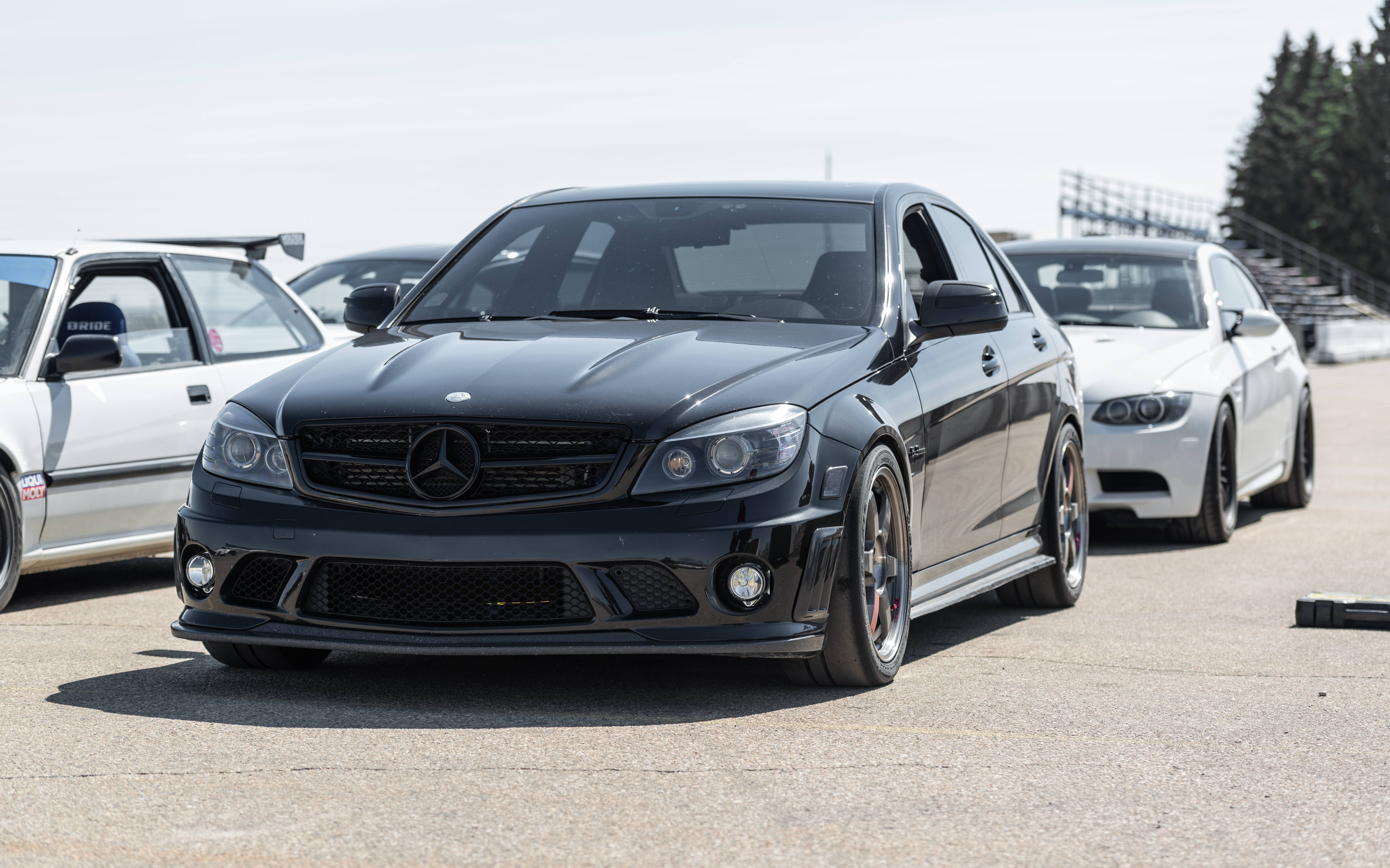

Obligatory shot of my track car.
No, but maybe an inch trimmed from the outside edge. The engine bay is too exposed for my liking to remove them completely.
I also have my fenders pinched and pulled out a bit. If I have to do more it's not a huge deal.
