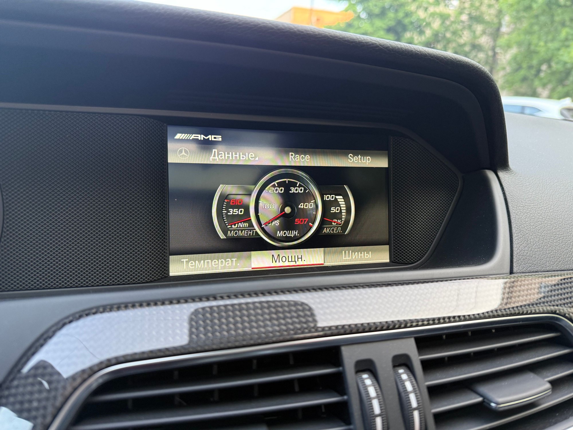

Guys, my 507 doesn't have the AMG Performance Media option.
Can I retrofit it with this? Who did it? What parts are needed, please tell me.

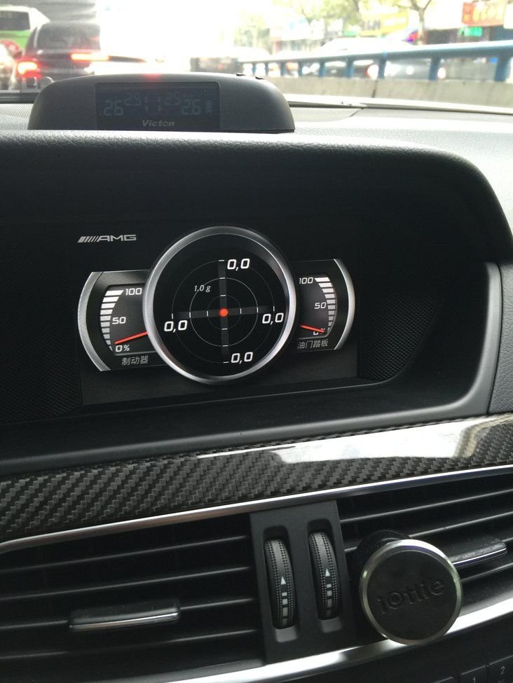

No it’s the display with gauges that BS cars got and was an option on others.
If you do a search here someone tried. It’s really expensive and really complicated. The consensus is that it’s totally not worth it.

Yeah but more like a toy. Nothing useful can be extracted from it except maybe trans temp. That’s an expensive temp gauge.

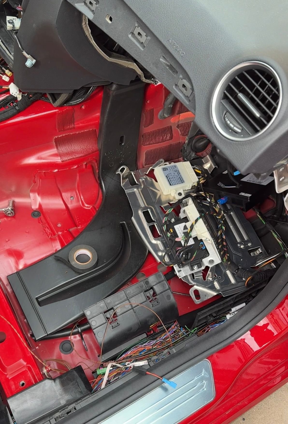

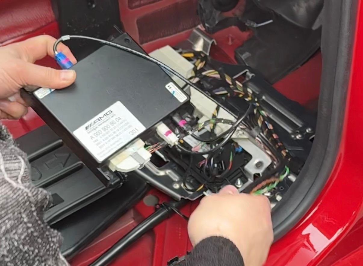

Old Nov 8, 2025 | 10:35 AM
Alex-r-1's Avatar
Joined: Sep 2013
Posts: 222
Likes: 24
C63AMG Coupe 507, GL X166
We did it! 🤘🏼😎

Originally Posted by roadkillrob
Nice, what did you end up spending all in?

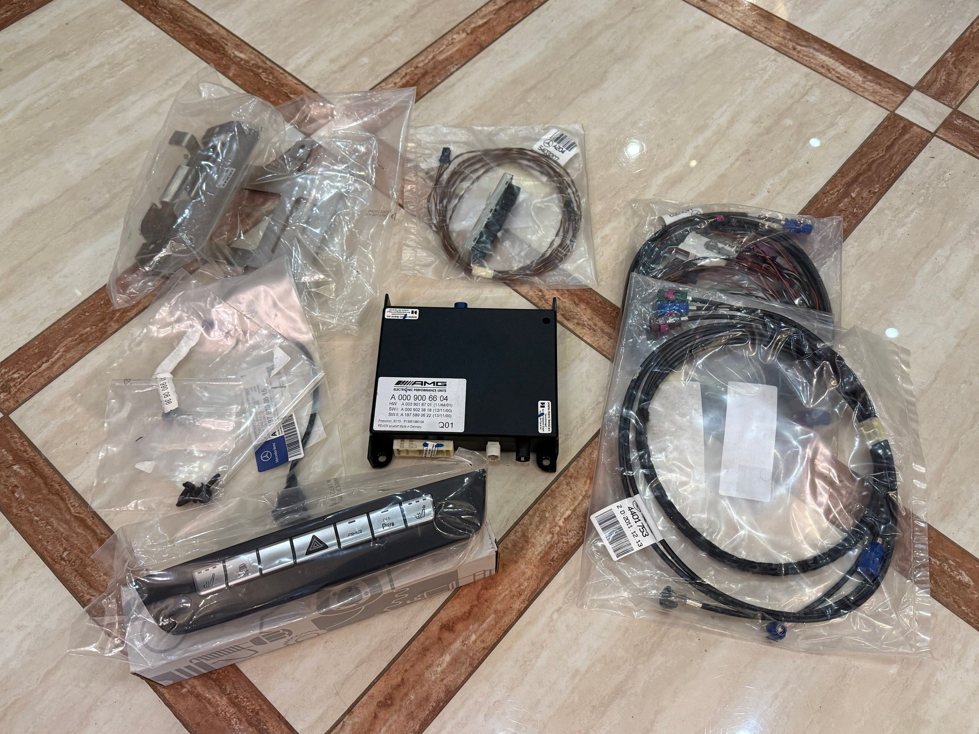

I found a new control unit at a good price. About 2000$

Can you give full part numbers of everything needed to do this?
Old Nov 10, 2025 | 05:45 AM
C63 BS Black's Avatar
Joined: Sep 2022
Posts: 52
Likes: 8
C63 BS Magno Night Black
I gave Alex-r-1 all part numbers. Thank for mentioning me

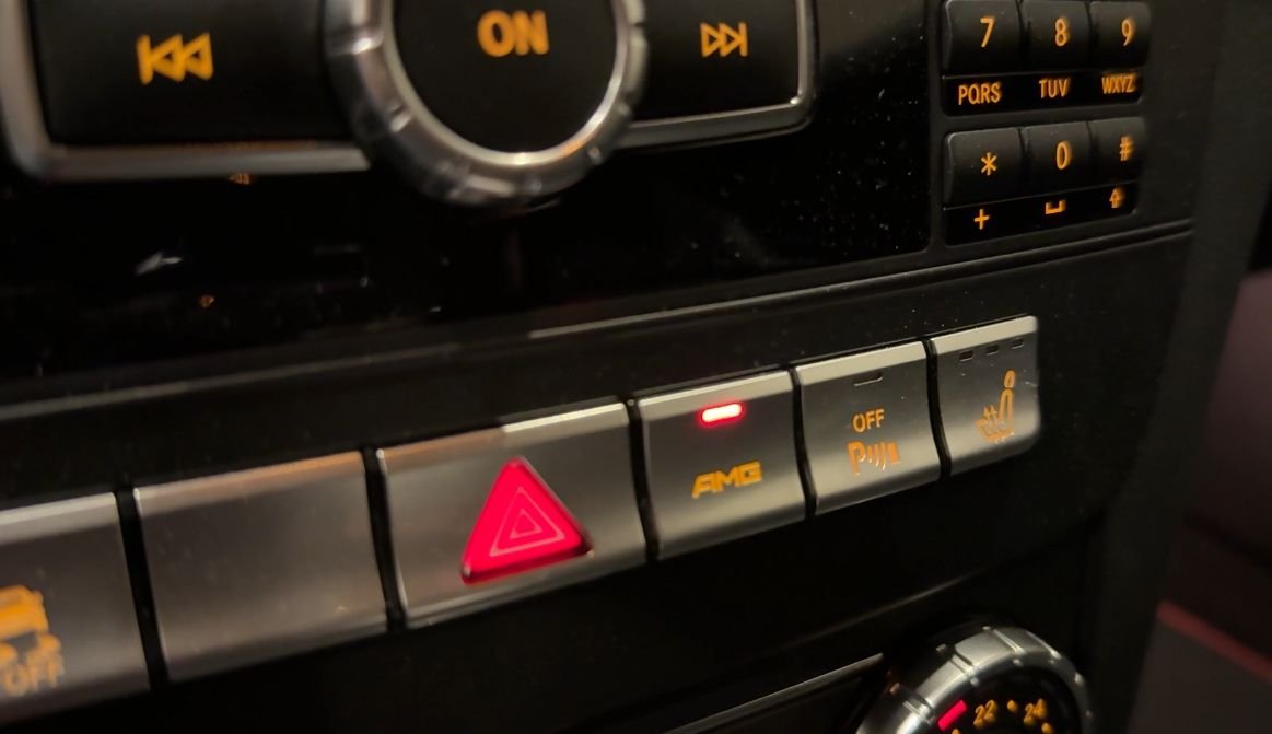

can you show us that your button lights up when you turn on the performance media? thx!
i've just retrofitted this onto my BS as well, one of the last hurtle to get over is getting the tiny indicator on the AMG button to light up when the program turns on

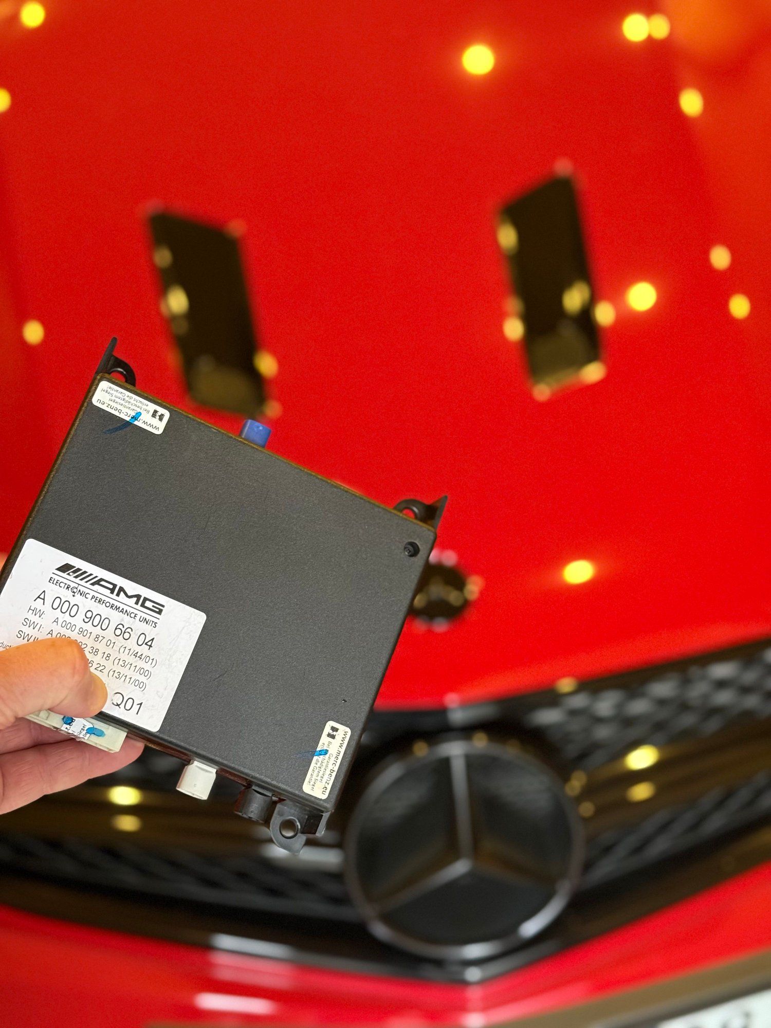

The part # above for the control unit A 000 900 66 04 actually is replaced by a new part # A 000 900 22 06 both of which has no stock anywhere.
You need to activate the Drive Unit via diagnostic equipment. At first, my button did the same. Now everything is fine.
yup, that unit has been NLA (no longer available) from MB for years, I've literally bought myself an Edition 507 a year ago, just to farm this control unit out of the car, then took a slight loss on selling that donor 507 without this feature..
not sure if anyone else will go that extra length like I did, but it was a last-resort in my case, since i've not had the luck of sourcing the control unit for over a year.

I have a few of these units i bought a few years ago...
