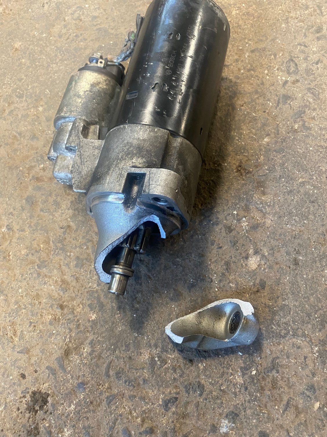

i was able to get the car on a lift and remove the starter, I was definitely not expecting to find this Originally Posted by Mort

Oh Oh, must have been the starter whirring and not engaging. Better check the gear teeth on the flex plate and the flex plate itself as well.

That is a new one I have not seen that reported on a c63. Has it ever been out and or replaced almost like it was loose or something else is in there loose and hit it
ExploreI'm going to go out on a limb here and say that broken starter is a symptom of the larger issue. Not the cause.
Perhaps an injector was stuck open and during the next engine turnover the starter broke due to hydrolock.

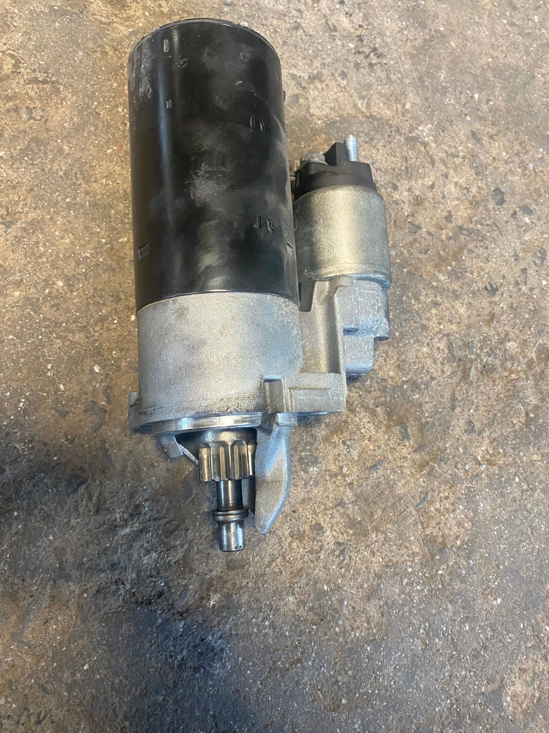

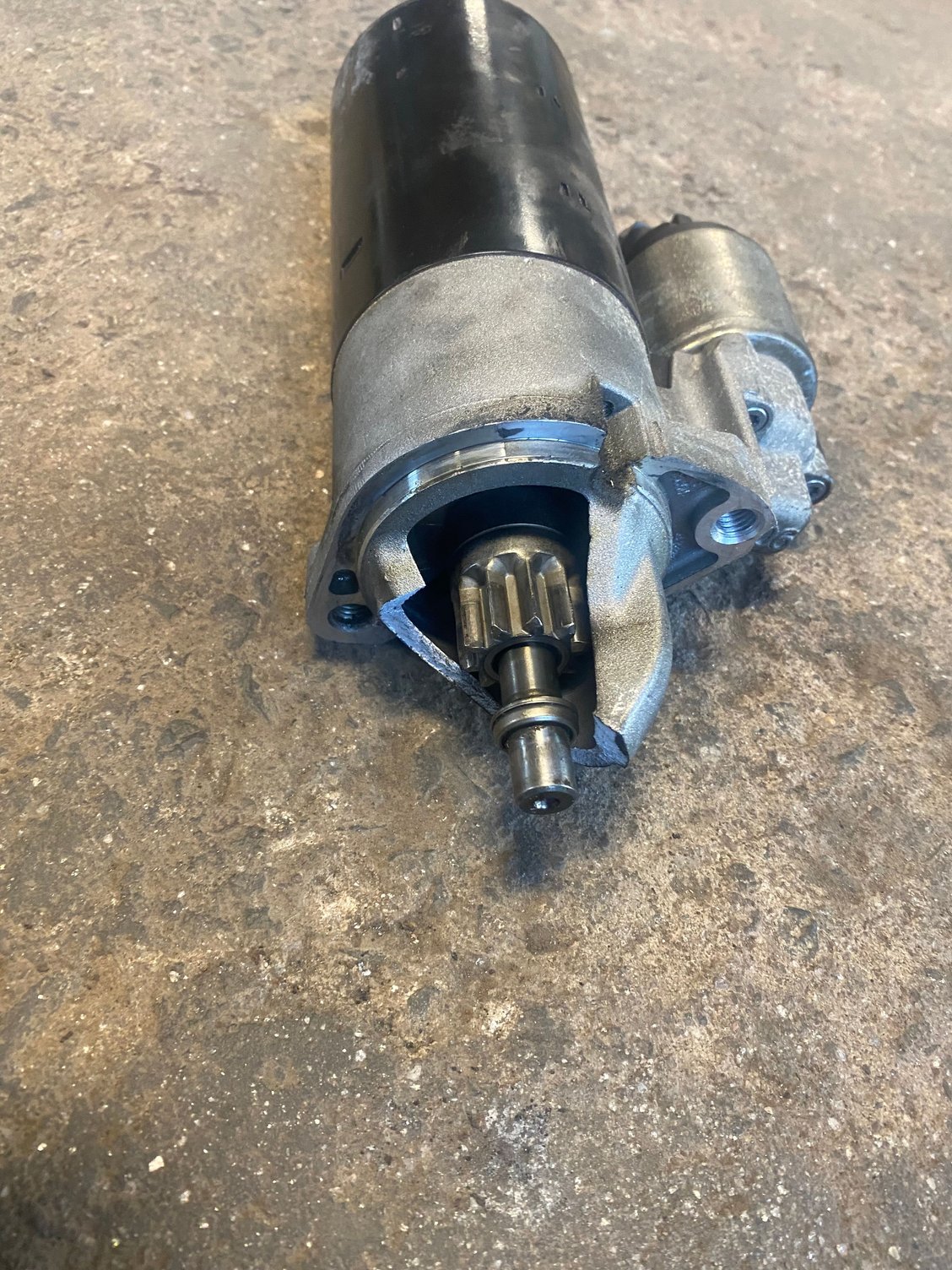

So here’s where I’m at now:
my initial problem started when I was sitting at a light and the CEL started flashing and stayed on and the car started to rough idle. Driving it home it would be shaky accelerating and going up hills. I hooked it up to a scanner and it told me cylinder 8 was misfiring. I reset the codes and took it for a short drive and realized smoke was coming from exhaust. I shut it off for a while and when I go to start it there is a whirring sound so I took out the starter and replaced it with a new one. Now when I go to start the car the engine actually cranks but won’t fire up. I’m really stuck at this point and thinking about bringing it to the dealer. What could be the reason it won’t fire up now?

So along with the new starter I ended up putting in new injectors spark plugs and air filters and i went to start the car and it’s still idling very rough and the codes are still showing cylinder 8. Is this a sign the rod is bent, what are some tests I can do to confirm it?
