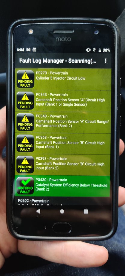

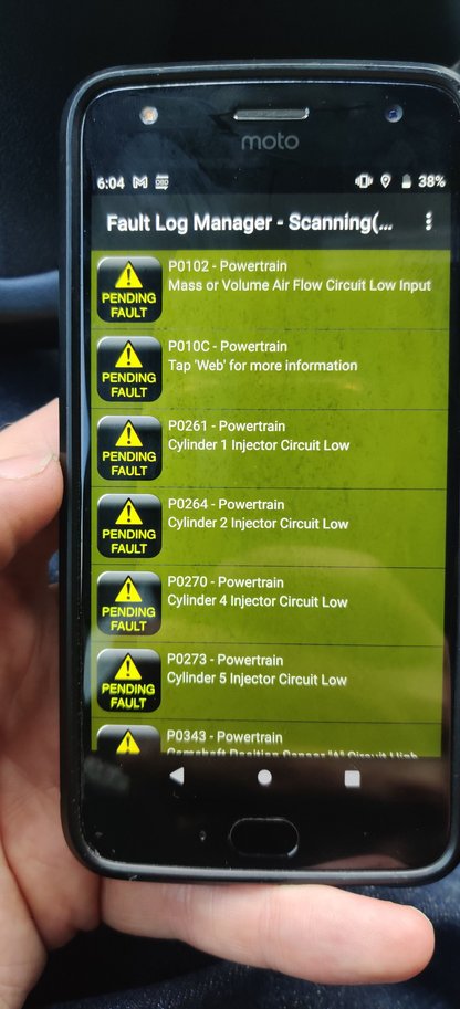

Give a little back log of what happened. I drove the car to work perfectly fine no issues. Went to drive home from work. Made it about 2 miles went around a turn. Gave the car some gas it bogged down shifted from second to first no RPM and just died on me.
Pulled the codes and oh boy tons of them.. Shesh.. I will attach pictures to thread. Car cranks fine just doesn't fire up. Brand new battery i got it towed so i won't be able to tinker with it until this weekend.
Car is tuned by eurocharged and has been for 4 years. E85 flexfuel kit for two years no issue besides some no start issues now and then maybe twice a year. Forgot what CC injectors im running. 6-- something and LTH.
I don't trust this scanner too well because its says misfire in cylinder 10??
Anything i should look at first or just tow it to mercedes?

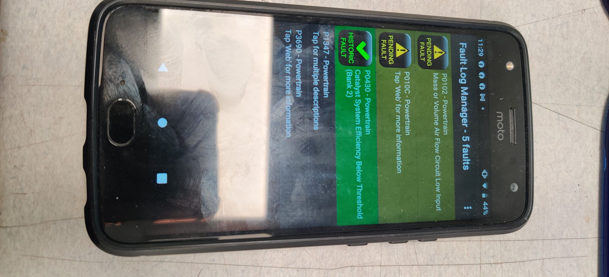

Well that was short lived. Went to start the car this morning died after ten seconds of idling fuse 23 is blown again. Tried replacing it and it blew as soon as I put it in. I wish I could find a diagram for the wiring for that fuse. These are the new codes pulled
