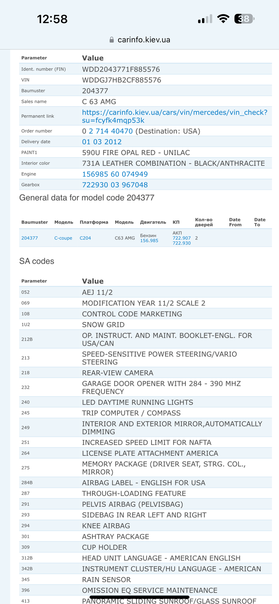

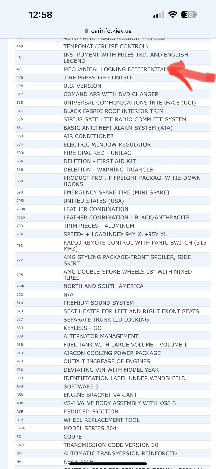

Mine has the 471 code but it goes by Mechanical Lock Differential. I have C63 2012 P31. Former owner optioned the differential. But to be clear. LSD and MLD don’t work the same way. Both do help with traction.

Is like LSD but it’s not the same. MLD is not an open differential. The Axles lock in a different way or percentage. Here’s a link that explain how it works. I am amazed that no one knows about this in this forum.

Read the attached files and watch the videos. Also I used to own a Focus RS with torque vectoring differential. There are many types of differential and variations. Look at the data and facts.
