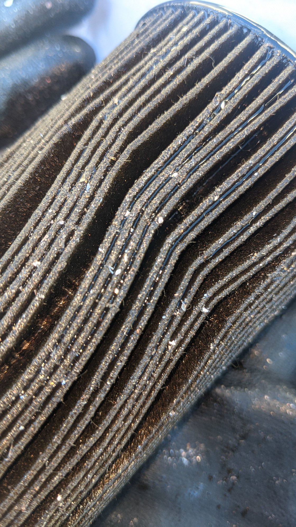

So also got new oil and filter, dropped oil (sump and cooler) and it smelt of fuel and seemed a bit runny but is 0/40 it didn't look massively sparkly with a torch on it but was some faint sparkles
Then pulled filter no massive chunks but lots of glitter. Damn. Put in new filter and refilled. Car started and ran smoother than ever, but could here a tick/knock, brief light rec and noise accelerated with engine revs.
So looks like injector held open after coming of WOT (but did then close so no hydrolock) and fuel compromised oil film and toasted big end bearings.

So when a garage asks you to come in rather than discuss on phone and use the words "never seen that before" you know it's good news
Going in tomorrow to see and get some pics but to summarise
It did hydrolock at so bent rods.
Bore wash and scored bores so dead block
Bigend bearings pushed out like squirty cheese. Dead crank
Bearing material pushed through oil galleries into cam so ate head cam bearing surfaces . Dead heads and dead cams
So think that's pretty much no components left lol
One dead injector took out the whole engine.
Is what it is , probably scrap car for parts is probable outcome.
Will post back with some damaged engine part pics and final outcome.
