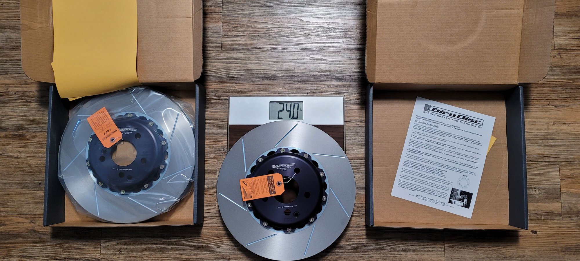

Front Girodisc/Factory rotor mass. W204 C63 Girodisc Part #'s labeled on top hats

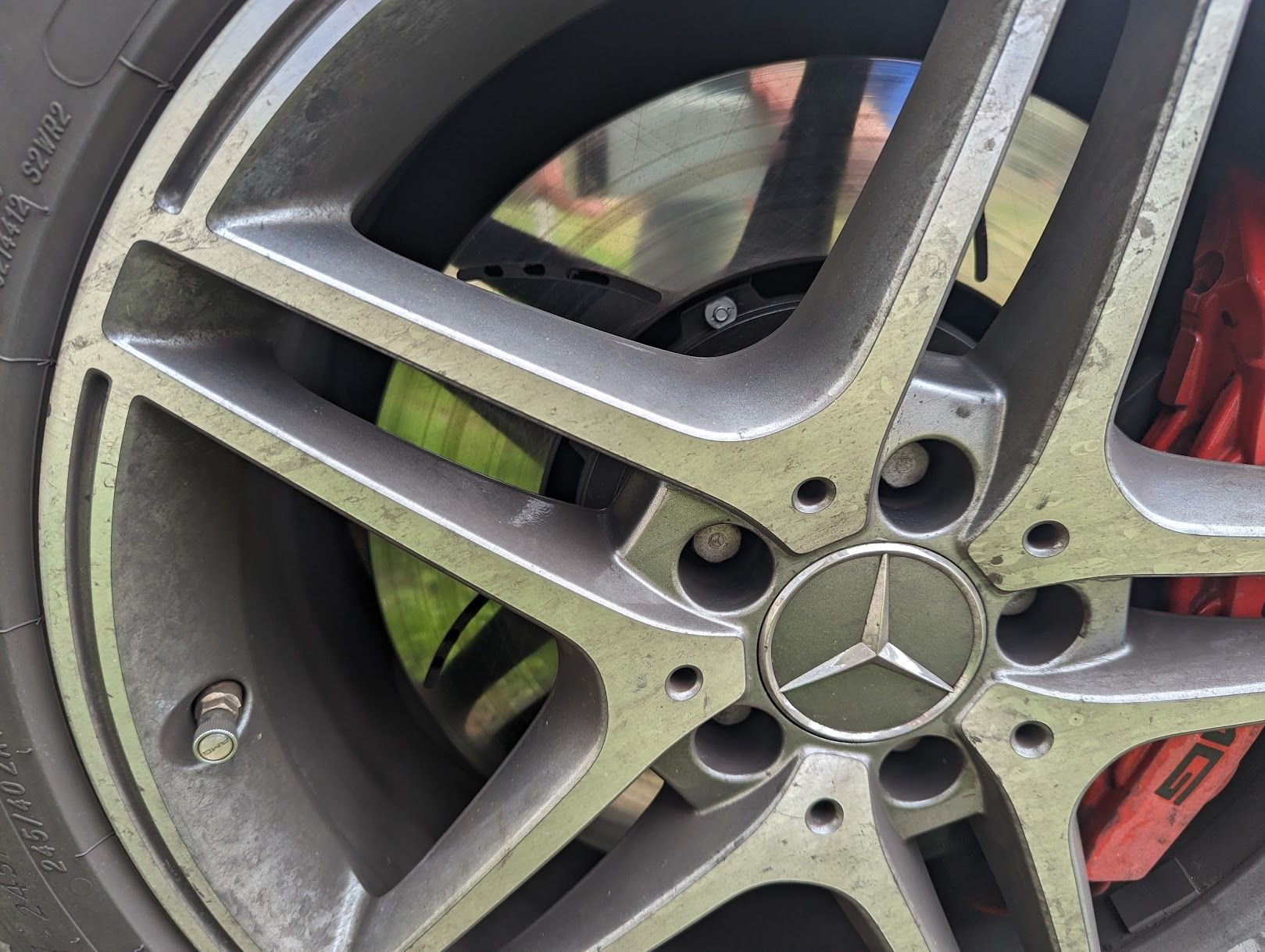

I bought the front and rear Racing Brake kit suggested in this thread and so far have been happy. They were installed/bedded by a reputable shop.
A few questions:
1) Is the above grooving normal? I didn't see anything like this on my old stock C63 rotors. I noticed that if I drive slowly these disappear, but if I go on a hard canyon run I see these.

What you are describing as grooving is just pad material deposits STARTING to form on the rotor surface and is perfectly normal. Your rotors still have the cross-hatch machining marks visible so they are still obviously new - but there are no grooves and your your brakes are not yet fully bedded in. It will happen in good time.
