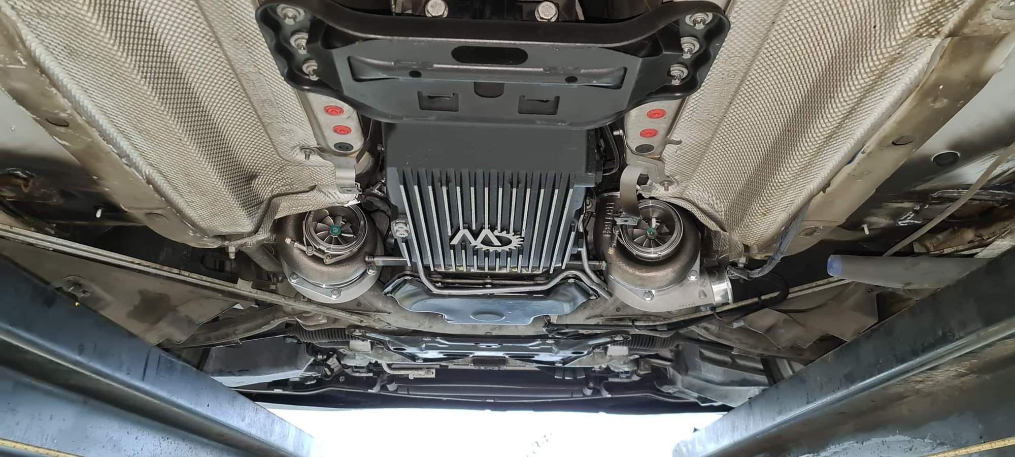

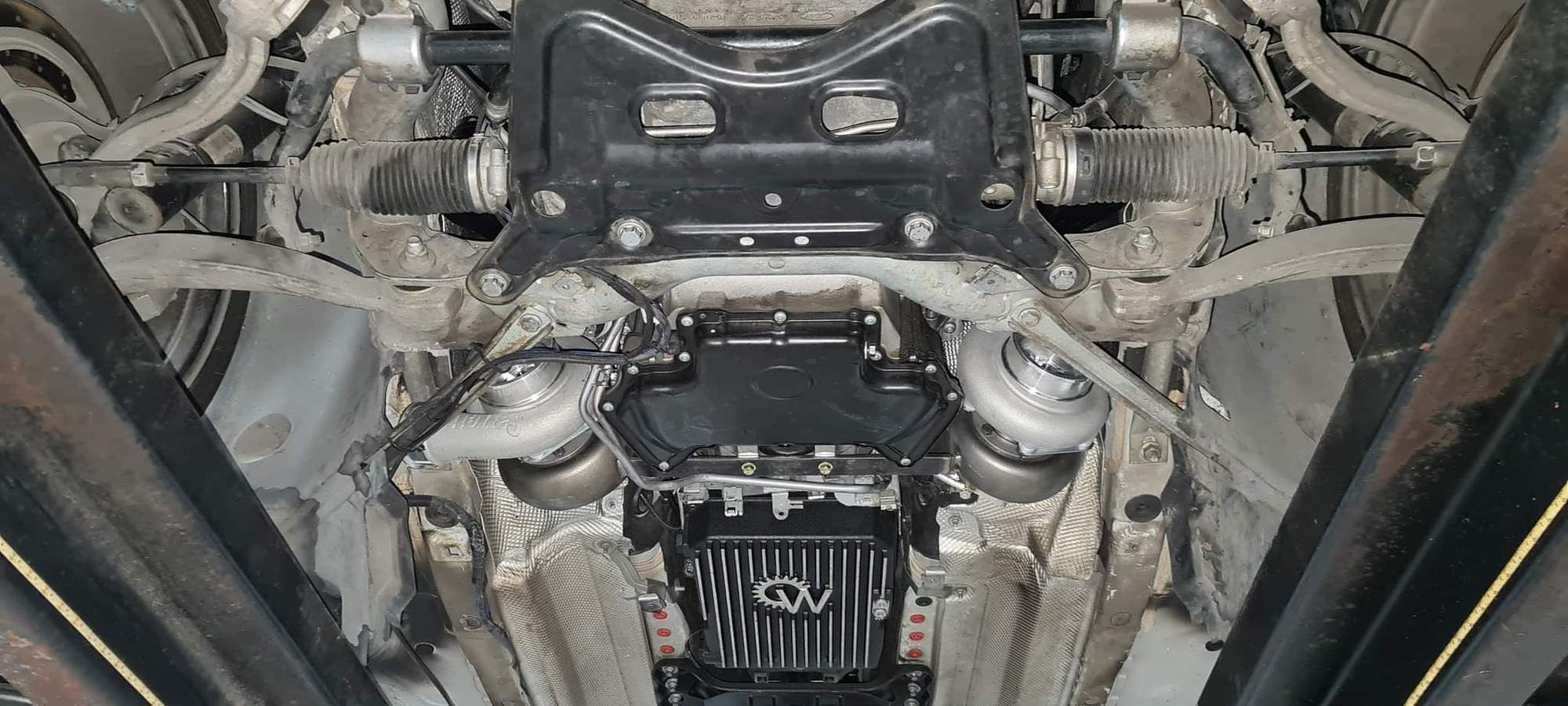

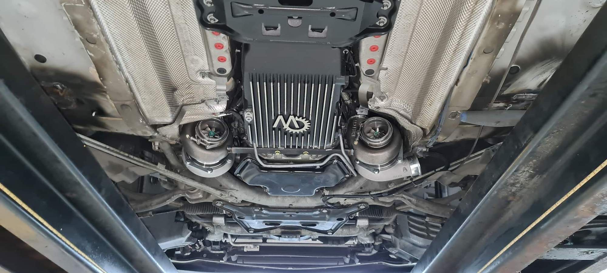

Fitment is nearly there just a couple of things to sort out but it's getting there

Nice.
I´ve seen the space also(where turbo´s can sit)
What intake are you planning to use? (if boosting some serious numbers)

Aug 18, 2022 | 08:42 AM
We are making an custom intake
I will post pics soon

Aug 18, 2022 | 09:45 AM
That looks amazing Brad. what power levels your aiming for?
Reply 1
Aug 18, 2022 | 10:54 AM
Quote: That looks amazing Brad. what power levels your aiming for?
Some will tell you the power doesn't matter bc dynos are subjective and all that matters is your track time 😂
I'm not on that side
I'm guessing 800+ easy as we've seen 700s with SC and turbo is more efficient. Tuning will be interesting

Aug 18, 2022 | 11:09 AM
Definitely curious to see the finished product.
I do not envy the creative work that will be required to finish this but its nice to see a front mount setup without it looking like a complete hacked monstrosity.
Still waiting for someone to fab a procharger setup for ****s and giggles too.

Aug 18, 2022 | 01:00 PM
1400whp for the start once the current planned configuration is running well are my estimates

Aug 18, 2022 | 06:41 PM
My first aim is 1000wkw which equates to 1400whp but then turbos will be maxed then I'll be looking at twin G42 compact turbos 1250hp each rated and then shoot for 1800hp lets see but still a long way off
I have enough fuel supply for 2500hp

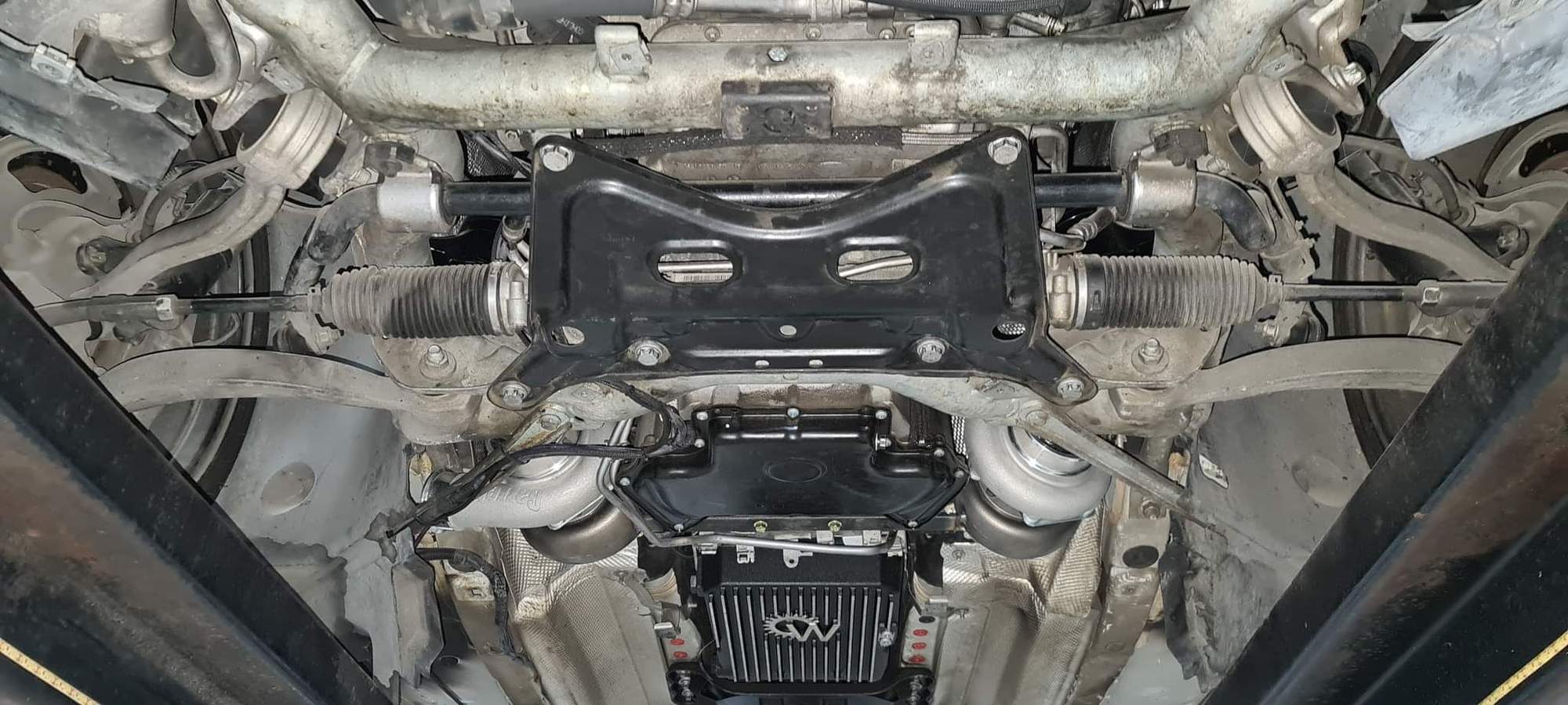

Aug 18, 2022 | 07:38 PM
Im surprised they didn't fab a custom front subframe to give a little more room. Good job squeezing them in there!
Reply 0
Aug 18, 2022 | 08:04 PM
Quote: Im surprised they didn't fab a custom front subframe to give a little more room. Good job squeezing them in there!
Thats not the final fitment we do have some space for filters
I wanted to keep it as stock as possible

Aug 18, 2022 | 10:10 PM
Quote: My first aim is 1000wkw which equates to 1400whp but then turbos will be maxed then I'll be looking at twin G42 compact turbos 1250hp each rated and then shoot for 1800hp lets see but still a long way off
What is going to be done to the engine and more Importantly.... What kind of transmission are you looking at

Aug 18, 2022 | 10:22 PM
We will be running TH400
Motor is built with darton sleeves , Italian RFP Platinum series pistons and rods , fire ringed , SLS black series crank head studs ported heads

Aug 19, 2022 | 12:59 AM
Nice.
Oem intake can´t take much boost thereby i asked, looking forward to pics =)

Aug 19, 2022 | 04:31 PM
I'd recommend building a small manifold/reservoir for the oil drains instead of just lines to a pump. Also, don't skimp on the scavenge pump(s). You can also go wtih oil-less/water-less Comp turbos which are a decent idea for under car setups like this.
You can zoom in to see the reservoirs on this setup
