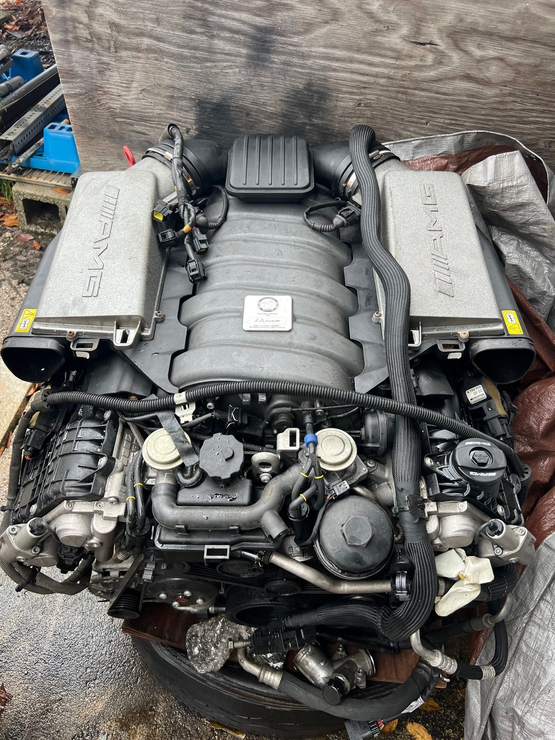

2000 miles after having my 507 tuned by a well known tuner, it ended up blowing a rod. Will be tearing apart the engine to see complete damage and if anyone wants to purchase a part I’d be more than happy to give price and ship. Not often do you come by a 507 engine that’s parted, if ever.

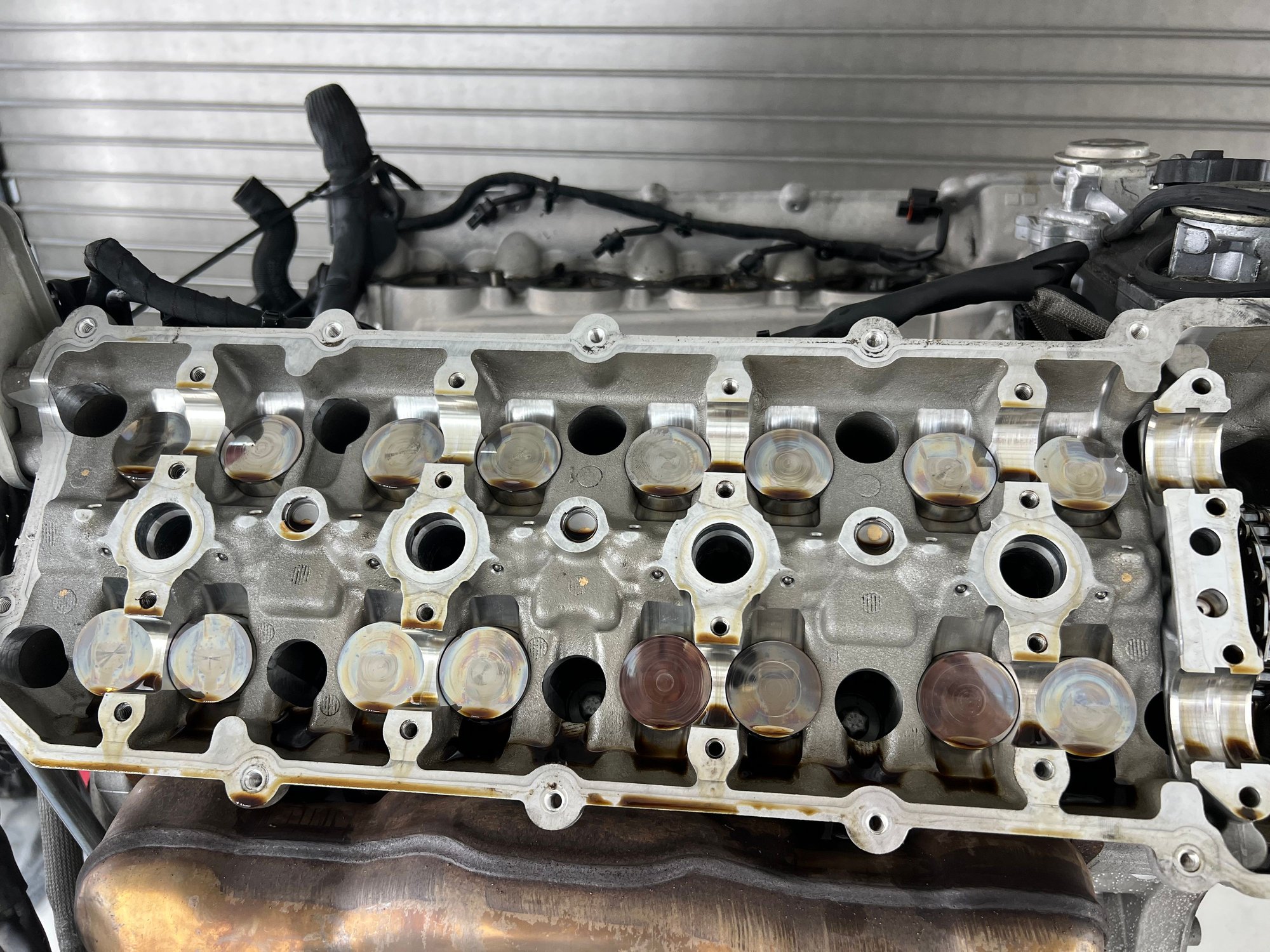

Slowly tearing the engine apart, how do you guys think it looks inside?

engine looks low miles and well maintained

Already tore pretty much the whole engine apart, just need to get the internals out. I wanted to tear it apart to see it’s true condition inside.

Also, the top end looks quite good, apparently that De Giuseppe family has a couple folks there.
