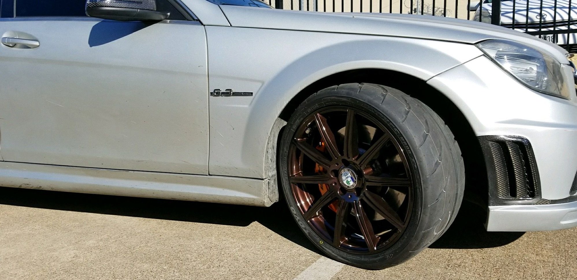

I'll dig up pics, pretty sure I posted some a while back of it. Car is not lowered, as this screws up the suspension geometry and would bottom out everywhere. 18" or 19" what is the difference? just copy of the offset. If you go full lock you will get extremely minor rub on the inside of the frame, never heard or felt in the car. Only know from seeing it while on the lift.

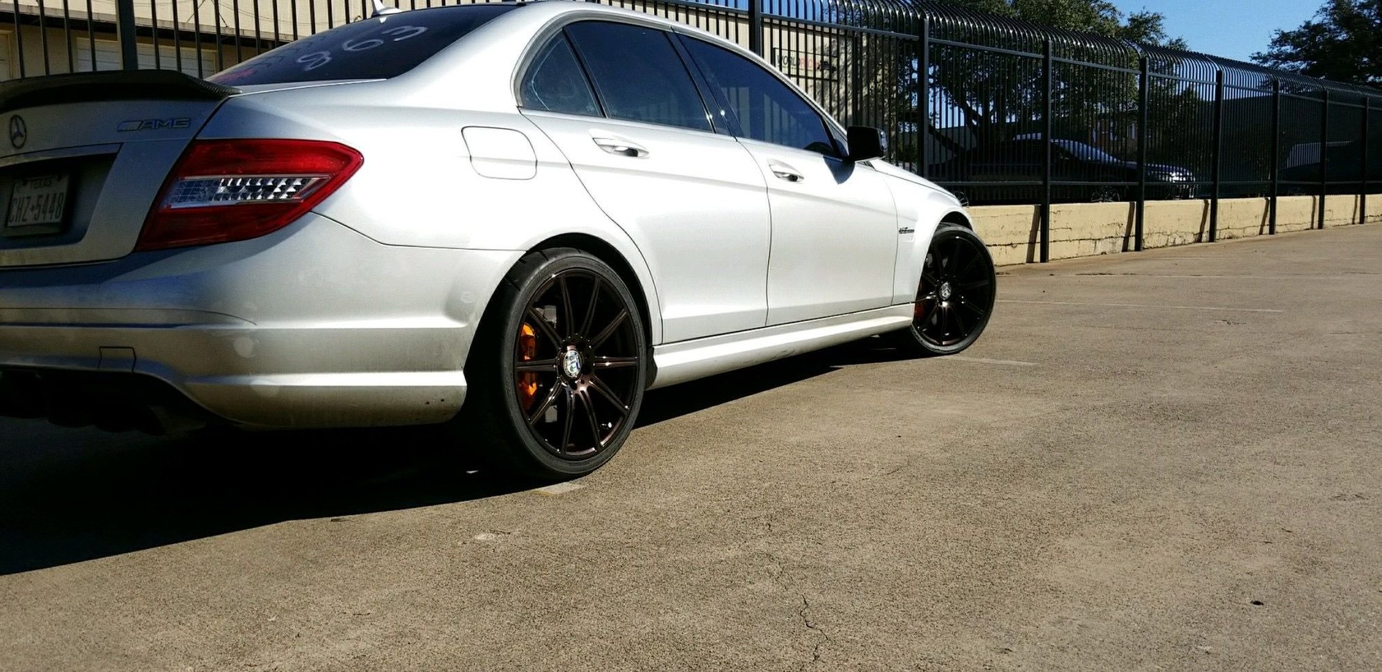

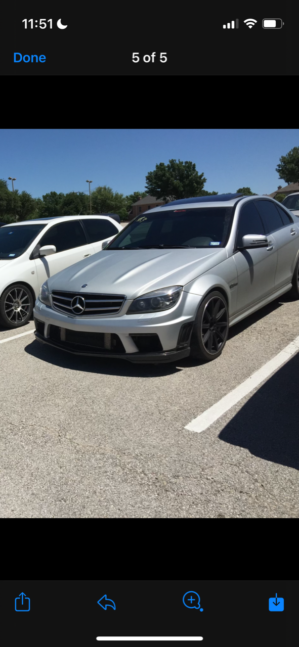

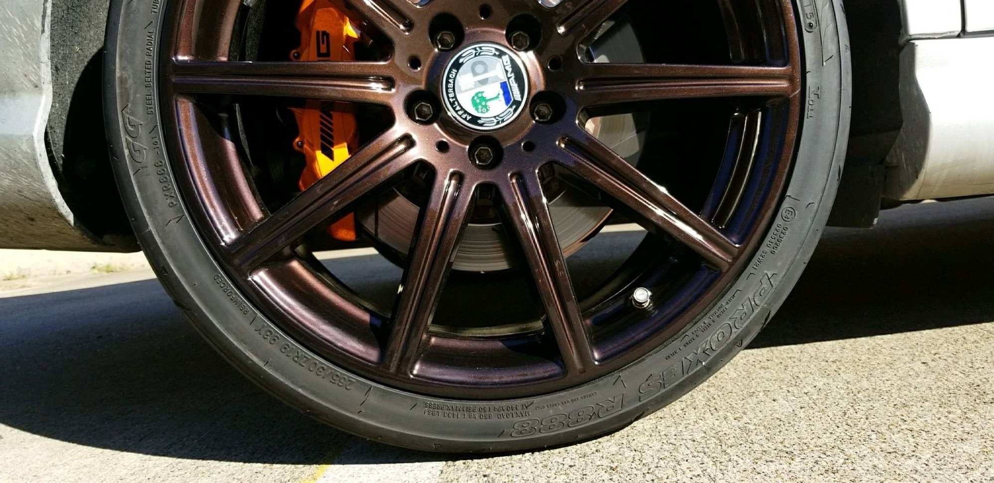

Did some digging... hard to find good pictures. Lets see how these come out on here.
So, if I'm reading right, you have same size 265/30x19 tires F&R on 8.5/ET35 front and 9.5/ET40 rear E63 W211 wheels.
Or are they later E63 wheels on 9"/ET35 front and 9.5"/ET52
