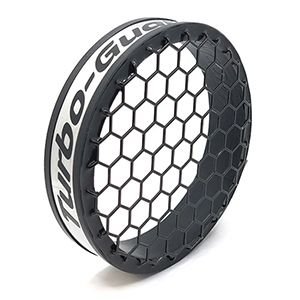

No filters really needed on a nice sunny weekend driver, I did add turbo mesh screens to keep large debris out tho.
