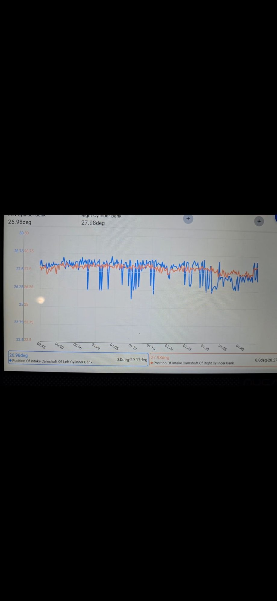

Finally had some time the last few nights to gather some data. Slow progress, still not sure if I have found anything.
  • Got my picoscope working, compared cam+crank signals from both intake and exhaust from bank 1 to bank 2: Nothing seems out of the ordinary, not an expert at interpreting the data but both sides seem to match.
  • Inspected wiring, started cutting open sheathing, nothing jumping out yet. Some of my injectors have cracks where the wires entered the injector plug. Applied liquid electrical tape, no change.
  • Got out my scanner and started inspecting cam position data at idle and at 1500RPM. What is interesting is what my scanner is showing as "Intake camshaft of left cylinder bank" seems to be all over the place (blue line) and completely out of control. This would be a smoking gun if it was on bank one, where the misfires are, or what I would consider to be the "right cylinder bank". Unless this Chinese scanner has the banks backwards?
Why is the cam position all over the place on the "left cyinder bank" when all of my misfires are on bank 1?
Still keep coming back to an issue with the adjusters somehow, even though I've gone through them like twice now. Might even swap the adjusters bank to bank to see if possibly one component on the adjuster is bad.
The saga continues....

Is it possible that the intake adjuster isn't getting oil pressure, and ipso facto can't advance or retard timing as necessary?

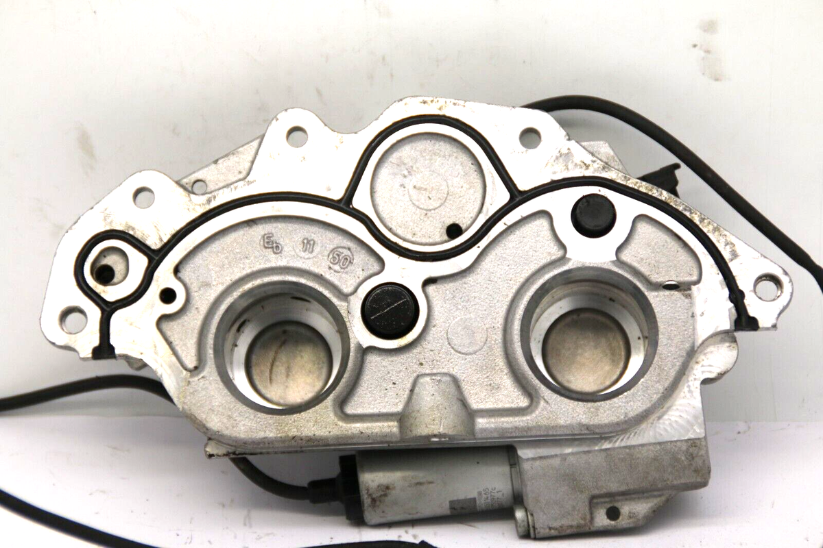

Just watched the newest video last night. Was hoping to see a nice conclusive effort to this AMG saga, but this sort of thing is all part of the fun.
Apologies if I missed it, but the cam adjuster cover has not been replaced right? Your issue persists on bank 1 regardless of which cam adjusters are used. The issue is also resolved when the cam adjuster solenoid is not connected suggesting that the top end if probably fine. So if the adjusters themselves aren't the issue and the entire bank runs perfect with the solenoid unplugged, it would lead me to believe theres an issue within the cam adjuster cover. The cover contains oil passages and sealing interfaces to route pressurized oil via the solenoid. Given that the issue only arises above 1500rpm, there could be an issue within the cam adjuster cover related to oil pressure, sealing, or routing.

I picked up a spare engine harness just to have it about 9 months ago. After hours of checking the harness, peeling back insulation, checking for oil etc. and finding nothing, I finally said "screw it" and installed the spare engine harness. Pretty tight space while leaving my original harness in place, but I got it done.
You guessed it, car still does the EXACT same thing. So it appears it is not a wiring/harness issue either.
At this point I think im going to pull the cams on this side and inspect bearing caps/ clearances and see if anything jumps out.

Just to clarify.
You are fully right in conclusively ruling out the cam adjusters themselves since you've rebuilt them at least twice and have also swapped them between banks with no change in the misfire.
I'm referring to the housing that the cam adjusters and the solenoid interface with. See pic below. Part number 1560500118
My theory is that some sort of oil passage within this housing may be damaged or obstructed. Which may be why the car runs perfect with the solenoid unplugged, but when plugged in the issue arises.
Your theory on excessive oil pressure bleedoff due to incorrect clearances is great, but I figured this is a relatively inexpensive part that could save you $ before you start digging deeper into the cams or head.

Ahhh, I see. yes, I had this same theory about a year ago. I replaced the housing with a good used one, including cam sensors and solenoids, installed, and no change.
No easy fix on this thing
