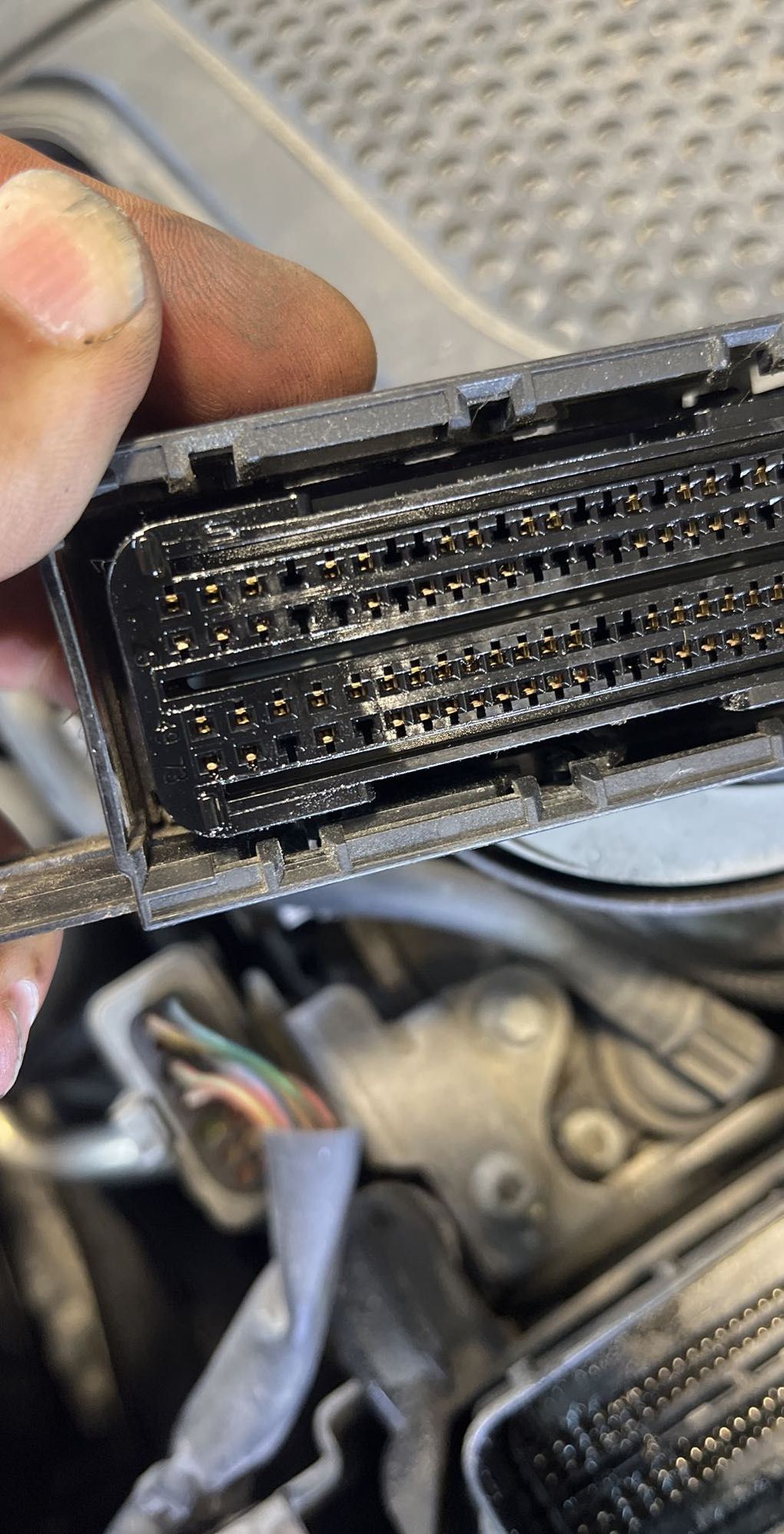

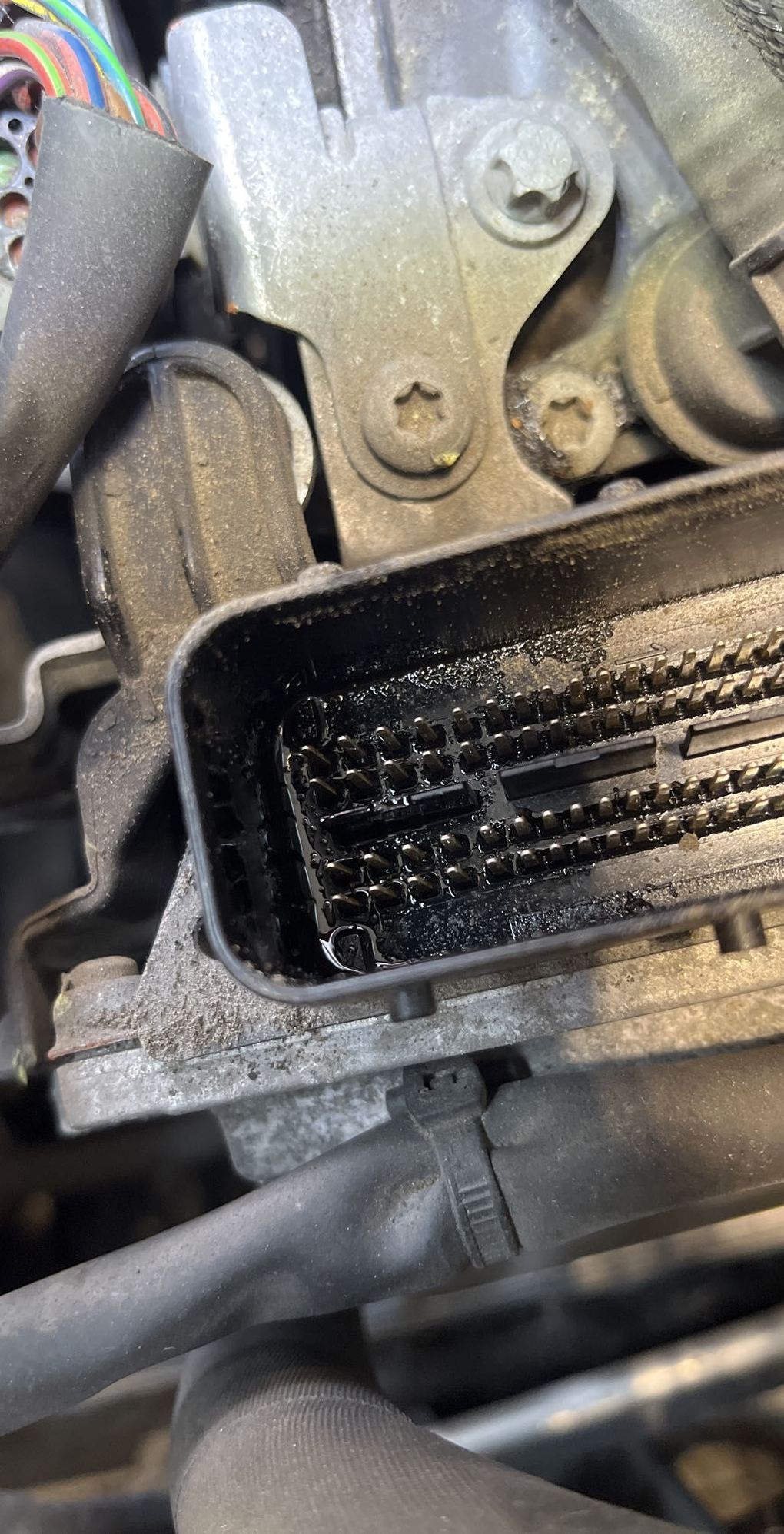

Also , did you check for engine harness oil contamination ? just remove ur ECU engine harness from the computer and check for oil inside ... i saw a lot of these on mutiple mercedes engine ! This can cause a lot of strange issues !
I did check the main connectors at the ECU. They were clean and dry. The only oil I have seen in my harness is on some of the injector plugs, which seems to be somewhat normal on these cars, and doesn't cause issues from what I have seen.

yes i saw a lot of time oil in injectors plugs. its a ''normal'' condition for these motors
