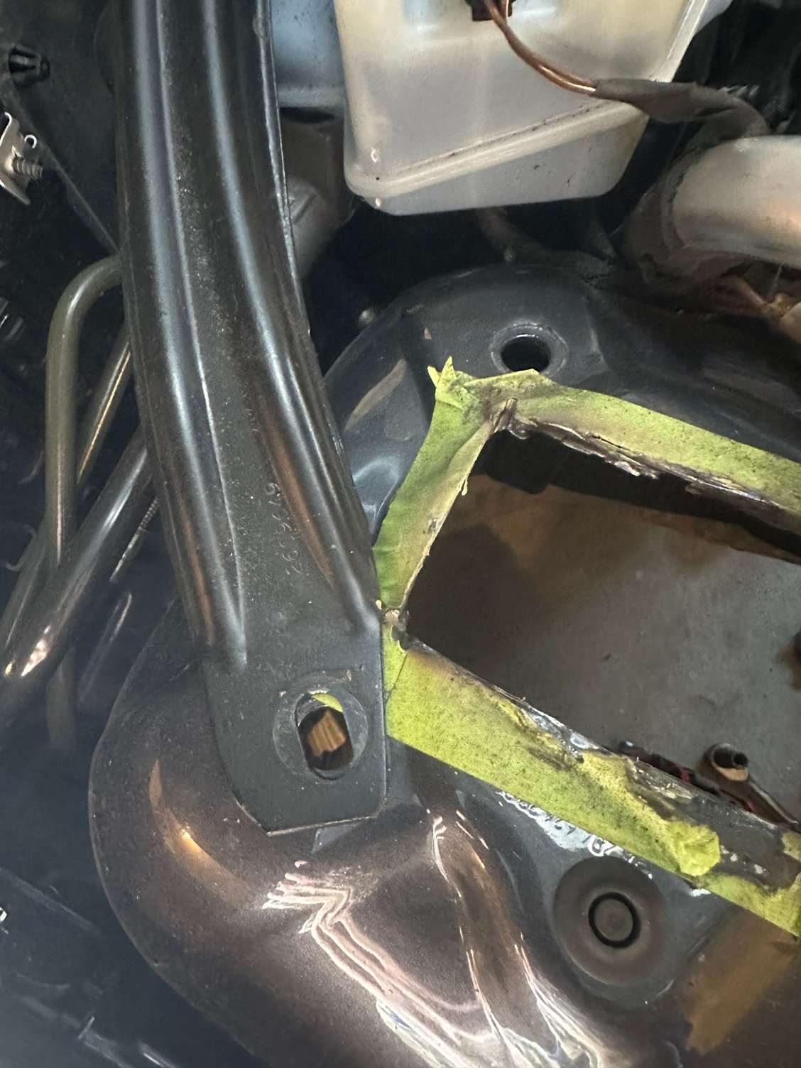

I'm wondering how it is that hard to set. As described above you pick one extreme and see where you are at for camber. Say you are at -3.5 and you want -2 or whatever you dial it back a given amount 1/4" and recheck. If the new measurement is now -3 then do 1/2" and recheck. You should be in the ballpark. It's not totally linear but it is close... definitely should have it dialed in after 4-5 times. Then you aren't moving it unless you are changing it for ride height changes or for a certain track. You could mark your tops to the setting so you are simply dropping and moving to your marks each time. Or just cut the tops it doesn't take long...here's a pic of mine just sand it after and a quick paint and done.

Exactly. We did exactly that adjusted minor and marked every time no matter what it always threw it off the degree to the red or green and threw off the other side as well. As far as cutting, that looks hideous no offense, I would NEVER do that to my car.

it looks fine now haha you paint it and finish it... it's what you have to do if you want to have adjustable camber on the quick.

u need to cut openings to adjust the hats
everyone knows this
ur shops may not be w204 OG’s
so either cut it up or get milked bc once u cut it up u will never have to drop the suspension down or whatever their doing.
