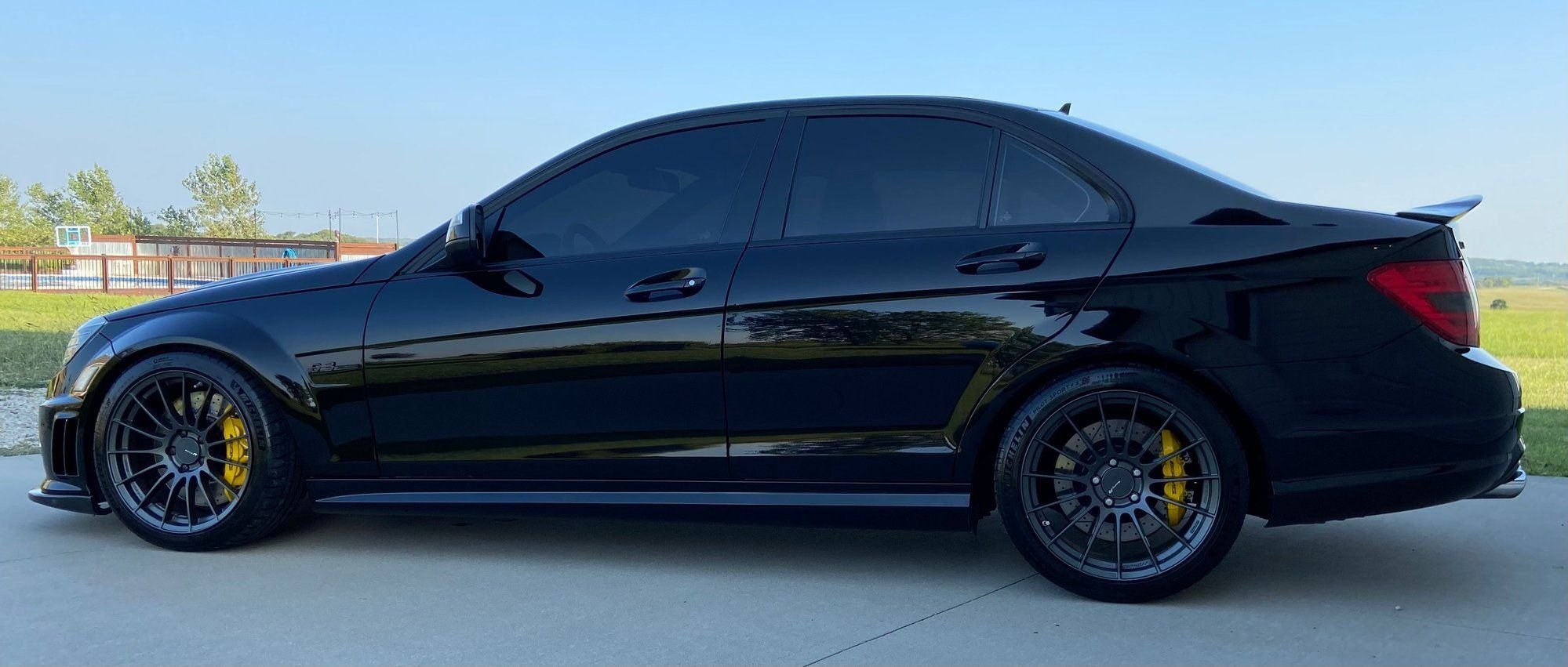

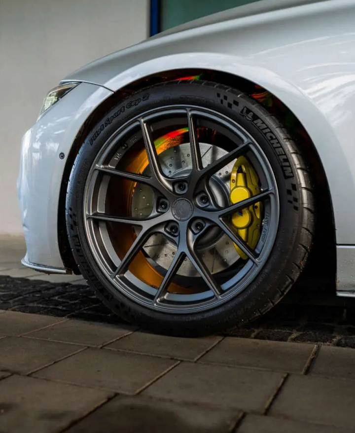

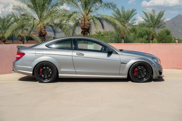

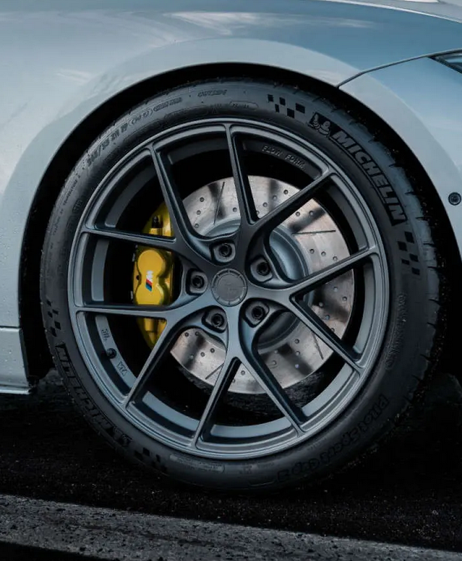

Hey there, been looking for some 19" Wheel & Tire setups on the C63 204 that look like the pictures.
Does anyone of you drive something similar to this? If yes, which wheelsizes and tires sizes are you running?
Thanks!

If I'm reading those rears right they say 305/35/19 and there's just no way without added rear flares.
Can't read the fronts, but we're in worse shape there, so highly doubtful without some decent fender work.
