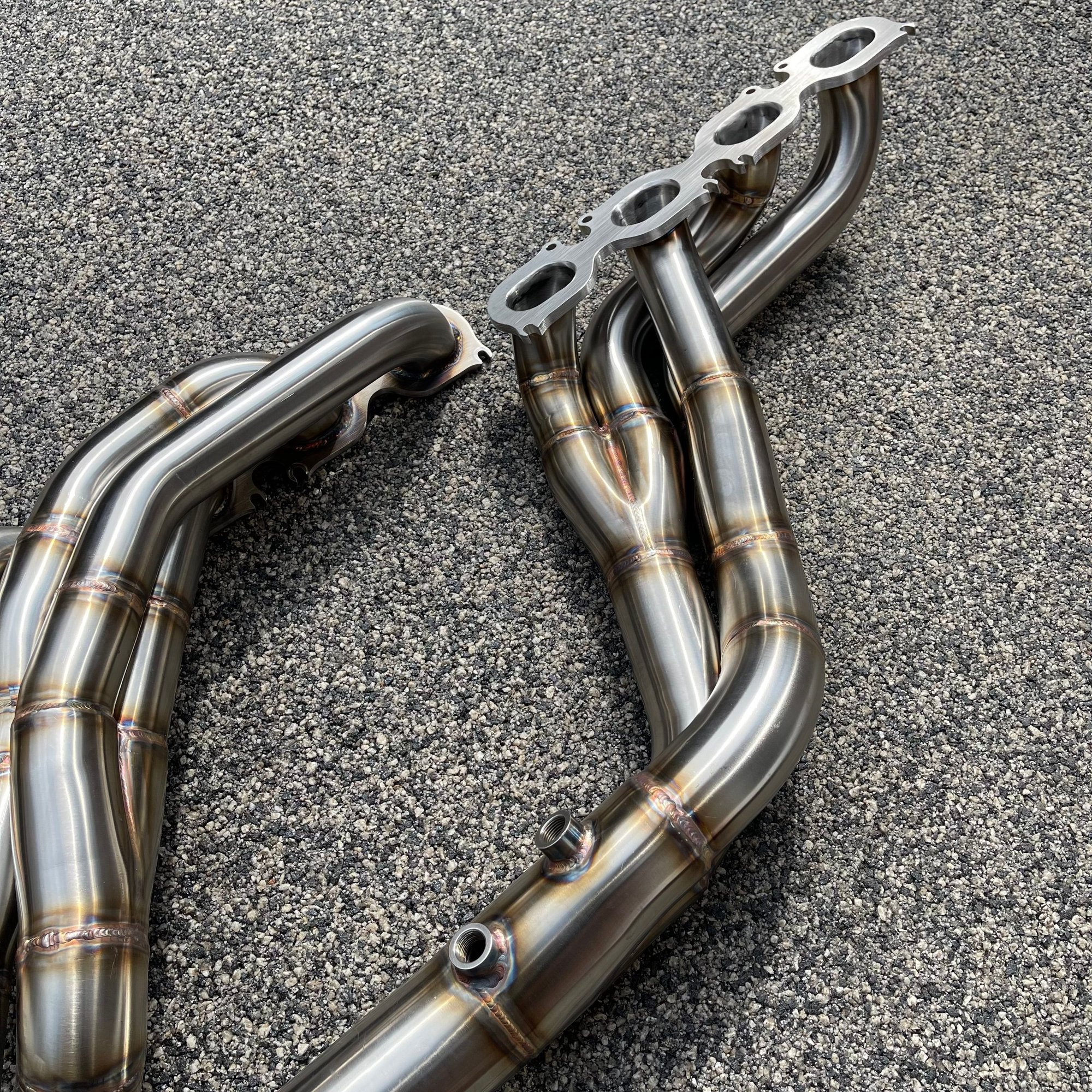

MBH and ARH make the most power, I have never seen anyone in the last 12 years with Renntech headers make more power than those two.

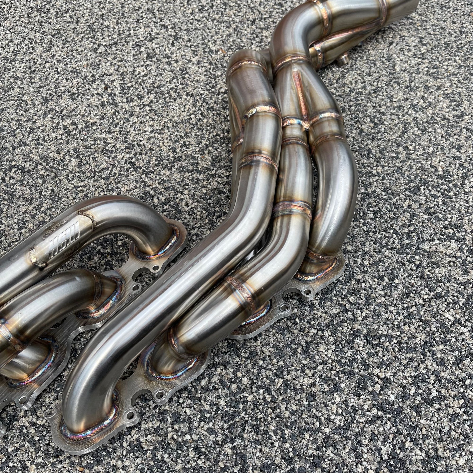

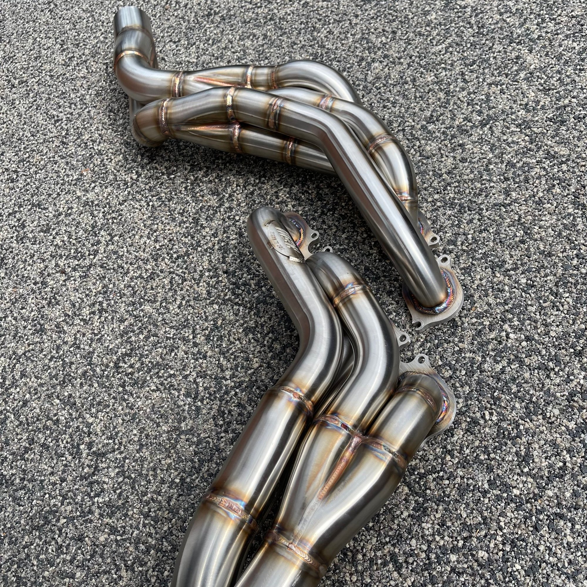

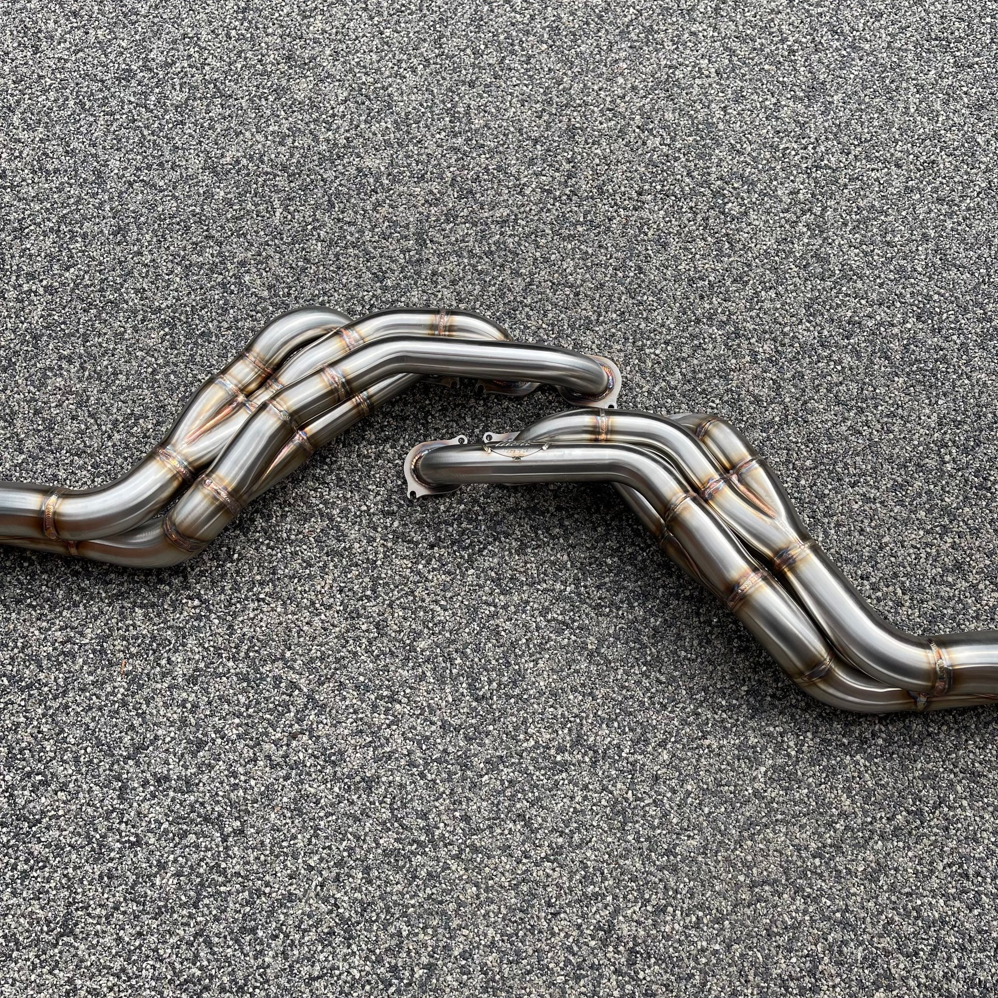

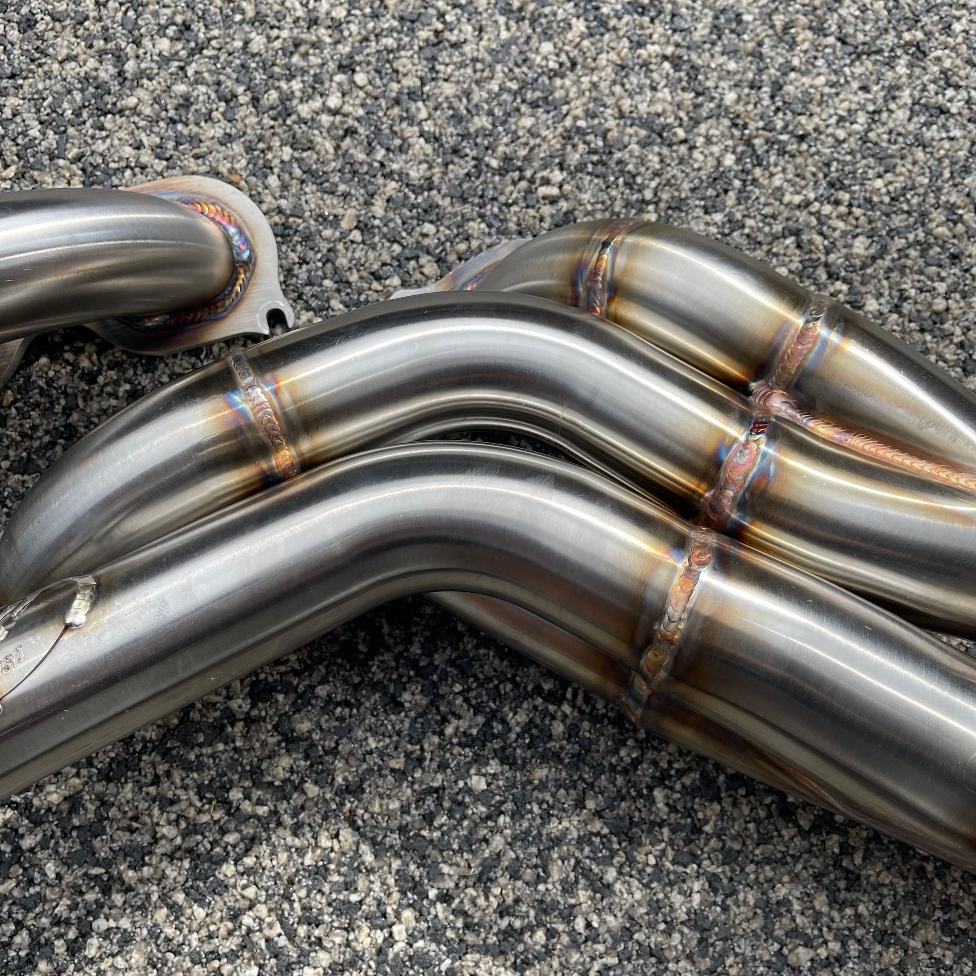

These are my MBH headers below, honestly get them or ARH and forget anything else.
