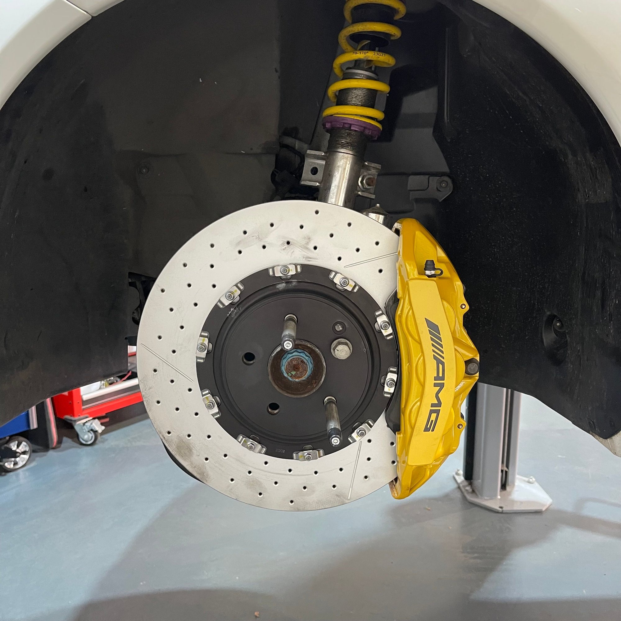

My best advice would be to go with 19” BBS but you will need to do a few things.
First let AR Motowerkz make you a custom set to fit the car perfectly but you will need to go to a 380mm front disc to fit 19” front wheels as the 390mm will not fit under 19” and 20” will ride awful.
You can buy 380mm front brembos that are exactly the same as the 390mm then fit a different brake caliper bracket. Thats what I did and the upside is they save 2kg a disc over the 390mm.
Also get rid of the stock KW suspension on the black series and fit KW clubsport with camber adjustable top mounts as you will need them.
Any wheel is possible you just need to have the money, time, knowledge and right people doing the work.

You won’t be able to fit 19” BBS wheels with 390mm due to the instep of the barrel, so if you want BBS you will have to get 380mm brembo discs same as the 390mm which are better anyway or have it ride awful on 20”.
I doubt you will get any 2 or 3 piece wheels to fit with 390mm discs.
Well, shoot. I may have to go to 20 inch wheels then. Because I don't want to start removing and replacing the OEM brakes and suspension. Thank you for the information. I didn't know that was going to be a deal stopper for 19s.
I would rather change front discs to the same disc but 380mm with all the benefits than run a 20” wheel and tyre with a lot of negatives.

I will second this... 20" tire selection is trash, wheels will bend much easier and ride much rougher with less sidewall as well. I'd downgrade to the 380 or peasant C63 360mm brake rotors before going to 20"
