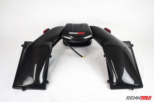

Or get this already....
https://store.renntechmercedes.com/p...63-amg-engines

4k lmfao

Originally Posted by Madcow554
4k lmfao
it's the only intake that has proven results over stock.
for $4k, the juice isn't worth the squeeze.
The 4k "squeeze" makes my eyes water...

they pop-up from time to time in aftermarket, just keep an eye out. I waited a year for a used one a while back

Originally Posted by wawy
looks nice - i know it.
yeah expensive - but no bad choice.
i would try to get a used.

If you've done everything else, I guess $4k for those last 15whp might be worth it.
