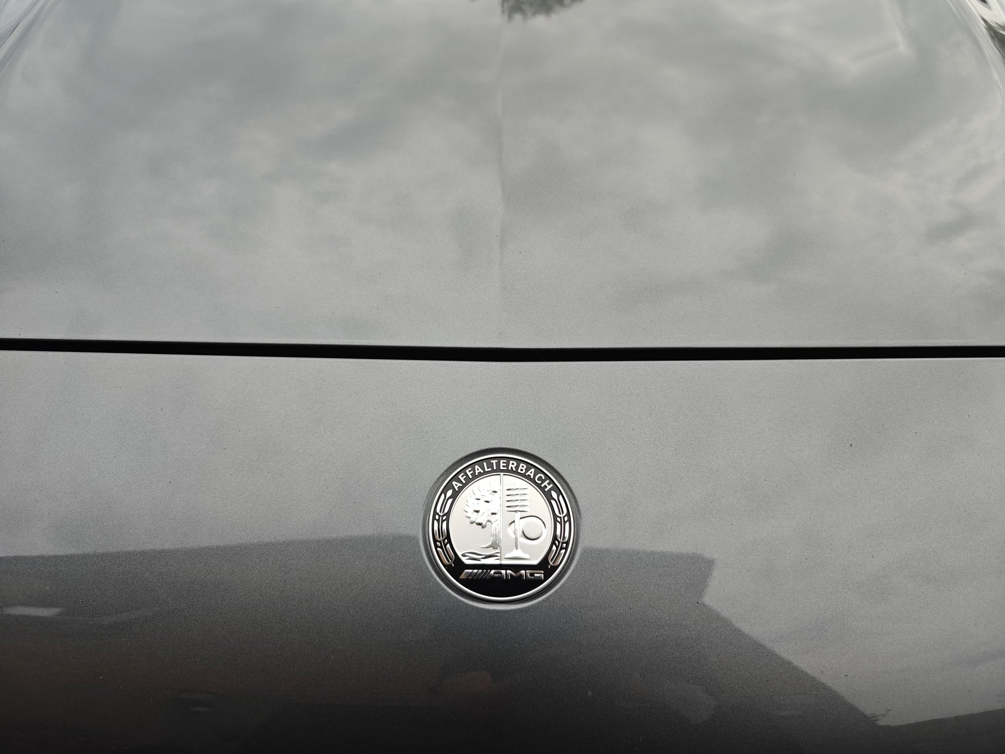

Just replaced my badge, tried prying but didn't feel right, was afraid I gonna scratch the paint, I did find a hole from the inside that a prying tool fitted, feeling around I did find the studs and did just tapped it so it lifted up so I could grab it from above.
I did have a crappy scope camera so I just lucky took a picture.
