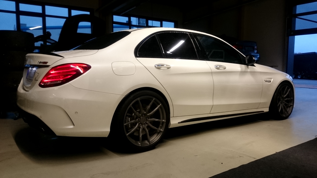

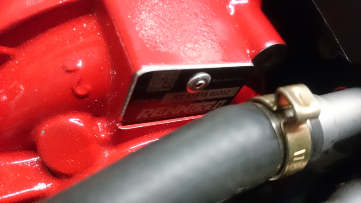

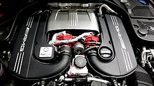

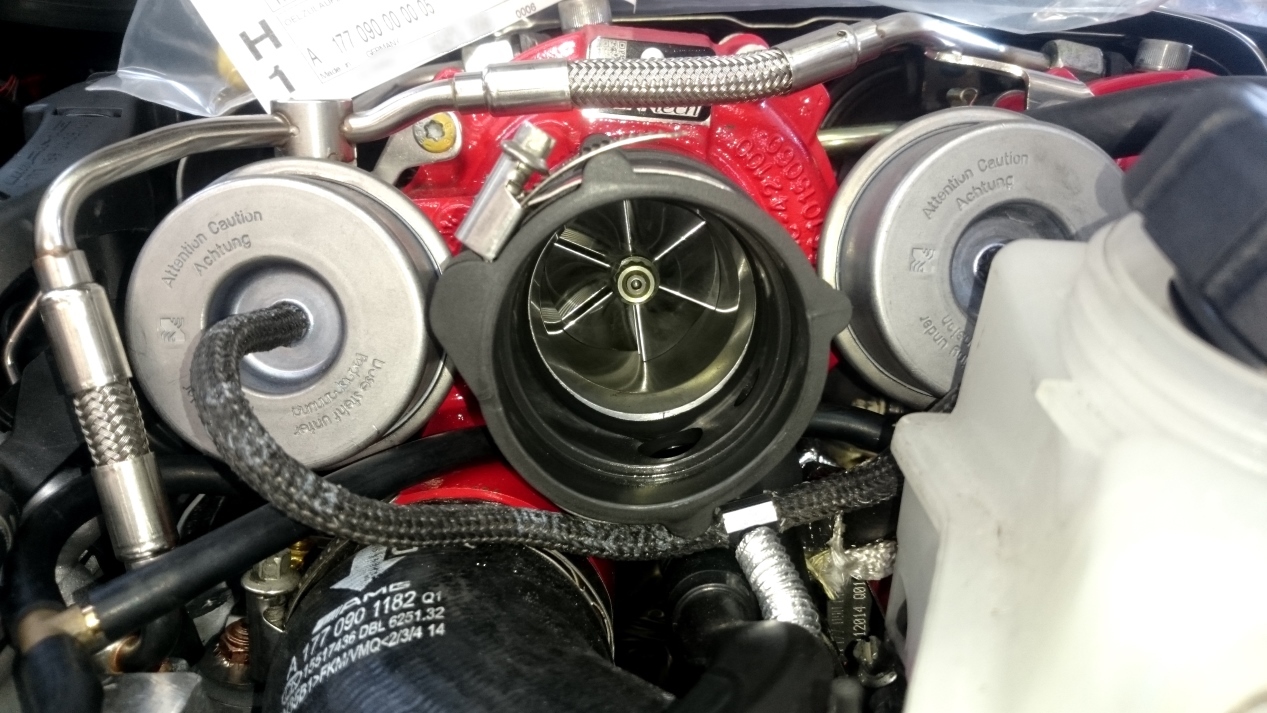

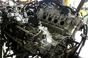

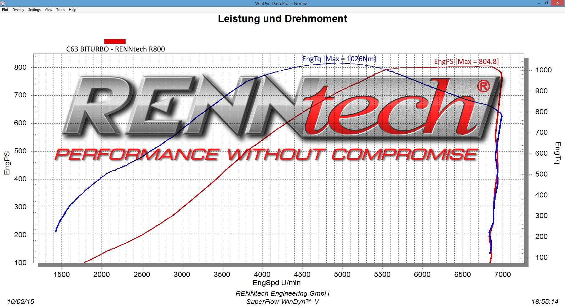

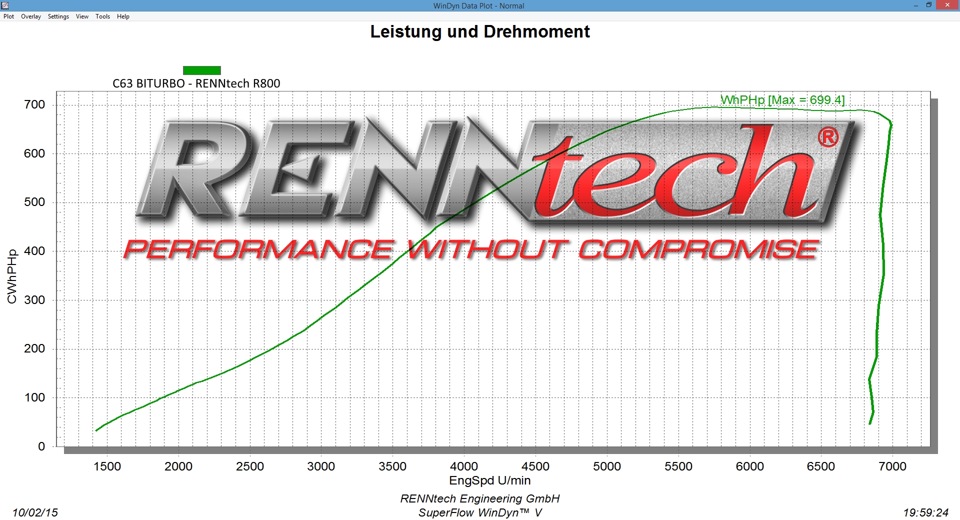

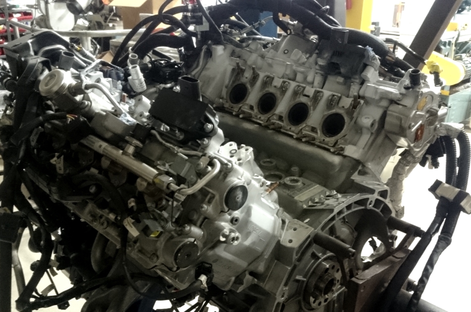

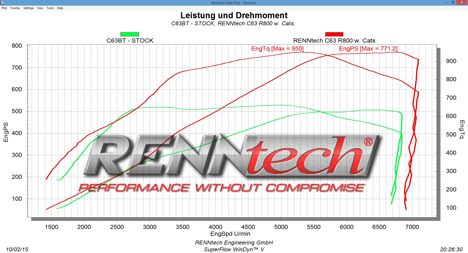

1. Car was / is run on PUMP FUEL which we get at the well known local Nuerburgring Gas station, 98 Octane RON (equivalent to 93 AKI). This station is just 200 meters away from our facility http://www.doettinger-hoehe.de/
2. Transmission is the well known MCT, this is stable as we all know, however it needs a reflash to hold the torque as the pressure on the clutch is not high enough from factory due to the fact that it is (electronically) prepared to only hold up to 700Nm stock while combined with the M157 the basically same hardware comes with 900Nm stock and i.e. in a heavy S Class already.
The transmission is a 722930 K 7 C 1000 type (which means the hardware can take 1000Nm)
3. Forged internals: in the make but nothing more we would say yet at his point.

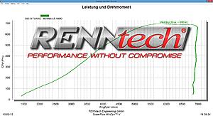

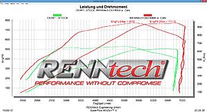

4. Losses: Depending on the setup, tires and so far with this car and the bigger tires we usually see around 70hp losses (approx 12-13%) on the SuperFlow 880 AWD during a stock run in 4th gear and around 100hp losses (approx 15%) at this power level. PS and Nm at CRANK are EWG/ECE corrected, in that specific case with a correction factor of 0.98.
Attached Thumbnails Renntech C63 biturbo 800+hp-2.jpg   Renntech C63 biturbo 800+hp-4.jpg   Renntech C63 biturbo 800+hp-5.jpg   Renntech C63 biturbo 800+hp-3.jpg   Renntech C63 biturbo 800+hp-1.jpg

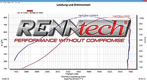

Turbos are good for up to 850hp but we are moving step by step now...
Attached Thumbnails Renntech C63 biturbo 800+hp-c63bt-renntech-r800-ps-tq.jpg   Renntech C63 biturbo 800+hp-c63bt-renntech-r800-whp.jpg

Old Oct 6, 2015 | 08:56 PM
CarHol's Avatar
Joined: Oct 2015
Posts: 42
MB
What consist of the Stage2+ turbos? Are they just wheel upgrades or completely new turbos?
These are new turbos, but we are also offering a milder turbo upgrade which is good up to 700hp at crank.
