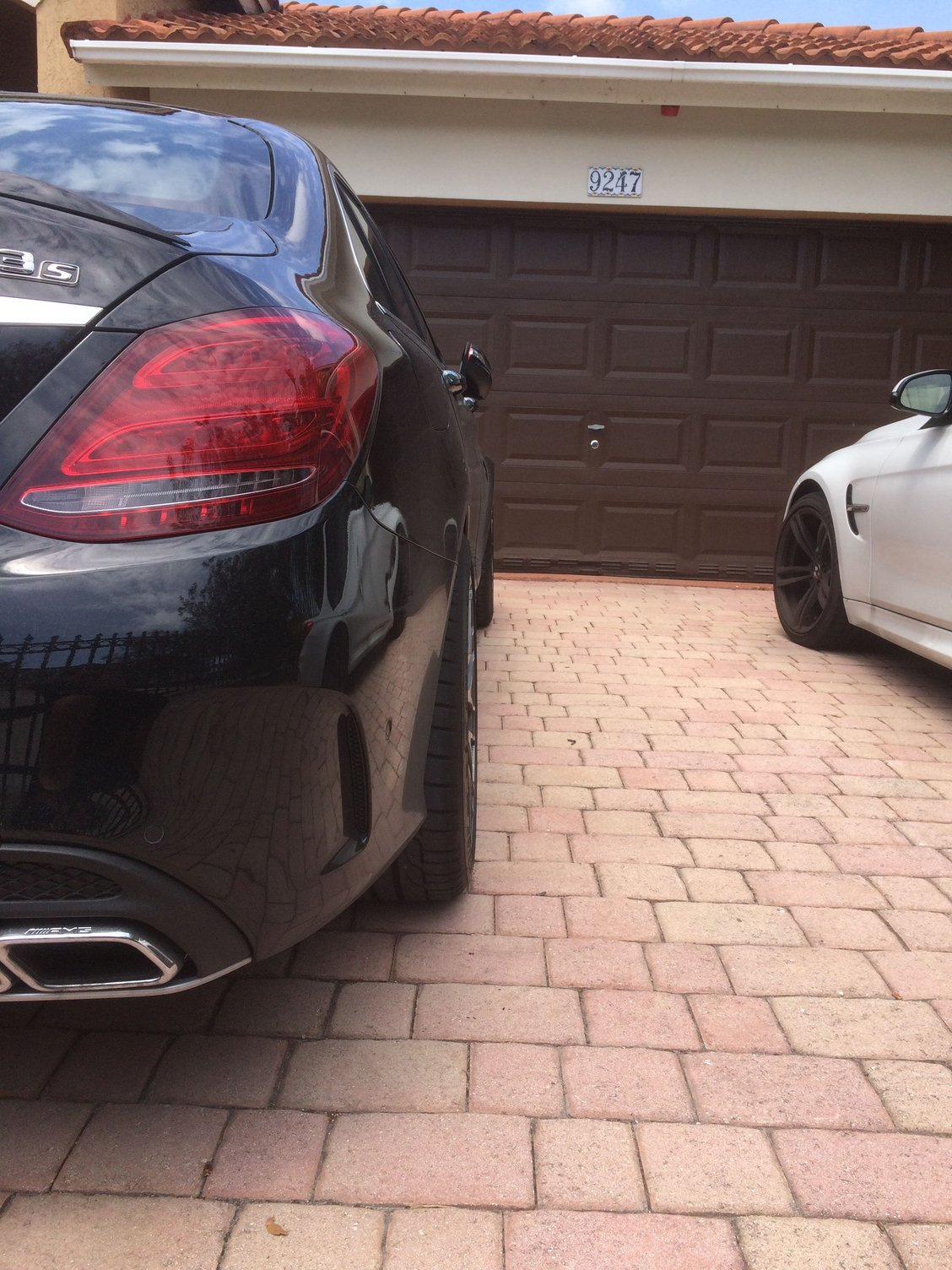

Just did; only in the back so far. I was not sure if they were going to fit or not due to how tall the hub is. But they did and I really like it.
looking good dude! what brand are those? also, how many mm, cuz the change is minimal!

You can go with any brand you want but they will need to be more than 12mm wide and they gotta be center hub spacers. Our cars got a very tall hub and anything below 12 mm will not mount flush. I used a regular ruler to check how tall the hub was and got almost 12mm.
I don't know if I will be doing the front as I like how the car looks now
Looks great!
Are you planning to lower it at all? how about the front?
