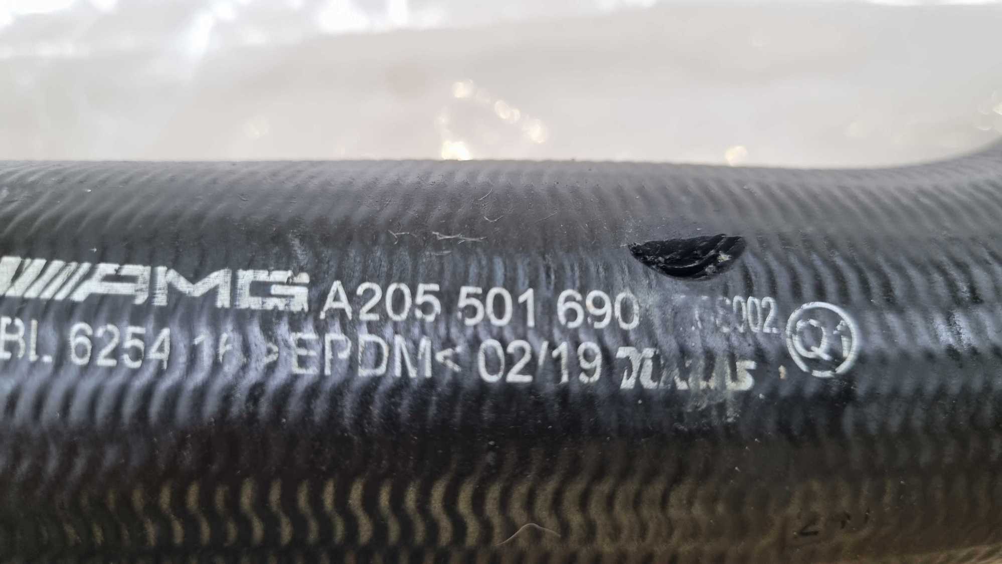

I have a 2019 C63S AMG (W205 Facelift model) that is now 3.5 years old (6 months out of warranty) and has done 16,000 miles. In terms of mechanical issues, over Christmas the car broke down with a coolant leak, which has just cost me £300+ to repair at an independent garage, who I trust, as the main dealers wanted £80+VAT just to tell me it was a coolant leak, then the cost of parts and labour to fix it!
The leak was caused by one of the lower hoses on the drivers side rubbing against the engine block. Mercedes have revised the part in an attempt to stop the hose failing, so they obviously know about the issue, but haven't been proactive in recalling vehicles, probably because it isn't safety related. So, be warned, this could happen to your C63S!
Here's my list of issues:
1. Coolant hose poorly designed and will eventually fail.
2. Random warning "Intelligent Light System inoperative", which usually clears the next time I use the car.
3. Starter battery critical warnings. This happens from time to time when the car is stored in my garage (it isn't driven every day), but always happens when I clean the interior of the car, requiring the doors to be open and interior lights on for 20 minutes or so. Never had such poor battery usage on any other car!
4. VERY squeaky brakes. Tried everything to resolve, even the main dealers (under warranty), but to no avail.
5. Windscreen wipers seem to be very flimsy compared to other cars I've owned.
5. Wind noise from door windows when travelling at higher speeds.
6. Occasional rattle from the dashboard, which I've been unable to locate or even determine why/when it happens.
7. Like others, I see debris collecting inside the front bumper but can usually get it out with a vacuum and a little effort, so not too much of a problem.

Could you show us a picture as to where it rubs? You say the hose rubs on the driver's side engine. But you're in the UK, so it's on the right side of the car.
Hi, I don't have any photos of the hose in place. The mechanic who found the issue and replaced the hose explained to me that the hose was located lower down on the drivers side of the car. Yes, I'm in the UK, so when stood at the front looking at the car, the driver is on the left and given the mechanics description, I assume the hose was also on the left of the engine, again, while looking at the engine with the bonnet (hood) open and facing the car.
When I first noticed the coolant leak, using a torch to attempt to find the issue, I did notice there was more coolant pooling at the left (looking at the car from the front - drivers side) on top of the plastic cover under the car, when looking down through the engine bay, so it fits in with what I could see.
While the affected hose has been re-designed by Mercedes to include a protective sleeve, or a sleeve that stops the hose loosing its shape (I'm not sure of exactly the intention), I don't see any posts from C63S W205 owners reporting this issue (apart from me)! Maybe I was just unlucky, but even so, I'm still pretty annoyed by it!
Thanks for posting your experience and the heads up. Did you ever have a coolant smell when this leak was going on?
I didn't notice a coolant small when the leak first occurred while driving on the motorway, I got a low coolant warning.
there was a slight smell the following day when I opened the bonnet (hood) to top it up and could see coolant on the floor under the car.
