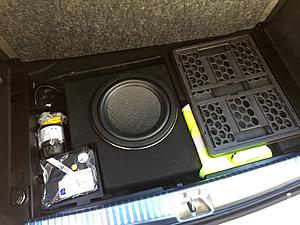

Added a sub to my estate, works a treat!
Burmeister sound system in C Coupe. Terribly crappy?!-amg-20sub_zpsppxorsxv.jpg

What sub is that?

It's a Kenwood 1400W Flat Sub - KFC-WPS1200F. Man does it sound awesome!

Thanks for that. Do you know how it connects to the cars system? Thanks

Hey mate, no worries! I got it installed by car audio place in Blacktown - http://xtremecaraudio.com.au/
It was just under $2k

Just so you guys know I have the wagon so not sure if under the shelf in the boot is exactly the same in the sedan/coupe?
I did need to leave my car there which wasn't the best but it took from Monday- Wednesday as they need to create a mold for the sub box and let it dry etc.
