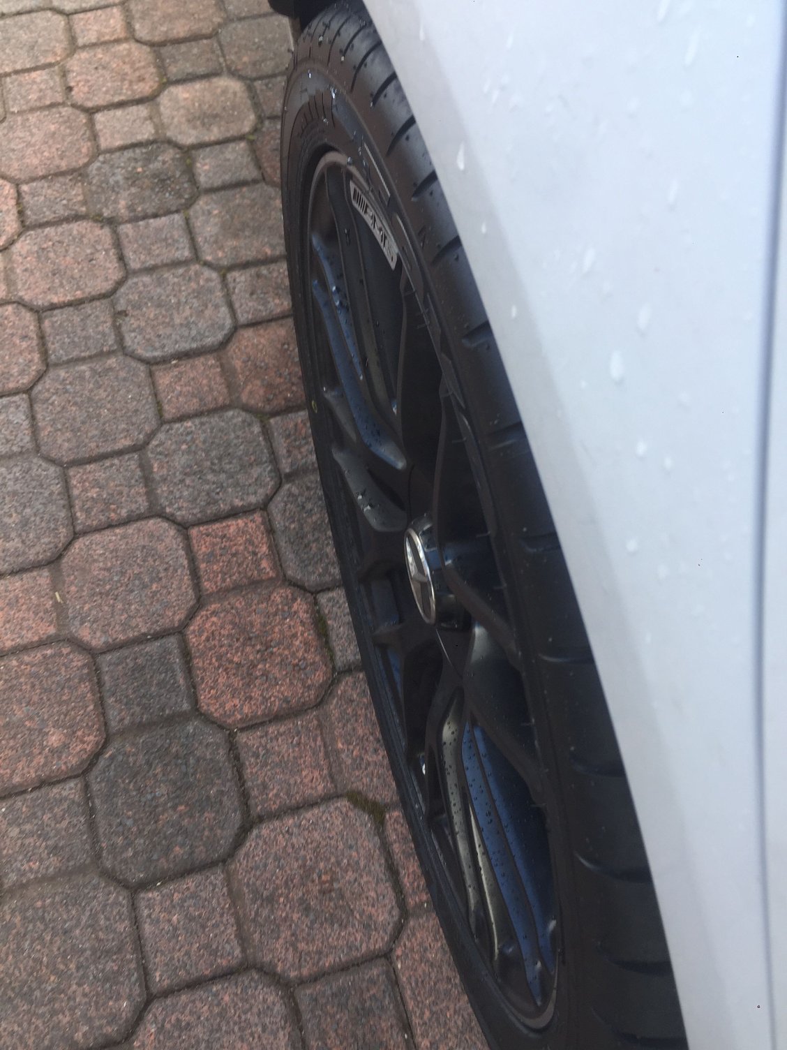

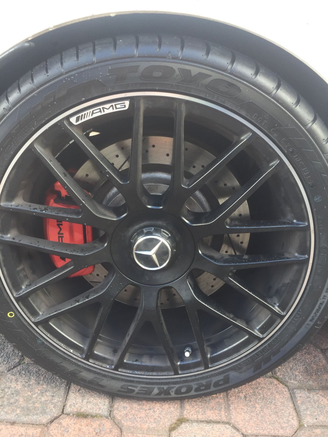

just got my c63s sedan on a set of new rubber. Thought the 295 30 would be quite aggressive but it fitted ok. No rubbing noticed so far after a day of driving and yet to find out how much grip/how confident that i can accelerate (factory michellin 265 is certainly way too narrow for the power of the c63s).

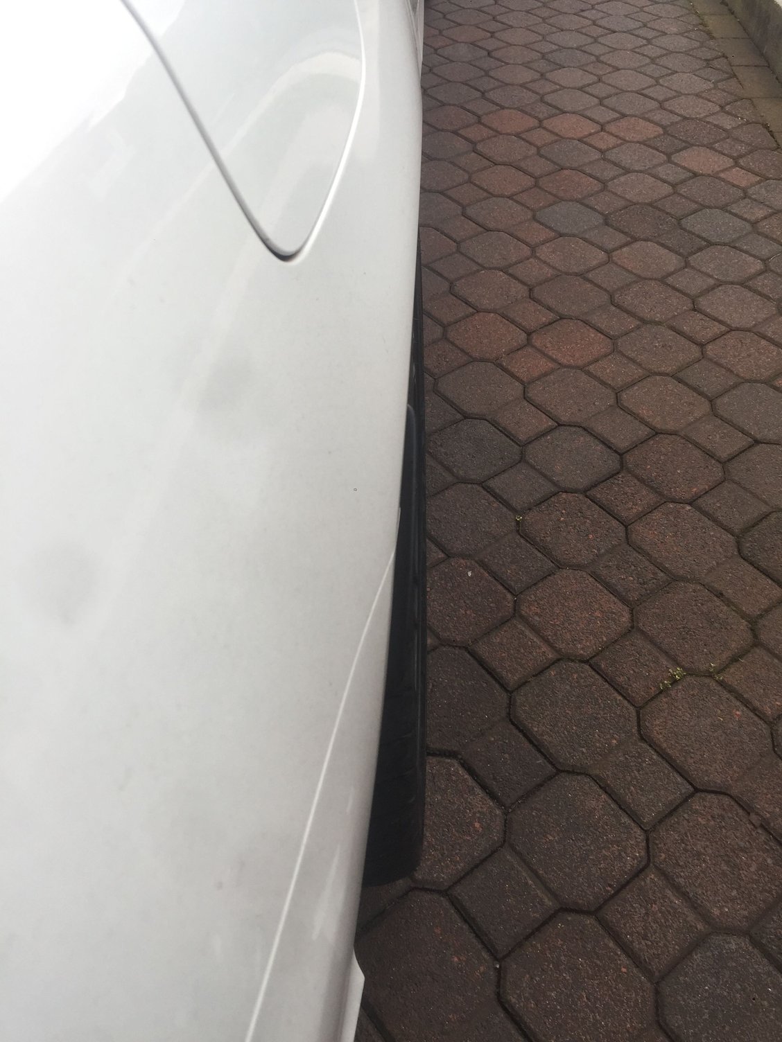

You have any shots of the car at regular angles? Wondering how much tire bulge there with a 295 rear..

Its surprisingly minimal. Couldnt find the thread width of the toyo 295s but it looks not bad at all.

Originally Posted by SBH-
wow 295 on stock wheels ! I think you're the only one around here having 295s on stock wheels ! no issues so far ?
no problem on the sport + suspension mode but got a slight rubbing on the left rear (RHD) when going through a dip at about 90mph in the comfort mode. No rubbing when its in sport+
Old Oct 9, 2016 | 06:59 PM
RDOCA's Avatar
Joined: Jul 2015
Posts: 1,216
Likes: 114
From: SoCal
2016 C63S Sedan
It is not the correct tire/rim combo even though you can get by with it not rubbing.
the rim pulls the tire in too far and tread is not flat.
a 295/30/19 should have a 10.5 in wide rim and no smaller than 10. It is actually 1.1% smaller in diameter so no problem there but you should get a 10.5 inch rim and maybe a off set change.
The fronts should go no larger than a 255/35 19 on the stock 8.5 inch rim as the 265 should have a 9.5 inch rim and no smaller than 9
245/35/19=807 revs per mile--dia=25.8
265/35/19=790--dia=26.3
285/35/19=774--dia=26.9
295/30/19=799--dia=26.0
