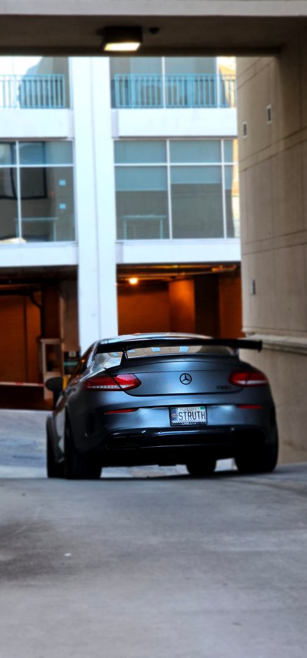

Old Mar 2, 2025 | 09:20 PM
Struth's Avatar
Joined: Nov 2021
Posts: 61
Likes: 26
From: Huntsville, Alabama
AMG C63s
295 /30/20 fronts
315/30/20 rear
Old Mar 3, 2025 | 09:51 AM
RavenM6's Avatar
Joined: Jun 2021
Posts: 528
Likes: 135
From: Houston, TX
2010 BMW E63 M6 Coupe 2023 AMG C63s Coupe 2005 YZF-R1
Originally Posted by Struth
295 /30/20 fronts
315/30/20 rear
That’s a pretty aggressive setup. Can you post some more close up pics? I’m assuming you’re on aftermarket rims? 275F / 305R is pretty much pushing the limits on stock rims.
