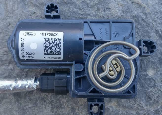

Quote: You'll need new exhaust actuators. I'd bet the spring has snapped on one which would have been the bang you heard.
Either way you'll need actuator motors and Mercedes aren't cheap (huge rip off).
If you're out of warranty get 2 x Audi ones they're a lot cheaper. I've got two Audi ones in my rears on my performance exhaust. The part no. 4H0133246J for the Audi actuator they are all the same oem Kuster brand actuator for a wide range of cars from Volvo, Ford, Audi VW, Mopar, AMG and all work (tested a few of them).
The Ford actuator is the cheapest of the lot. Part no for that one is FR3Z-5K245-A.
Just to update on this piece of advice
My actuators on my 2019 FL C63S failed, spring broke and the actuators were quite weak. I ordered the Audi part as stated above, but when we went to install it, it wouldn't work. So we will have to go with the original mercedes parts in the end.
I don't blame anyone for this, as it was a shot in the dark - but maybe it doesn't work on the facelift cars?
Just posting here in case anyone else is in the same position as me, and tries to use a different branded part as a replacement.

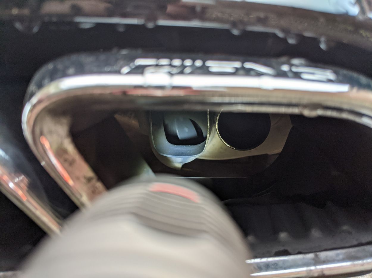

Quote: When you press the exhaust button, do you see both rear valves still open and close? Visually confirmed from outside? Or are they stuck on "closed"?
Open as in this:
My exhaust flap doesn't open as much as yours.
Only about 20-30% when idle. Normaly ?
Show me

Bin them and get cheap Ford actuators

The Audi ones will work for sure I've tested them all 👍
Fix the valves and grease the flaps first as this will enable them to work properly in sync with the middle (H-pipe-) flap which opens and closes depending on the RPM. Once it's all sorted you'll be surprised at how loud it is when all flaps are functioning especially if you have the coupe/cab.

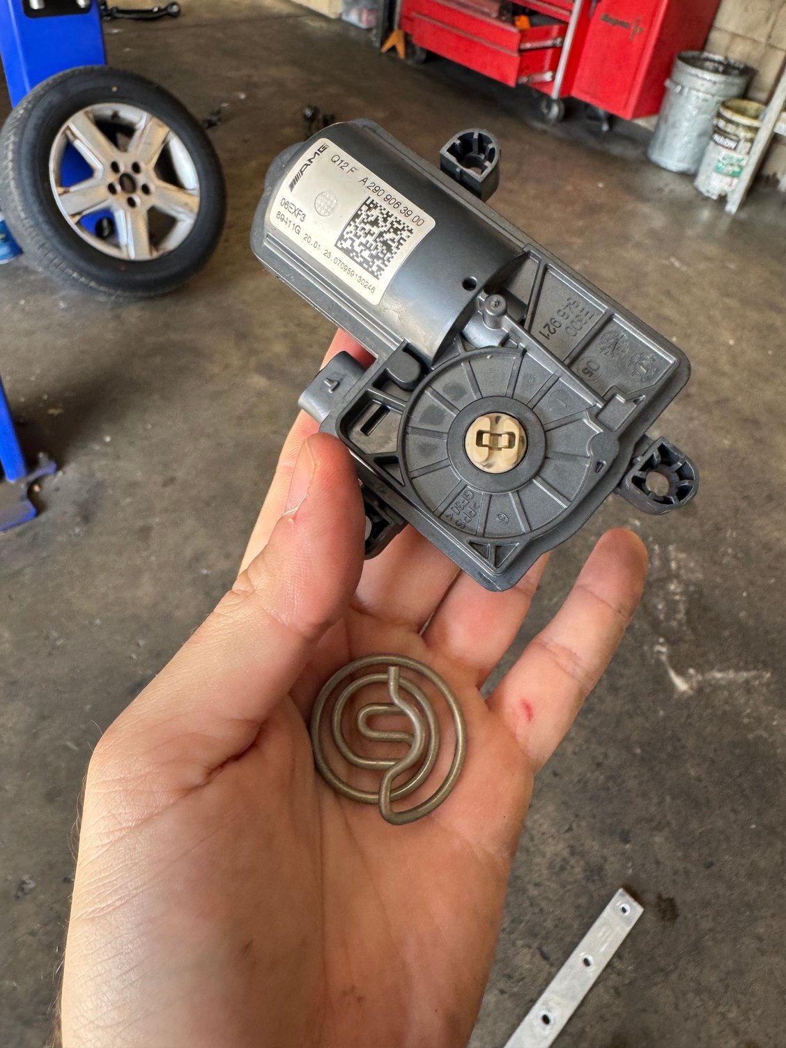

Heat and twist worked
Quote: Ok guys, so I think the solution by tensioning the spring works really well. Atleast it has been working great for me so far. So no rattles at the moment. If it acts up again, I will go to the welding route.
Now for clear instructions this time:
1) Open the 3 bolts of the valve controller and motor and take it off.
2) You can fix these two ways. One is tensioning the spring and the other way is to weld the valve shut permanently.
Tensioning Spring Method:
Method 1: Tensioning Spring
You will see this rotary dial (picture below) which turns the main butterfly valve. Turn the valve all the way clockwise until you hit the hardstop (valve open position). This position is default anyway when you take the valve controller off.
You will now take the spring off the controller and try to turn the top portion of the spindle anticlockwise. This will put more clockwise force on the rotary dial on the butterfly valve eliminating the rattle. The valve controller will be difficult to install once you do this, which is kind of the point. This fix keeps everything stock and gets rid of the rattle. Spray some high temp grease on the motor spindle (where it holds the spring for good measure).
Method 2: Weld Valve Shut
I will pursue this route if the rattle comes back. Take the spring out of the valve controller, so the motor can rotate freely. This way you will get no codes and no need to disconnect the valve controller. If you take the spring out, the motor spinning force will never reach the butterfly valve.
Then turn the butterfly valve rotary dial anticlockwise until you hit a hardstop. This will close the butterfly shut, basically shutting the H pipe off (imagine having no H hipe at all). Then spot weld the rotary dial at the blue mark I painted. You can choose any other location as well but I think the blue spot is the most ideal place. This from my knowledge of welding should be reversible if you ever want to go back to the original setup.
This worked wonders for me...followed the 1st option step by step. No more rattling.
I first went overboard twisting the spring anticlock. Please note a few mm will do. It was hard to align afterwards but got it right at the end.
Thank you so much mate.

Hi All,
I'm happy to share that the rattle is gone now. I initially tried the 2nd method but ended up using the 1st method, which worked like a charm(stretch spring & apply Permatex). I'm not a big fan of the rough idle and drone at certain RPMs that came with the second option. But anyway, glad it solved the issue. Thank you all for sharing!

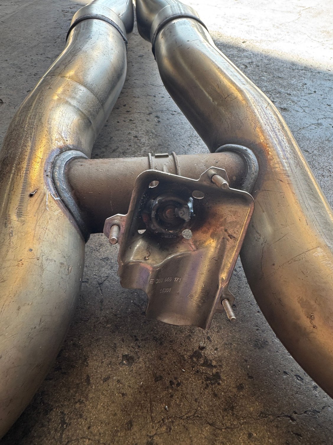

C63s coupe 2024 owner here, I have read every post in this thread looking for a solution.
Been getting that's annoying rattle around 3k RPM since day one and it's the worst thing on this car (that and the brakes squeaking...)
My H Pipe has been replaced 3 times now under warranty and every time they say the rattle is gone but it keeps coming back so I tried copper grease and that didn't work
I decided to take it to a local exhaust shop, remove the actuator and the spring and weld the H Pipe valve shut thinking this would eliminate the rattle. Got in all excited and unfortunately it hasn't fixed the problem.
I don't know what else to do as I figured welding it shut would be the ultimate solution to fixing this since the valve can't move at all. I'm really frustrated and looking for some advice.
Do I need to do this to all 3 exhaust valves or only the H Pipe one?
My next step would be cutting out the H Pipe, welding in a new section with a solid piece closing it off and plugging the actuator in and cable tying it somewhere out of the way to avoid CEL and limp mode. But I can't see how that would work any better than what I've done.
I just would love to enjoy the car and exhaust note without that scrappy rattle, maracas noise all the time.
Please help if you can by sharing your experiences, I've found this thread a great read and would appreciate some more assistance thanks.

Quote: C63s coupe 2024 owner here, I have read every post in this thread looking for a solution.
Oh man. If you've read the thread prior you'll see that welding it closed shut will screw the noise up and causes it to drone. It also will cause the car to have soft limp mode without an exhaust simulator. But simulators don't work on facelift cars.
All you need is one big clump of copper grease as it acts as a cushion to stop the spindle from rattling. The copper grease also doesn't "harden" unlike Mercedes's silver paste they use.
If you want to, increase tension and order a bigger springs from Mopar but from my tests a good amount of copper grease works on it's own you'll just need to apply it once per year.
If you're certain the grease alone doesn't work, get the Mopar springs, add some copper grease and you're 100% set.
Mopar part no. is 68319331AA
Now, ​​​unless the welds can be removed you'll need a new h pipe to restore that signature sound and remove the limp mode. Please don't weld or cut off anything else.​​​
Guys please don't weld anything or close the h-pipe permanently. This is not the solution. I've done it all and it's not the way to go.
I've posted and tested fixes for this over the past 5 years and documented my results so many times on this and even on social media here:
