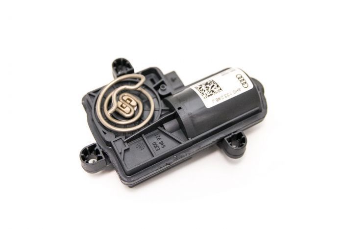

Originally Posted by Jimmy_c63s
You'll need new exhaust actuators. I'd bet the spring has snapped on one which would have been the bang you heard.
Either way you'll need actuator motors and Mercedes aren't cheap (huge rip off).
If you're out of warranty get 2 x Audi ones they're a lot cheaper. I've got two Audi ones in my rears on my performance exhaust. The part no. 4H0133246J for the Audi actuator they are all the same oem Kuster brand actuator for a wide range of cars from Volvo, Ford, Audi VW, Mopar, AMG and all work (tested a few of them).
The Ford actuator is the cheapest of the lot. Part no for that one is FR3Z-5K245-A.

****I'm not Jimmy but in my area the Benz ones are about $250-$300 ish new. Ford ones are the cheapest at about $130-$140 ish each. It's the same actuator but without the AMG and Benz markings
Lol this is literally the exact same part. Amazing, huge value right here.
