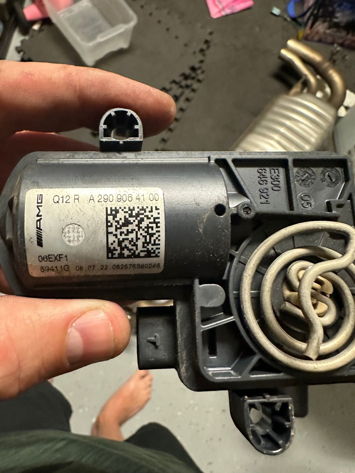

I found replacing the spring to be best fix. Copper Grease did not work for me. You can buy the spring from Dodge for less than $40. Part number 68319331AA

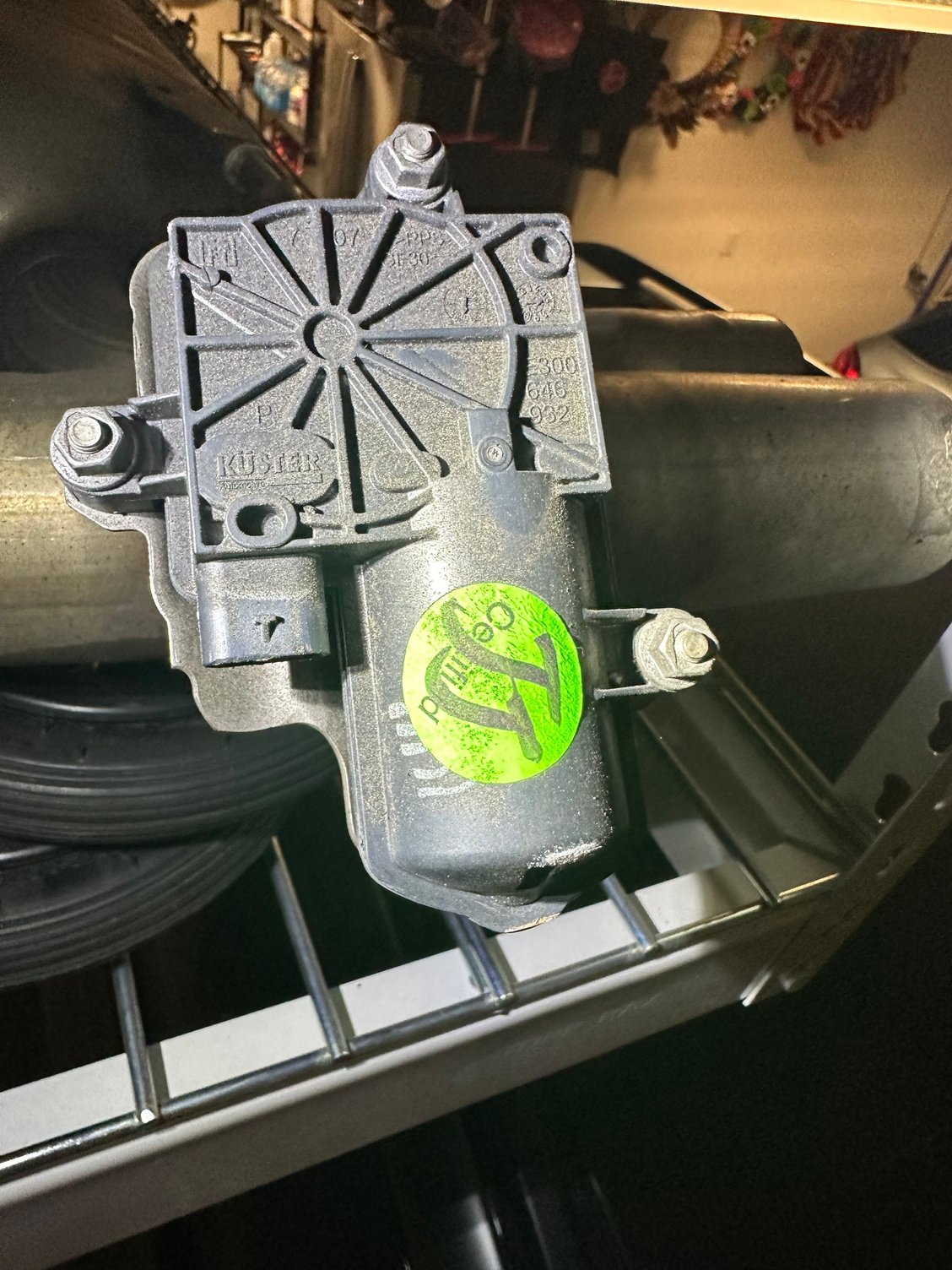

Disconnect the cable to the actuator you want to swap the spring on and then there are three bolts on the actuator that you remove to get to where the spring is:
Then you pull the old spring out and put the new one in its place
Then, reseat on the cradle and connect everything back.
these pics are on the muffler I removed from the car (my rattle was in the h-pipe actuator).
