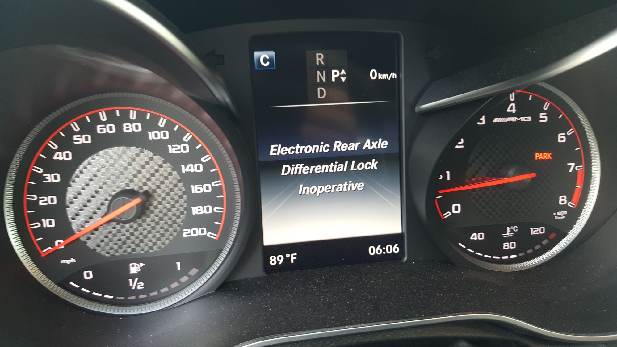

Originally Posted by Modio1234
After service saying I didn't need the rear diff oil change and me getting it in writing 3600 miles on the odometer and my diff failed and it is being replaced under warranty
pics pls.
Old May 11, 2017 | 12:43 PM
  #31
Modio1234's Avatar
Joined: Sep 2016
Posts: 138
Likes: 14
2016 C63S AMG
Originally Posted by kzflags
pics pls.
Only pic I have still at the dealer. They are saying that it was because of a manufacturing defect causing one of the pins inside the diff to strip and cause the diff to fail.
Old May 11, 2017 | 01:11 PM
  #32
skim7x's Avatar
Joined: Jan 2017
Posts: 1,117
Likes: 182
Mercedes-Benz E63s AMG
Ouch... glad it got taken care of
Old May 11, 2017 | 05:45 PM
  #33
ItalianJoe1's Avatar
Joined: May 2015
Posts: 4,037
Likes: 1,012
From: Miami, FL
2003 CL 600
^^ that's most likely unrelated to fluid then.
Just a new part failure, it happens to the best of them. Just ask the AMG GT owners that have needed new transmissions on cars with less than 500 miles. We've done several.

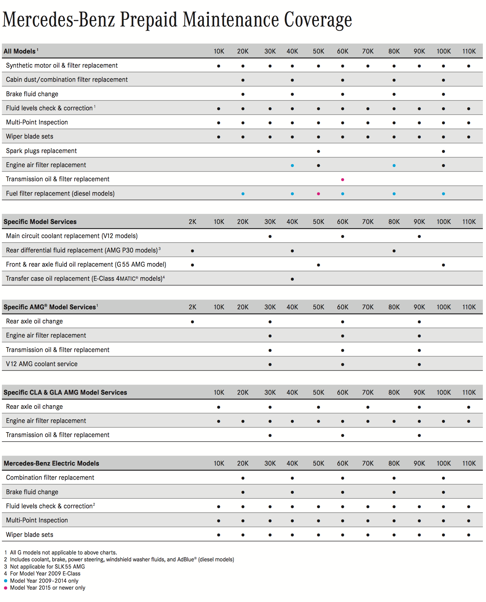

Is this covered in the US? I couldn't get a straight answer when I asked the MB Annapolis dealership. Meaning I got two different answers from different sales reps.
Old May 12, 2017 | 12:44 PM
  #36
AlexZTuned's Avatar
Joined: Dec 2012
Posts: 1,537
Likes: 372
From: Austin, TX
2017 Porsche 911 C4
It's covered under the pre-paid maintenance plan. I'm getting mine done next week.
