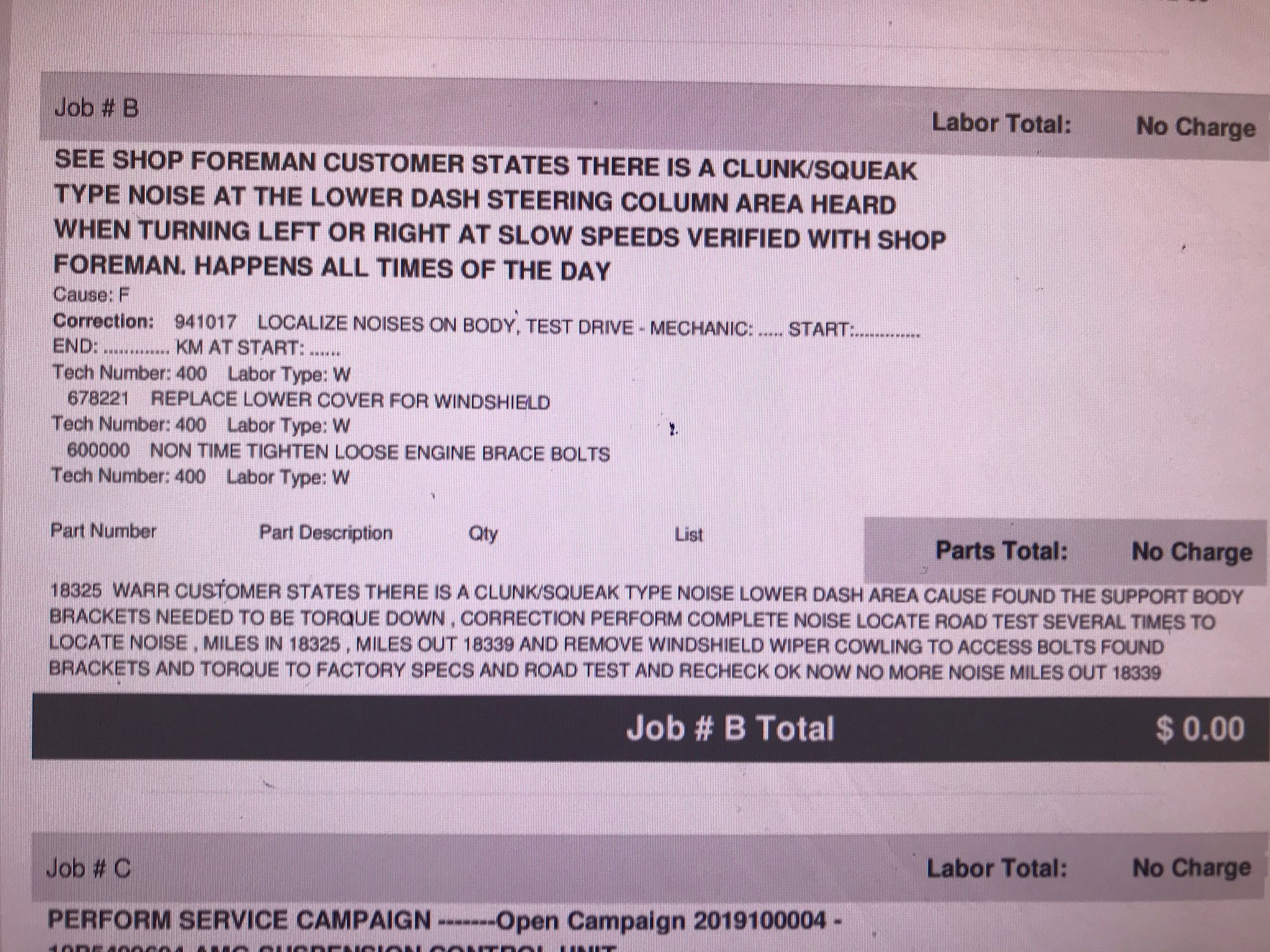

Brought my car in for service B today. I also reported this same issue. The foreman went on a test drive with me and heard the noises. He seem to know exactly what the issues is. He said that it a common problem on this car. Will give an update when I pick up the car in a few day.

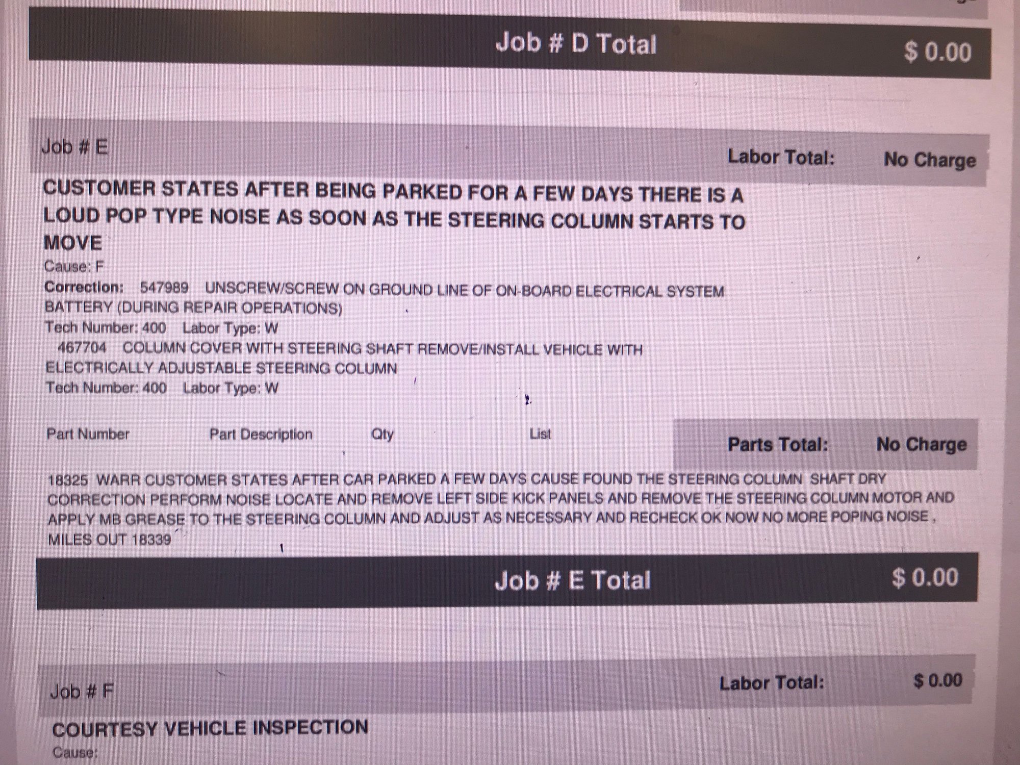

Dec 11, 2019 | 10:11 PM
The dealer is trying to get a little more money out of me. 😃 Got a called from the dealer today. They said all the noises is fixed and services is done and recommend rear brake pads replace for $731 !!! What ... just for pads only !!
I told them then why my brake lining sensors is on yet? He waited 10 second before saying, the pads is still good and we only recommending since the car is in the shop. Seriously, this can be done for less then $300 DIY.

Got the car back today. Not a single noise.
