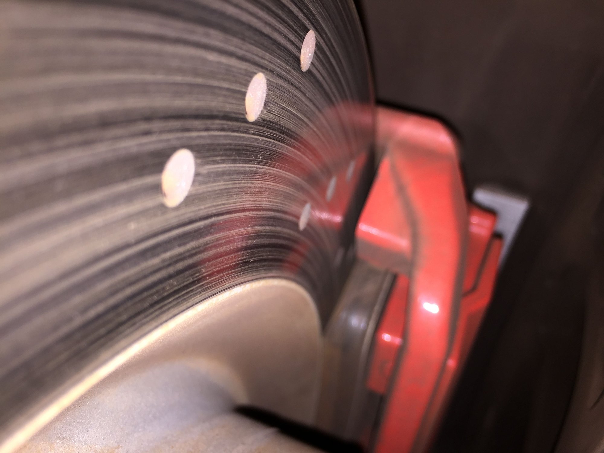

FRONT DRIVER SIDE
REAR DRIVER SIDE

Based on that photo I would replace your rear pads immediately. If they get to 0% and start rubbing metal on metal you risk scoring your rotors and destroying the low pad sensor. I would also change the fronts, not because they need it but because you can get porterfield or hawk pads that will make a lot less brake dust than the OEM pads. If you don't want to change the fronts though it looks like you have quite a bit of life left on them. There are wear sensors on the passenger side pads, they can be taken off and put on to the new pads.
Determining if the rotors are still good is a bit tricky and the thickness should probably be measured. At 14,000 miles, even with some hard driving, I would say you should be ok. Try running your fingernail along each rotor and see if it feels smooth or rough, if there are any rough spots or scratches or anything that looks warped you'll need new ones.
If you're slightly mechanically inclined the pads are easy to change yourself. I changed all 4 of my pads for about $220 in about an hour. If not, buy the pads online from Porterfield and take it to an indie shop.
Carbahn (formally steve dinan auto tech) quoted me $880 for rotors + pads on rear with install. Good deal?
