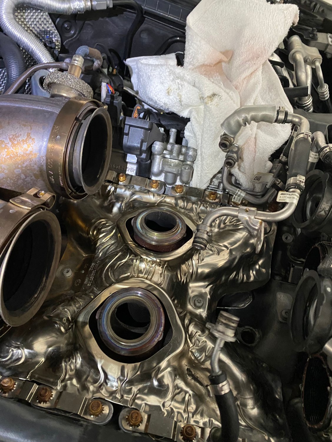

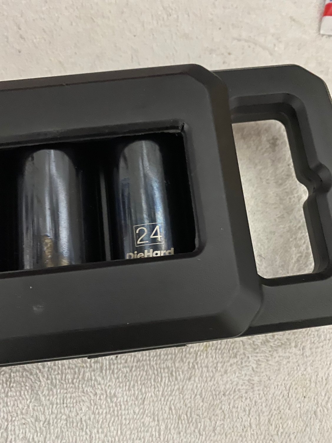

*****Yea. I replaced the turbos on my car (2018 C63s) this week, broke it all in and thermal cycled the turbos to seat the bases as well as insure no leaks or anything horridly bad going wrong on the install. I used a turbo break in pre-lube to help break them in and the stuff is black as night and is great for breaking in a new turbo versus dry starting them, but it tends to clog the oil filter up a bit, so I changed the oil after everything checked out ok and after I made sure I didn't install the turbos backwards, or worse put the old turbos back on or something... (<----that's a joke, but that would SUCK if it happened..)
Anyway, I changed the oil and filter and have all the socket sizes, and mine took a 24 mm *perfectly* with NO floppiness, etc.. The 26 wouldn't even engage the nut on the canister as it was just too big. Just for giggles and because that plastic oil filter canister cover seems *really* kind of flimsy to me I ordered another one and it should be in next week. My original works, but I'm just paranoid the thing will just break one day while trying to remove it. Best to have a spare... like a girlfriend, wife, etc... in case they break.. Always good to have spares I always say!!!
Pics below. The car with the new turbos goes to the dyno tuner on Monday for them to do their magic as that is equipment I don't have, and I'd rather the car with the new setup get tuned on a dyno versus just a guesstimate with an off shelf tune from someone who has never seen my car, and may or may not really be able to optimize the setup or maximize it as there are individual difference in motors and other stuff on the same model car. It's not cheap but I can always make more money, or get a sugar momma, sell an organ, become a **** star or whatever to make extra $$$.

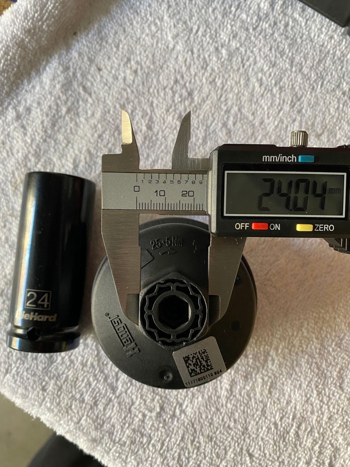

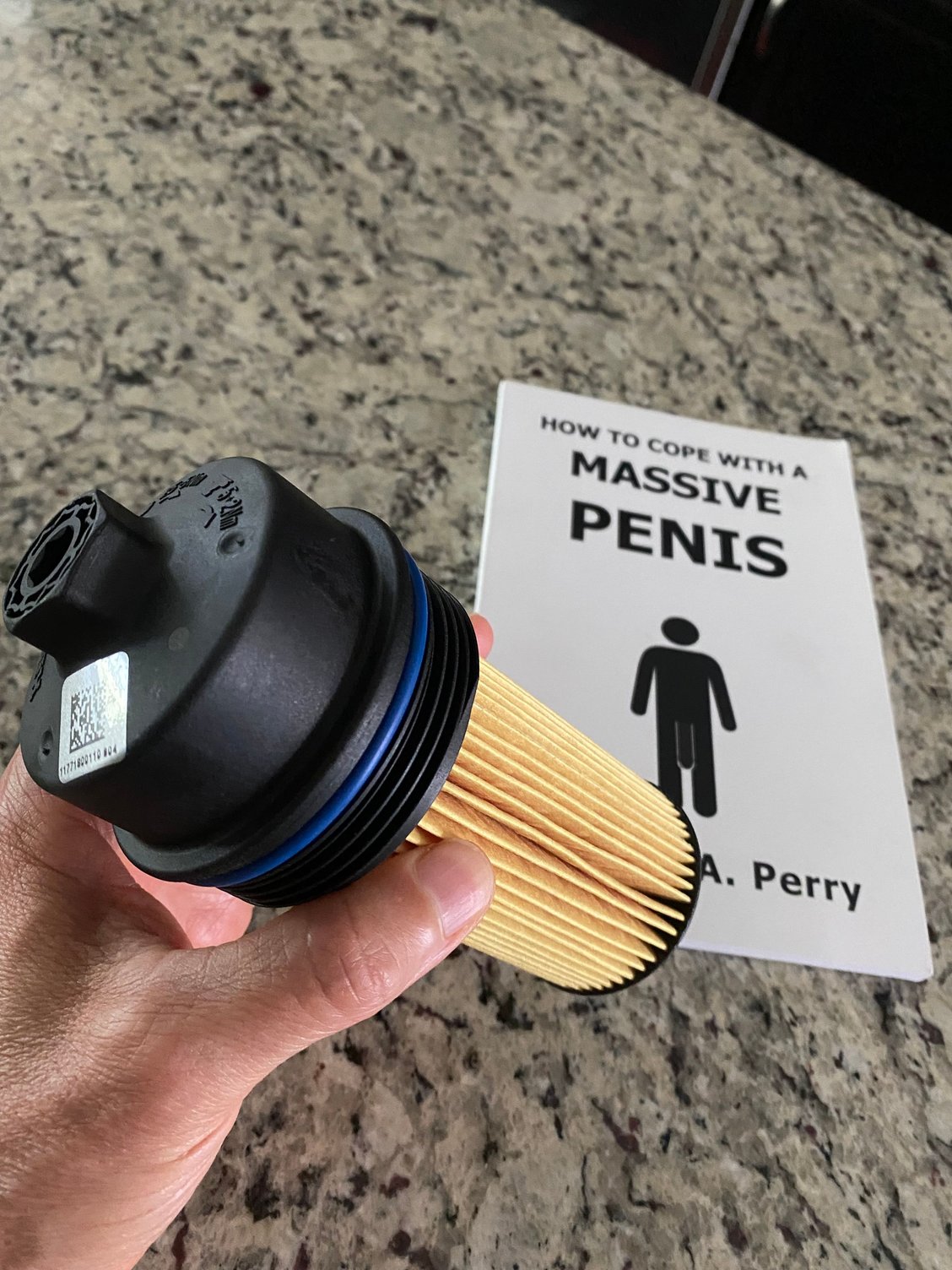

****I got my spare replacement oil canister cap and took a pic with a measurement. I could not believe how inexpensive it was (for a Benz part! haha!), like $50 on sale or so. It came with a new filter and O-ring as well. The original seemed kinda flimsy so I bought a new one to put on my next oil change as the original has someone who clearly used the wrong socket head on it as the edges were kinda damaged and rounded. It would suck to have the thing break with the old filter in it, all the oil out of the crank case and only a bicycle or roller skates to get to the dealership!
Anyway, cap and measurement below. Definitely 24mm !
You're the real deal man. You have no idea how much your post will help others in years to come (seriously).
New cap looks good haha glad you got it on sale.

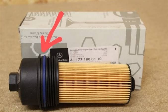

Max you wouldn't happen to know if that oil filter housing cap you replaced is part number A1771800110? Thanks bud.
****Yep. That's the one! Came with the blue O-ring. Part number is the same! I'm the second owner of my car and the original cap worked, but someone must have used vice grips on the removal nut as it was all chewed up! I bought two spares and replaced the one on my car and saved the other one for a friend who has the same car with the same chewed up nut!!! Clearly some mechanics aren't using the right tool to remove these caps! The thing is flippin' plastic! What a disaster to crack that thing while using vice grips or whatever and not having a spare! Bad day for sure!!!
