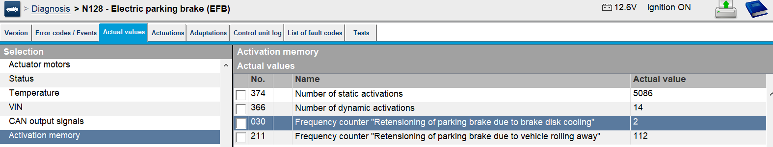

Old Jun 17, 2018 | 11:24 PM
srO_Michael_Orz's Avatar
Joined: Apr 2017
Posts: 109
Likes: 30
From: Toronto
C63s(lost)/E250/GTR(Sold)/GTS(Carbonerre)
You do not need worry about this, because parking brake will release by itself if it detect (calculated) the temp. is higher enough.
ignore its retensioning ( Due to error text translate or convert)
