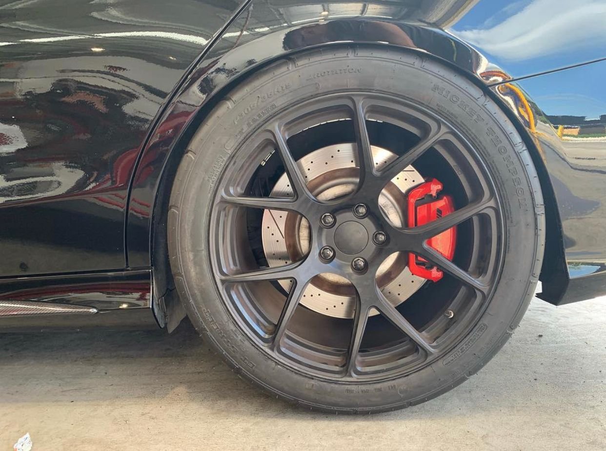

So finally got my new BC Forged. Loving them! They fit perfectly with no rubbing what so ever!
Running 295/30/19 in the rear and 265/35/19 in the front.

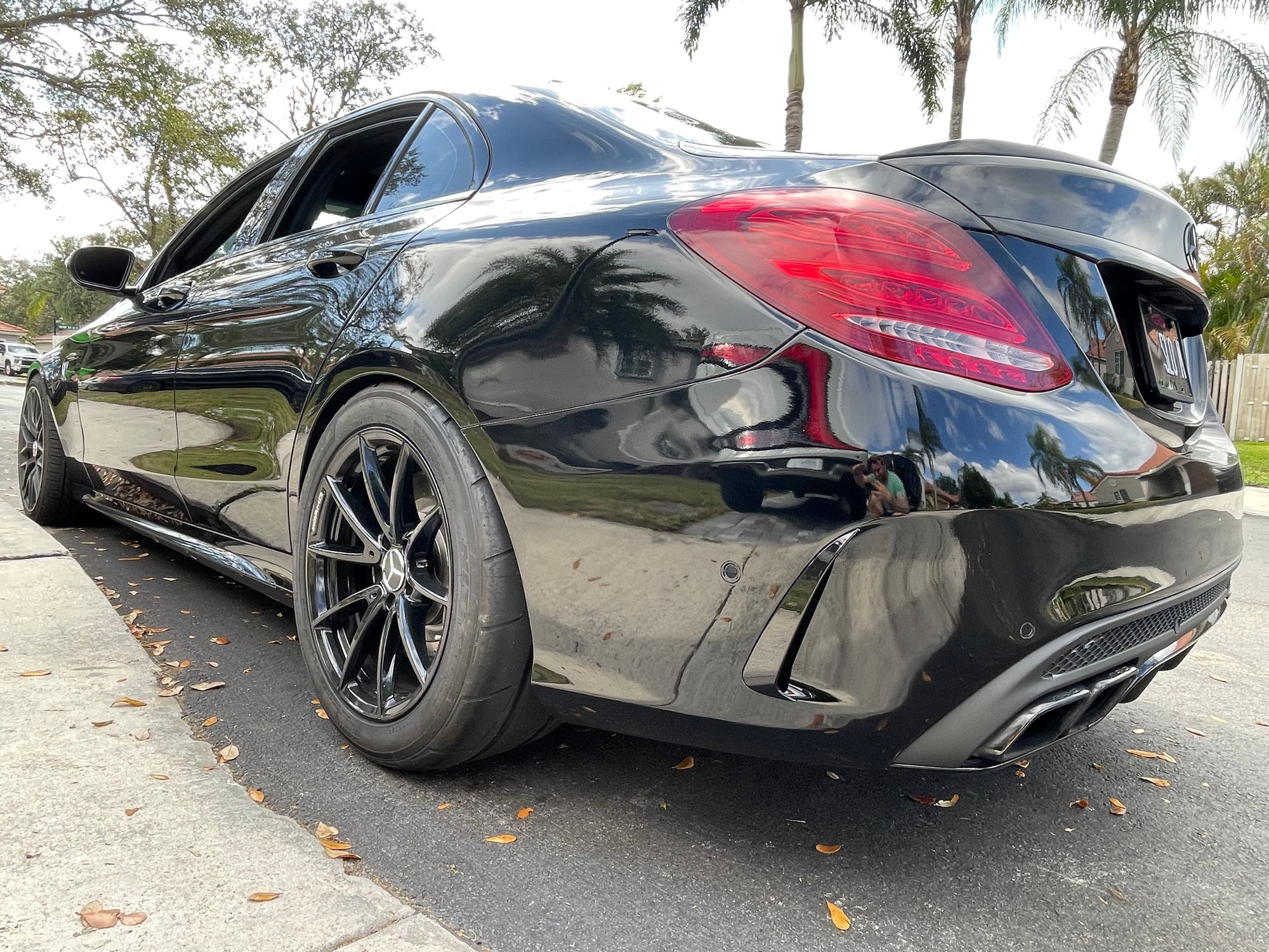

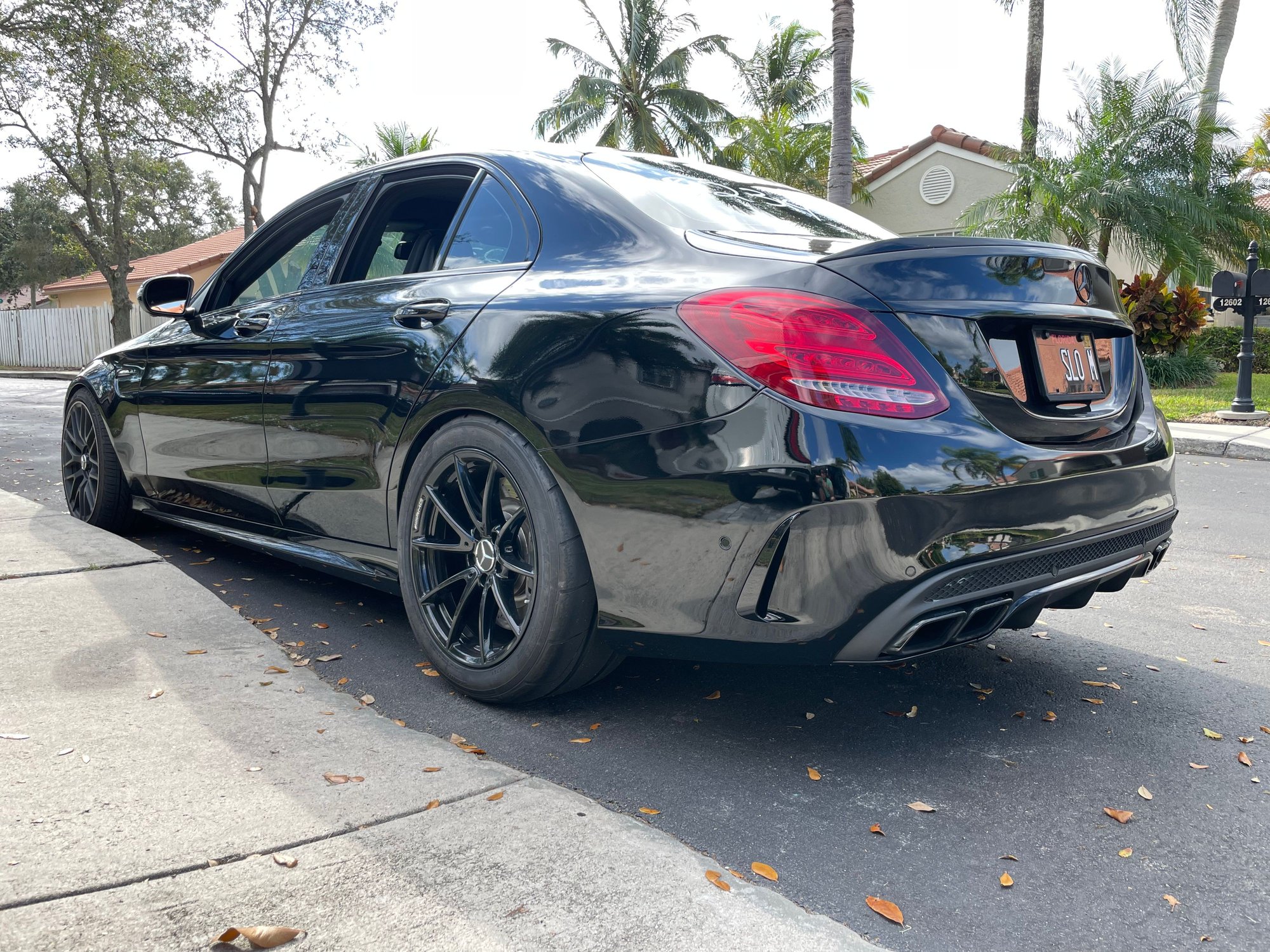

11" wide rear wheel setup; +55ET
305 (12.3") sidewall will come 1/10" past the white plastic guard
