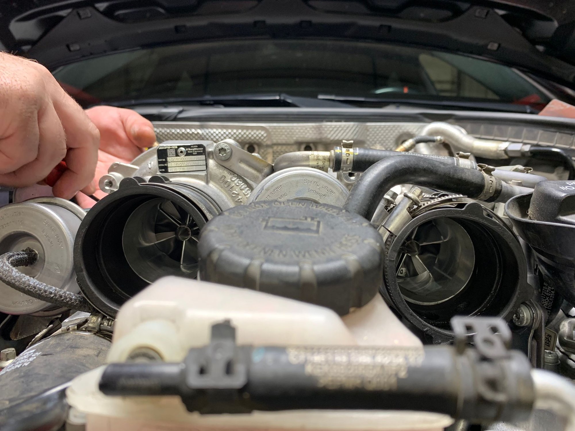

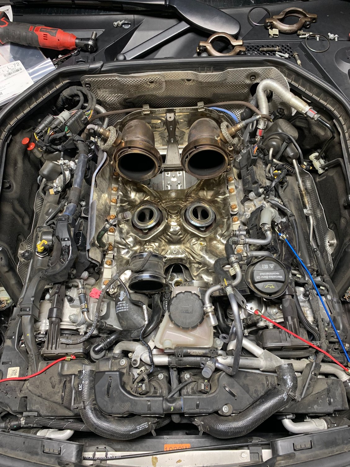

With the extra 4500 in my pocket from the BBS refund that I already considered spent, I decided to use the money for bigger and greater things; a set of Pure 900 turbos....😈 Not seeing much info about them here and not knowing anyone who has a set, I kinda just jumped in not knowing what to expect, the pure website is kind of cryptic and unclear. They claim they are good for 900+ whp but the trans is not. They claim their test car made 750+ whp on 22psi and race gas, I guess we'll see.
I dynod the car as it was on stock turbos, catless downpipes, and the eurocharged tune; the car made (on an apparently low reading dyno) 518whp/550wtq. Powerband was great until 5k or so RPM, as many of you are aware... Past 5k it falls off hard and runs out of breath.

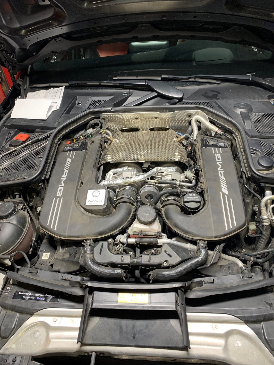

The pure turbos came in the day before Thanksgiving, so I had to wait it out a bit before I could get them installed. Last week I pulled the stocks and installed the pures, what a huge huge difference, the car is an animal as is with the same tune as I had on my stock turbos. On my 295 rear tires, im spinning till around 70-75mph. First and second gear are absolutely useless under WOT with or without traction control on, launch mode still doesn't get the car out of the hole very impressively but it's just the nature of the platform I guess. I asked eurocharged how much boost they set me at on my stock turbos but didn't get a reply, I'm assuming it's 18psi. *** dyno tells me it makes 600ish as it is and pulls hard to 7k rpm.
My options for tuning is let eurocharge retune me and they'll set me at about 22psi (700+ whp is what pure claims it will make here) OR wait for BMS to release jb4 and use that instead. With the on the fly map switching, logging capabilities, and boost by gear; I'm definitely going to go with jb4. Especially as I want to start playing with e85 blends I see it as the best option for us.

I appreciate the offer but im going to be waiting on BMS for their intakes and eliminate the air boxes completely. Its a shame how limiting these air boxes are on the car, if it didn't taper down so much I'd probably keep them.

great build,what's the size of the pure 900 turbo hot side impellers.
do you have pictures of the hot side also.
Hot side appears to be stock size. I meant to take pics of them side by side to show the difference in the wheel but the ADHD little kid inside of me put them on right away lol
