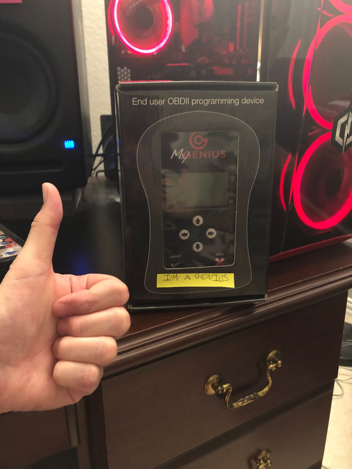

I GOT My Tune!! Jerry sent it to me via e-mail, 1 file at a time via 1 e-mail to ensure I got them all as they were large. Case (The Great) at EC tried to send, but I never received them as they were too large and apparently didn't go through
I have now successfully loaded ALL my Tunes onto MyGenius and everything worked perfectly this time I just went down to my C63 and Loaded my STAGE 2 Tune with no problems whatsoever. No battery charger too, I like to live on the edge. Started my baby up afterward and no codes as I expected and I’m ready to roll.
I had been running Stage 1 initially, and I was really happy with that. I’m almost scared to go check out Stage 2 I was excited and jumped in, and realized my lovely wife blocked me in so now I have to move her car, so I can take her out for the maiden voyage to make sure everything is acting right.
Update1: Drove for 30 minutes and the car drove great! In S+ the POPS when lifting off the Gas and downshifting was so loud, but I’m also running AWE Track (straight pipes). It sounded like a back-fire.
Update2: I think I decided for NOW to put the Stage 1 back on the car and run that for a while and enjoy it. I really liked Stage 1 and it was FAST, drove really Smooth, and Felt Safe. I don’t want to push the car too much at first and want to also have a More Aggressive Tune that I can look forward to when I decide I want MORE.
Update3: The 1 am Stage-1 Tune Swap is complete, I've become a PRO at loading tunes. I leave for a fam. trip Sunday for a week but am eager to do some Dragy Runs so I can get some actual real-world numbers as that would make me feel much better Knowing things are actually running faster. I guess even if it didn't run faster ET-Wise, I'd keep the tune on as it FEELS so much stronger Interested in performance differences that exist between Stock, Stage 1, Stage 2?

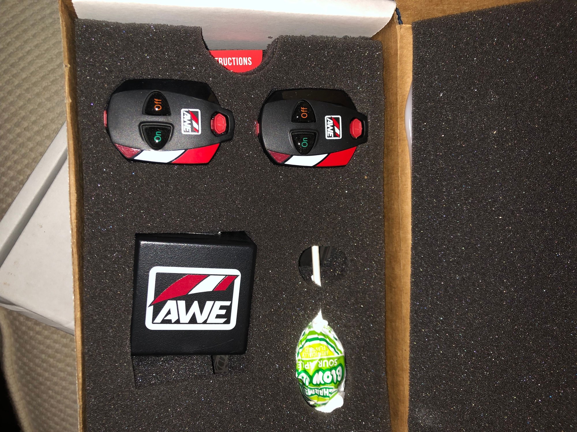

Hey Y’all I’m out of town I’m Punta Cana(1st time) with family and back the 5th.
I WAS able to install my new AWE SwitchPath Conversion Kit to transform my Track Exhaust into the Electronically Controlled Valved Version.
I got sent sent the wrong wire harness (for a car with a PE, mine Stock was a NON PE), so I have to wait before I can Use it the way it’s intended.
Sounds Great though and with it installed NOW and the valves not working yet, they stay Open All the Time so it’s basically like what I already had.

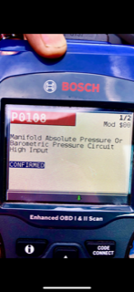

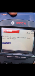

August 1st Loaded Stage 2 Tune, went for a drive and it was even faster. Drove it a week and then when I came to a complete stop on a weekend having fun, I floored it and went up to 90mph, and then all of a sudden had a CE, made me nervous, but nothing drove different. Went to an Auto Parts Store to Determine Codes, found 2 that it threw. Here are the 2 Codes for CEL:
P2A0D
P0108
They went away after he checked them. I said thanks for clearing them, and he said I didn't clear them, they disappeared? Anyway, the codes were GONE and I drove home and put Stage 1 back on and checked in with Jerry at EC. He responded quickly and said it was a code that it lost communication and to put Stage 2 back on and see if anything happened again?
Put on Stage 2 the next day after I got the codes. It's been several weeks and Never had another Issue, no CEL's, and the Car drives Great. Haven't done ANY Dragy Runs yet, but plan to soon if anyone cares.
P2A0D
P0108
The intercooler pressure sensor(s) have gone bad. It'll happen when the engine/trans temps get hot and you push the car hard multiple times. Had the same codes, and changing the sensors fixed it. Just be prepared because replacing the sensors requires quite a bit of labor in order to access their location.
Thanks MSD as I wasn't aware this could be an issue. However, I'm not 100% sure my intercooler pressure sensor(s) have gone bad? I never had any codes come back ON since that 1 time. I have NOT done an ALL OUT WOT Run where I am really pushing it hard from a dead stop, which is what made the CEL go on the 1st time. If I get ANY Code again, then I am going to be concerned, but if it stays off, and has no other noticeable issues with the way it drives then I think I am OK.
I have 2 years remaining on my Mercedes Factory Warranty. IF it was the Intercooler Pressure Sensor, or "Manifold Absolute Pressure Sensor". I would likley bring the car to the dealer to get it replaced UNLESS that would Cause an Issue? I'm SURE the Boost is turned UP with my Tune and All Tunes, so maybe that Increased BOOST Pressure Triggered the Voltage to Exceed 5 Volte, the Top End of the Range, therefore, triggered the CEL. Again, I will Monitor and see if it comes back.
The 2 Codes I Got was from an Oriley's Auto Parts Store Generic Scanner and I snapped a picture Below of the 2 Codes.
1. Mercedes Code P0108: Manifold Absolute Pressure/Barometric Pressure Circuit High Input.

A fuel-injected engine may alternately use a Mass Air Flow (MAF) sensor to detect the intake airflow.
2. Mercedes P2AOD: Manifold Absolute Pressure Sensor 2 Circuit High
This description below for P2AOD was listed for a Dodge Automobile, as I didn't find a Mercedes Specific Code. I think the code gets triggered for the same issue on any car.
-The Bank 1 MAP Sensor input voltage is above the maximum acceptable threshold.
Cause:
  • 5-Volt Supply Circuit Shorted To Voltage
  • Bank 2 Map Sensor Signal Circuit Shorted To Voltage
  • Bank 2 Map Sensor Signal Circuit Shorted To The 5-Volt Supply Circuit
  • Bank 2 Map Sensor Signal Circuit Open Or High Resistance
  • Sensor Ground Circuit Open Or High Resistance
  • Bank 2 Map Sensor

Not sure if I mentioned, but this code has NEVER Came Back! I have done a few Draggy runs, BUT not in ideal conditions, ie. not a long enough straight away! I didn't try many times, but the 0-60's I did had a best of 4.27.1/8 mile I only did 8.01 at 97.12 MPH. Again, needed more time to attempt. I did it in morning and cars kept coming.
I will try more
