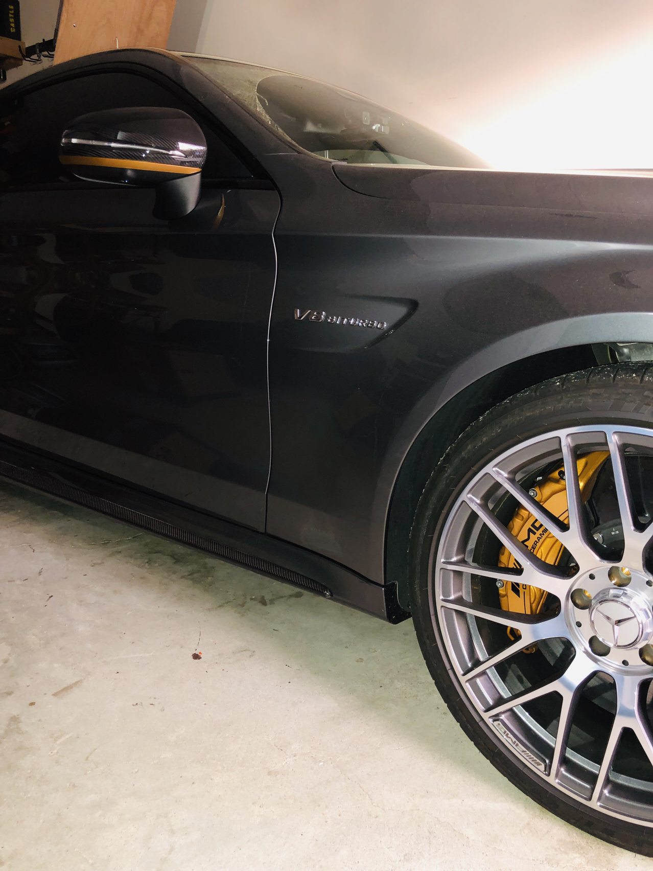

Yes, been on my car since day one. 8200 miles later I wouldn't hesitate to buy the rear carbon ceramic brakes and install those as well. I like them that much. Possibly for the no brake dust alone I would do it.
