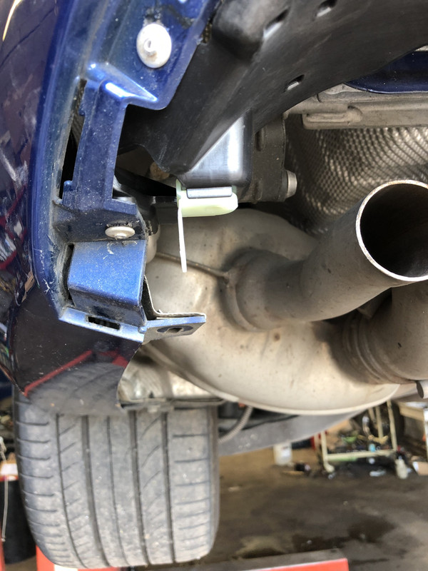

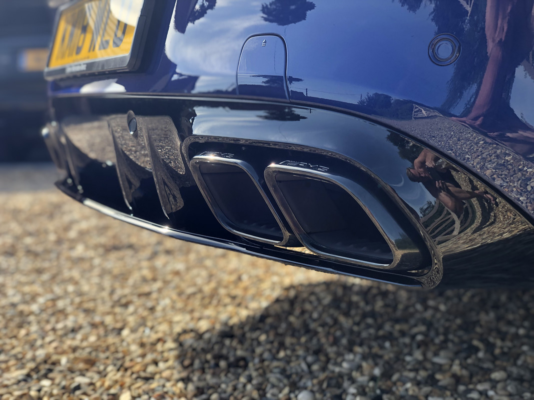

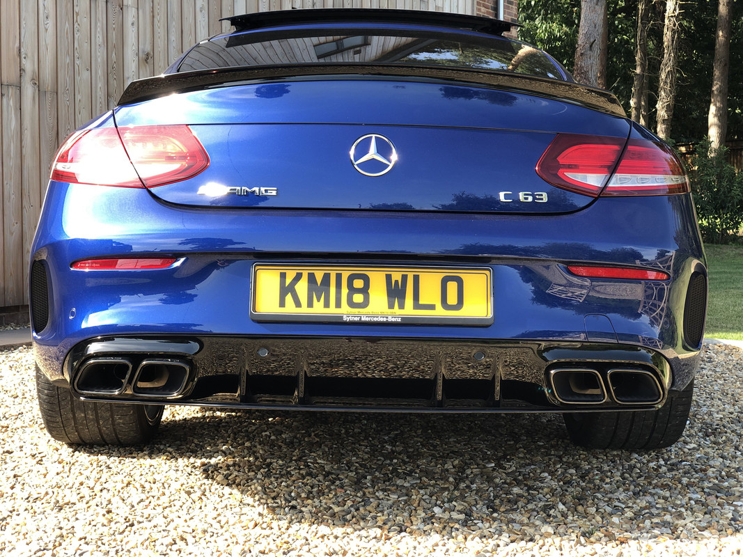

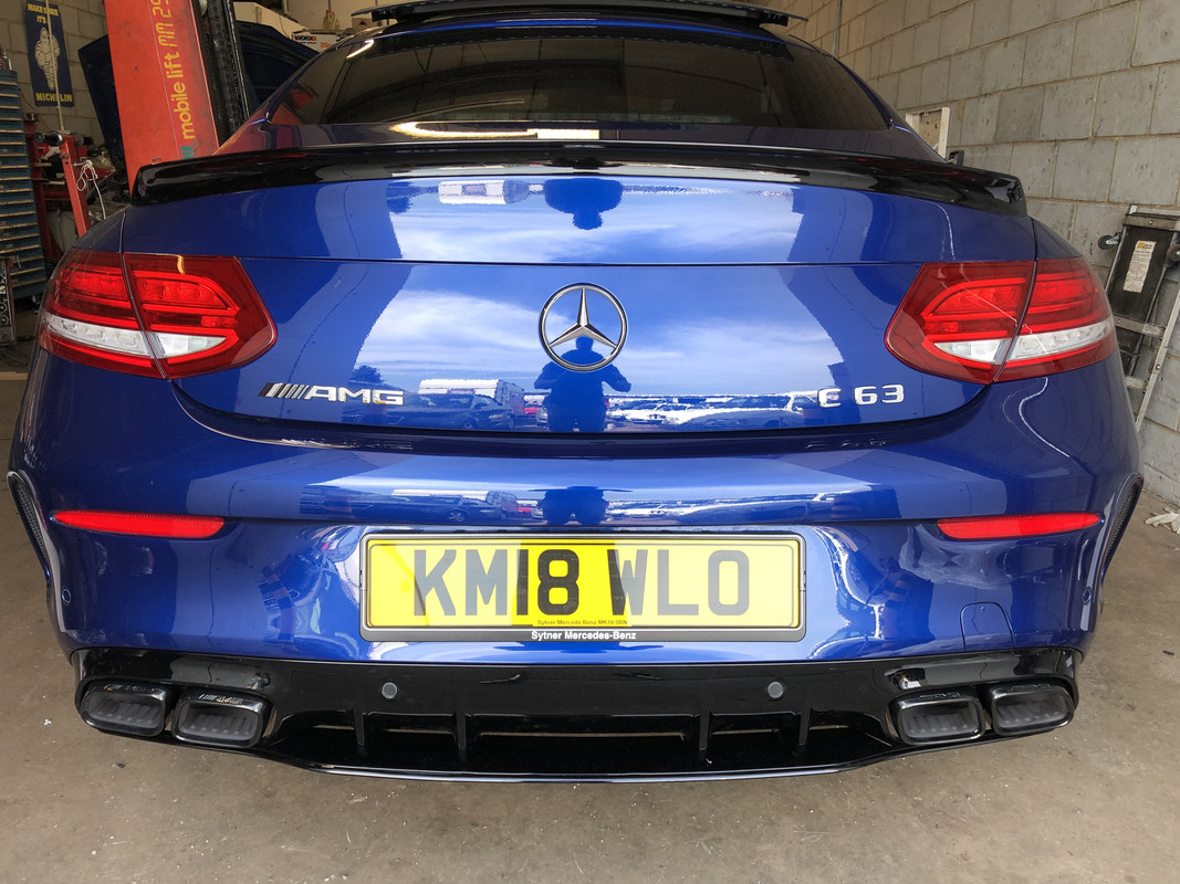

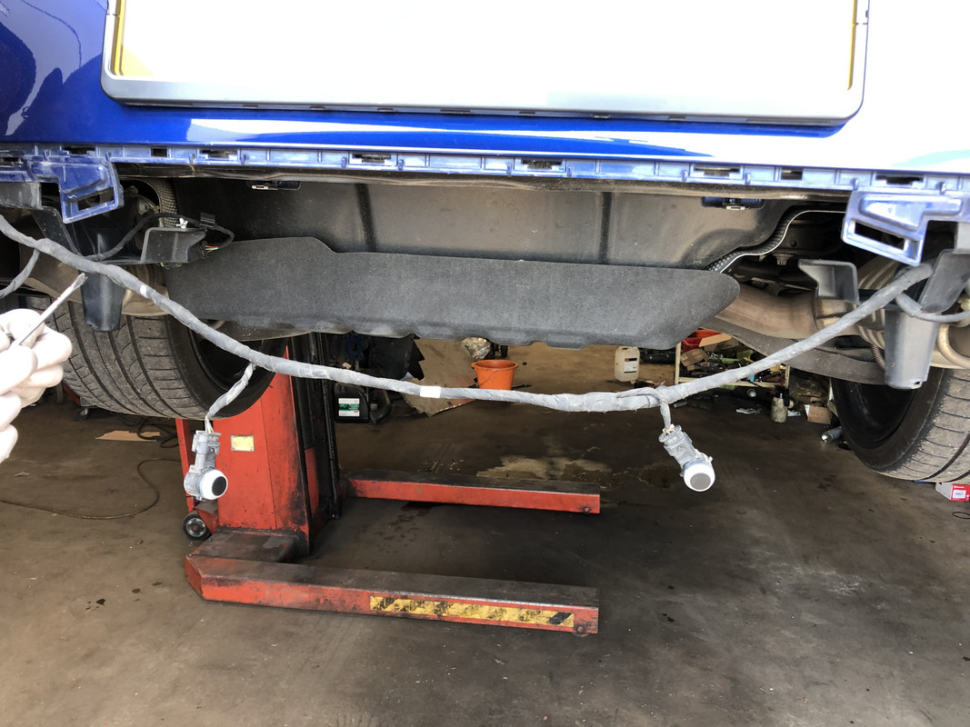

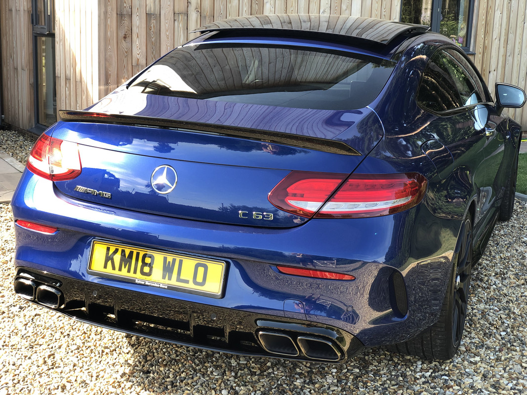

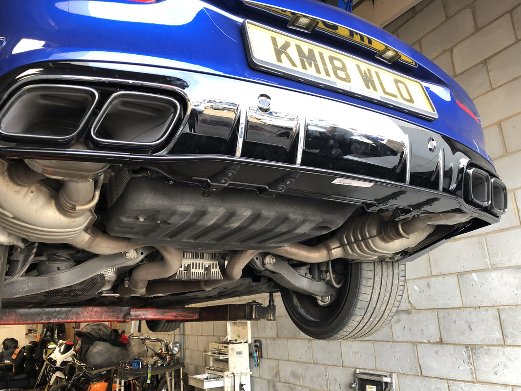

So, I’ve recently posted a few times on swopping out a 2018 rear diffuser to the facelift rear diffuser and bigger tailpipes. I had reservations as had an edition 1 lower spoiler ready to go but got to say I’m really pleased I went with the 2019 rear as the bigger tailpipes looks great!
I’ve already done the front grills, front spoiler, side skirts and rear spoiler and love the change.
Today I got my garage to do the rear swop. I help where I can. Said it would take an hour tops so they would squeeze me in. Hmm, could of been a bit optimistic!
Exhausts off easily, 4 bolts. Various pot rivets need drilling out and a couple of bolts. Some un clipping and eventually the rear diffuser comes off. Then more pot rivets to remove the brackets that hold the exhaust tips on. Need to unplug 2 rear sensors and boot opener.
Then first problem became apparent. Inside the diffuser is a plastic part and this contains the boot opener / gesture sensors. These didn’t line up with new diffuser. Not sure if the 19 has a different part, but after a bit of modding and a couple of pot rivets we got the part fitted, but not a simple swop and one to be aware of if you have gesture boot opening.
Tailpipes on. Two little tabs on each slide in and replace 2 screws per side.
Inner exhaust mounting bracket on both sides needed these drilling out and replacing.
went to refit and another problem. 2 small clips either side left and right, need cutting off as no slots on 18 bumper. No biggy, just cut them off. The diffuser had 2 screws provided so used these, 1 per side on the outer edges of the diffuser to secure.
Lastly, rear tray clips in on the sides and then add screws on the bottom to secure and finally push fit the last trim bit on that covers up the clips from the tray.
Anyway, wouldn't say this was a simple swop but all done. If you have gesture rear boot either buy the 2019 part of be prepared to modify. Overall took 2 hours with a ramp and 2 people ( well one mechanic, and me so maybe 1.5 people!) and very happy with results.

Looks great !!!! Where did you order the diffusers and tips from ?

Nice, but I'm biased Is that an edition 1 spoiler and splitter? Where did you get it from and are they OEM?
Bought all direct from MB. All Oem. If in uk and need contact pm me but he won’t send abroad, sorry.
Rear spoiler is edition 1. I got this Oem piece that I believe to be the same as facelift c63s but could be wrong from cks performance for £290:ish. It’s the only item I’ve eve bought fro them as normally they over inflate MB prices and sell on. In this case I got lucky. They are now listing it for £600 so I’d check with MB what they are selling it for as bet it’s cheaper.
Rear diffuser is c63s facelift standard diffuser, also from merc. I can pm you my parts guy details if needed. Thought you had 19 so don’t you have this already?
Sorry, mis read. Front splitter also from merc, Ed 1 but again think the same pics as facelift?! From merc Oem, Circa £400 for front splitter iirc.

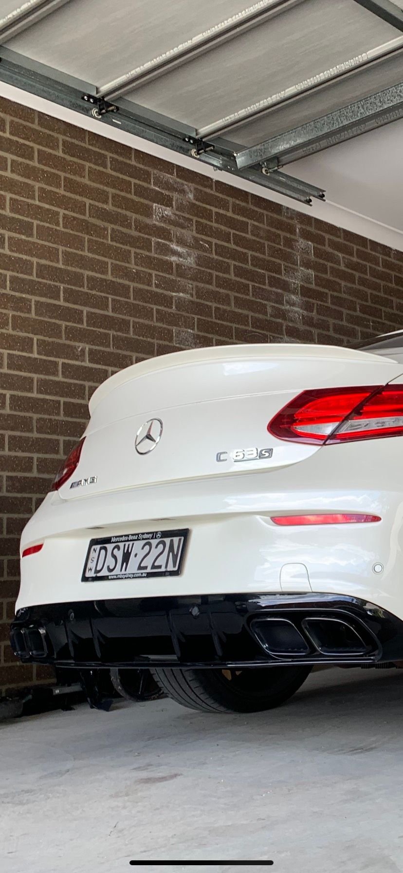

Just a quick note to say thanks. Super helpful write up, helped heaps when doing mine.
By chance, can anyone confirm which bootlid spoiler I have on this? I'd like it in gloss black now too but would prefer to buy a replacement than paint over this. Can't seem to find one that looks the same.
